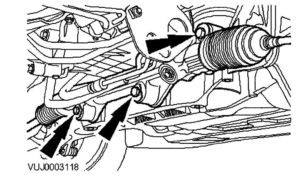

2. Detach and reposition the steering gear.

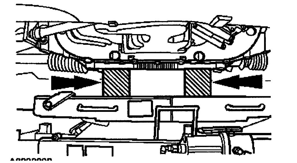

3. Raise and support the front end of the vehicle on the No. 2 crossmember.
imageZoom/Print
^ Position two 4 in. x 4 in. pieces of wood between the No. 2 crossmember and the lifting device.

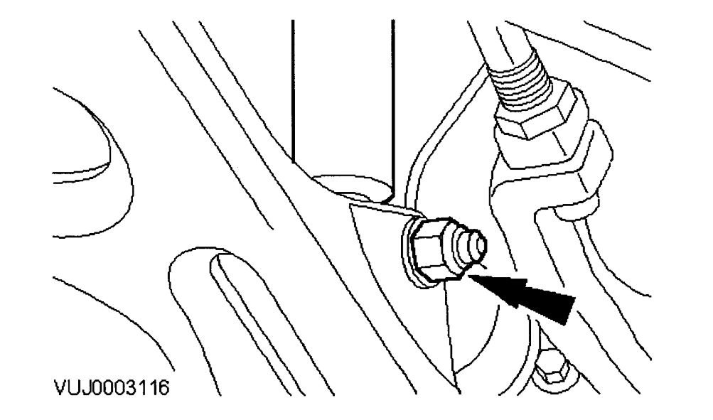

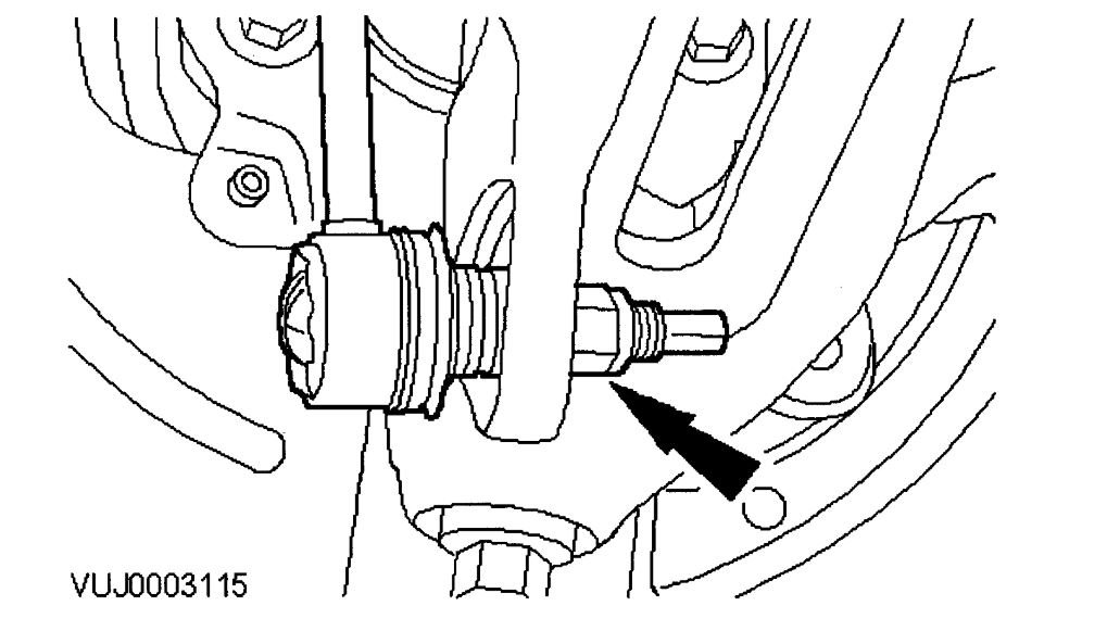

5. CAUTION: Prevent the stabilizer bar ball joint ball pin hexagon from rotating. Failure to do so may result in damage to the stabilizer bar ball joint boot.
Detach the stabilizer bar connecting link.

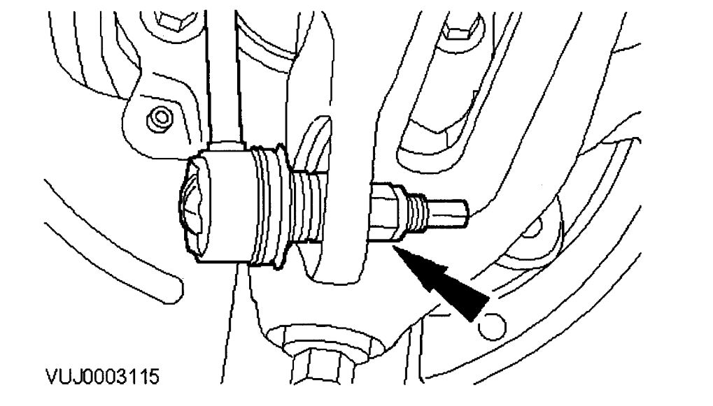

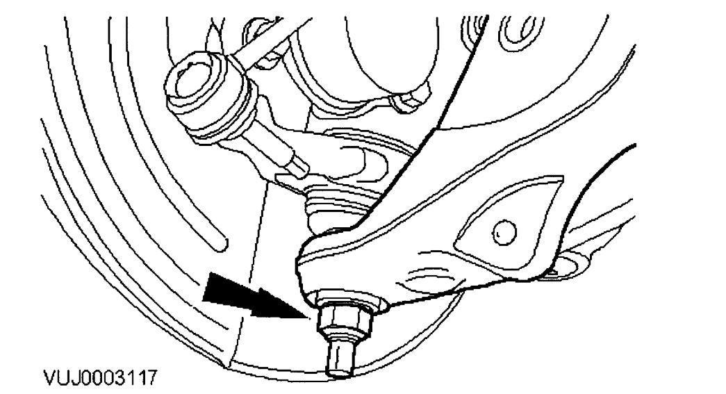

7. Caution: Prevent the lower ball joint ball pin hexagon from rotating. Failure to do so may result in damage to the lower ball joint boot.
Detach the lower arm.
Vehicles without camber and caster adjustment cam bolts
imageZoom/Print

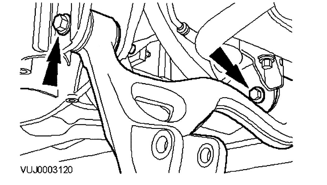

8. Remove the lower arm.
^ Discard the lower arm front and rear retaining bolts and lock nuts.

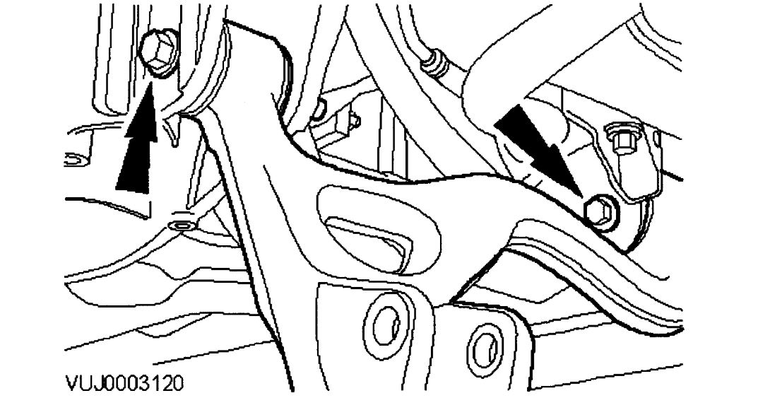

9. Remove the lower arm.
^ Discard the lower arm front and rear lock nuts.
