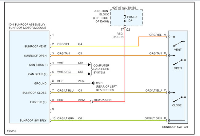

I get no response from the sunroof when I try to do anything with it. any suggestions?

It is either a bad fuse, motor or sunroof control module here is a guide and the wiring diagrams so you can see if the motor/module is getting power.
Check out the images (below). Please let us know what you find. We are interested to see what it is.
