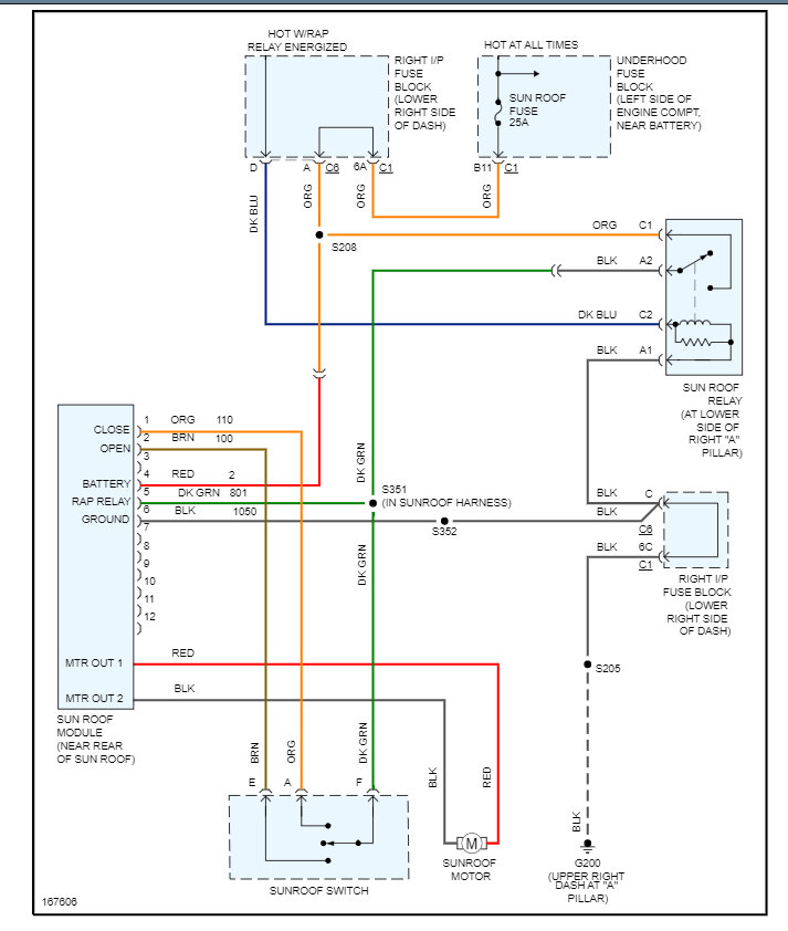

Replacing the entire sunroof assembly with a salvage unit and want to bench test before installation. Do you have a wiring diagram for this assembly? It's an 8 pin connector with 4 in use.
Mar 21, 2023 at 1:01 AM
  • 55,583 POSTS
Sure, here are the wiring diagrams for the sunroof and a guide to help you test the connections:
Check out the images (below). Please let us know if you need anything else to get the problem fixed.
