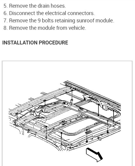

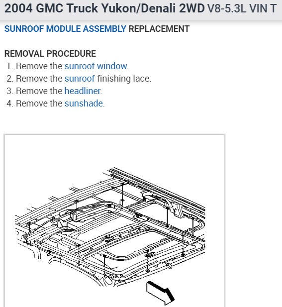

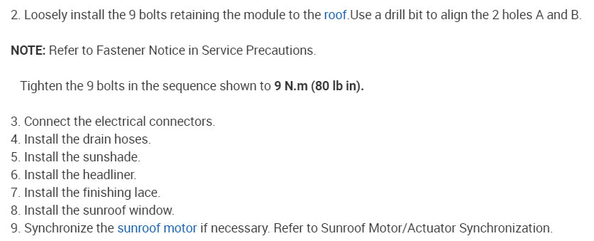

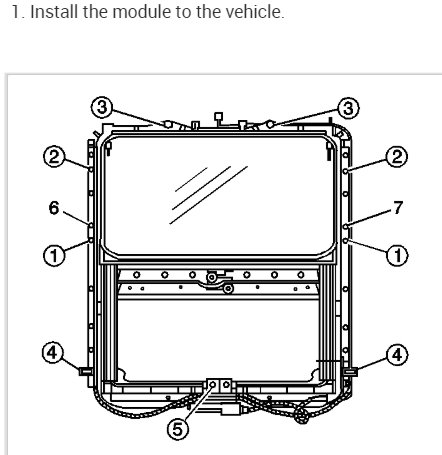

If you attached any pictures they didn't come through. I've attached replacement steps on how to remove and install below.Hope this helps and thanks for using 2CarPros.
