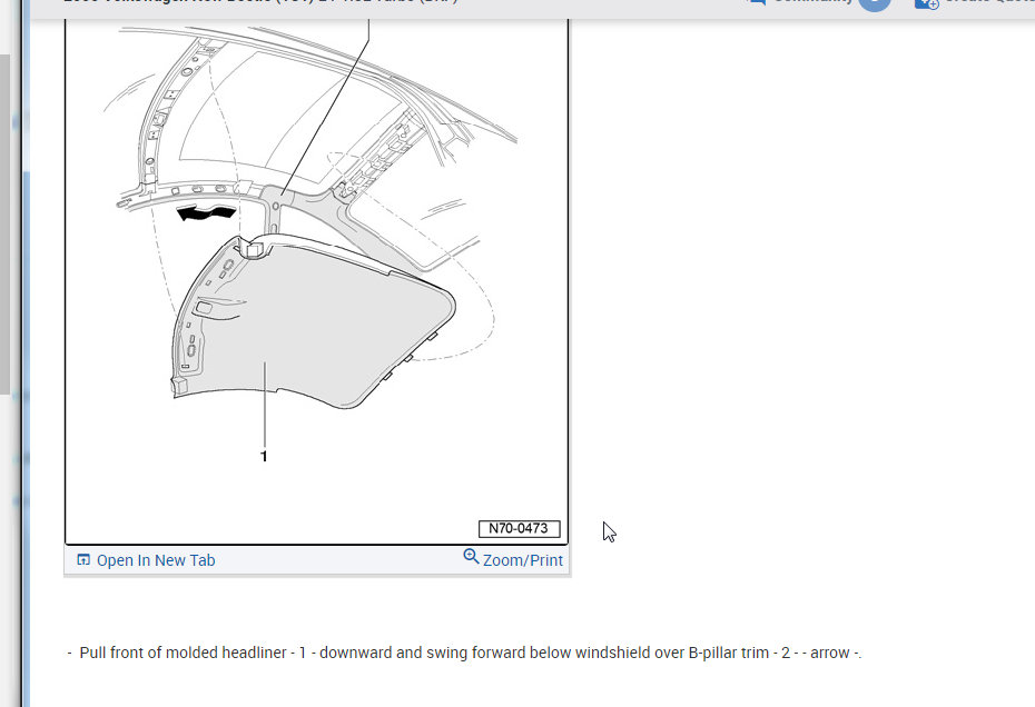

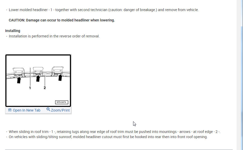

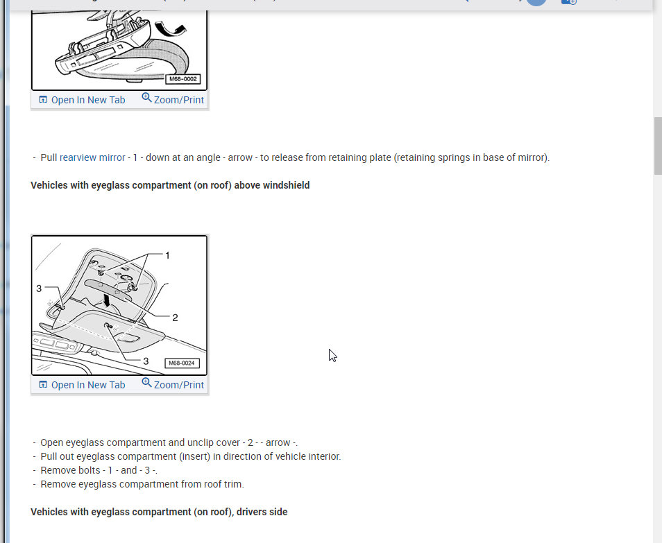

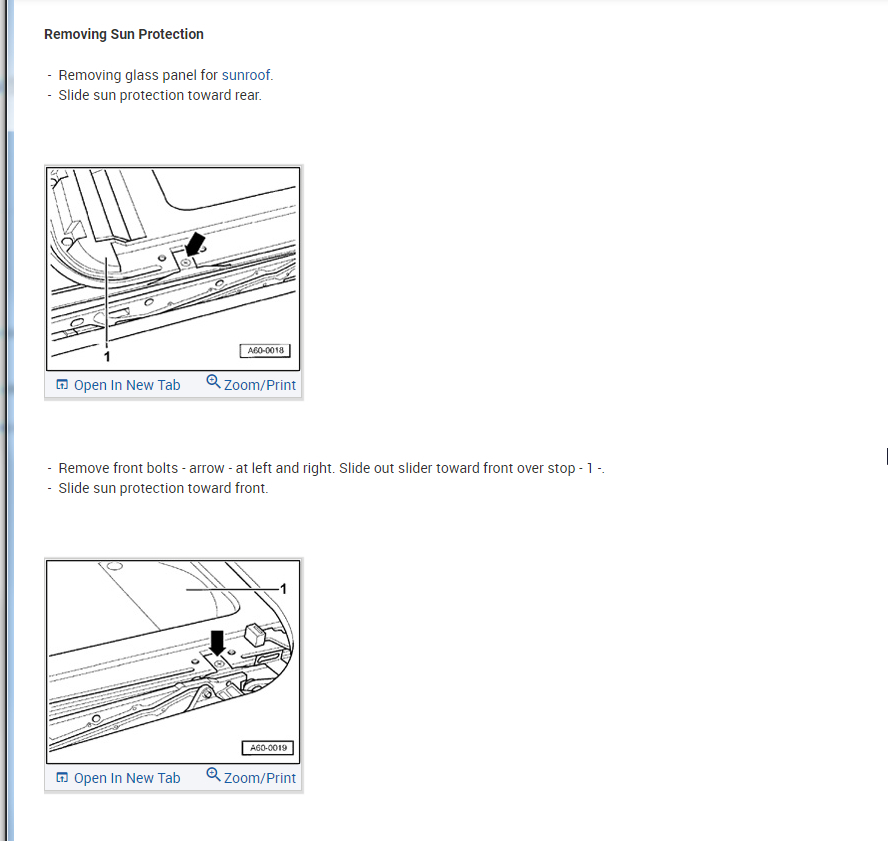

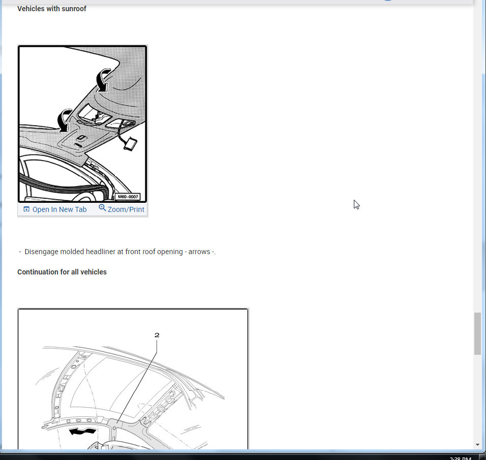

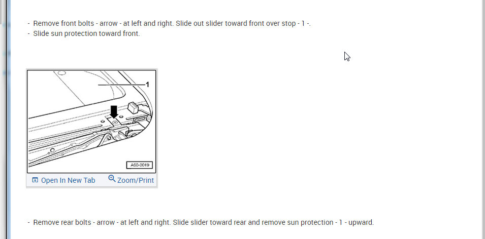

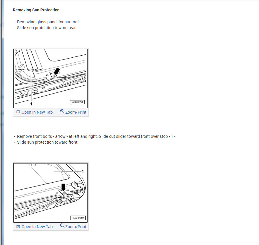

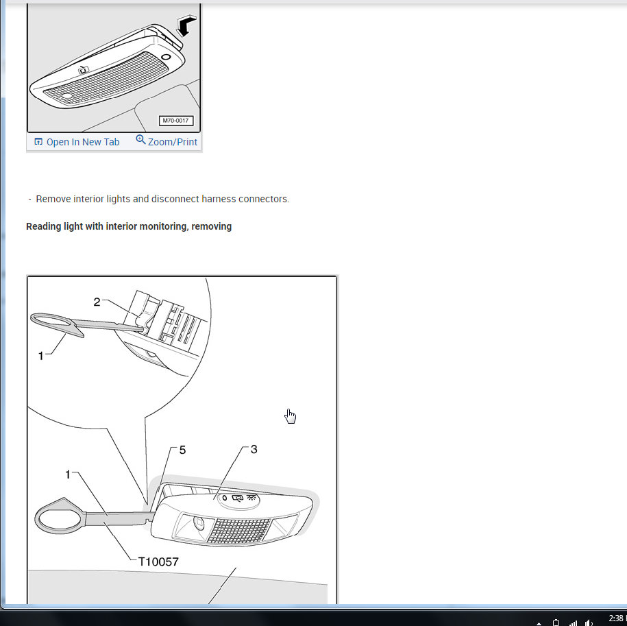

The sunshade in my car is jammed under the sunroof so neither will close. when i turn the control dial i can hear the sunroof motor working and trying to close by the shade is stuck. any advice greatly appreciated!
May 25, 2021 at 4:08 PM

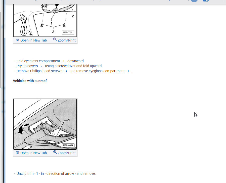

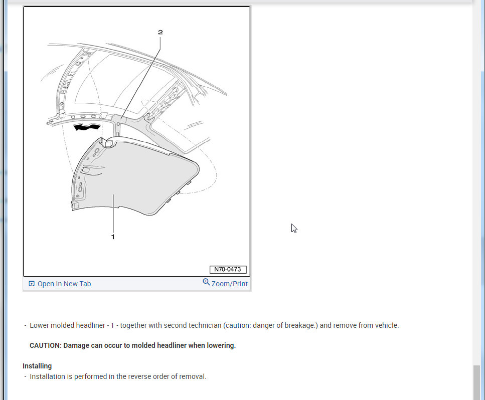

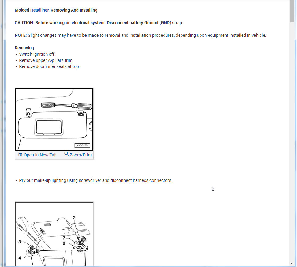

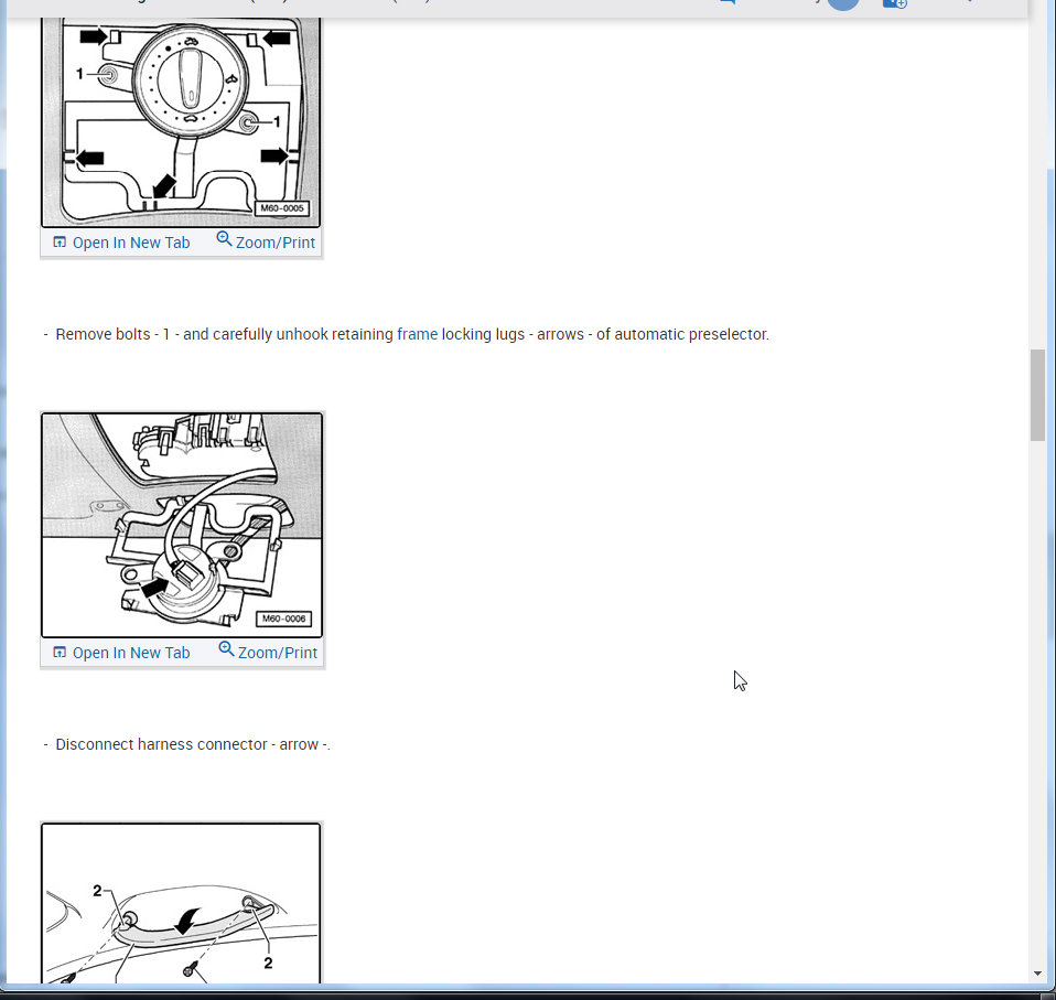

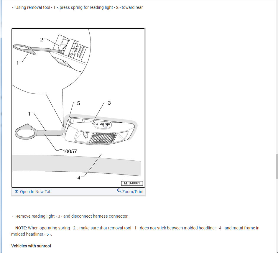

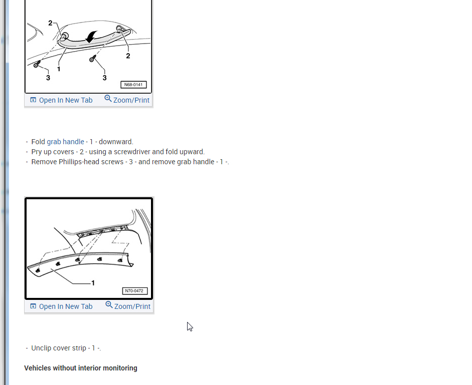

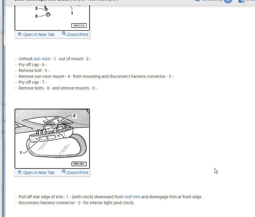

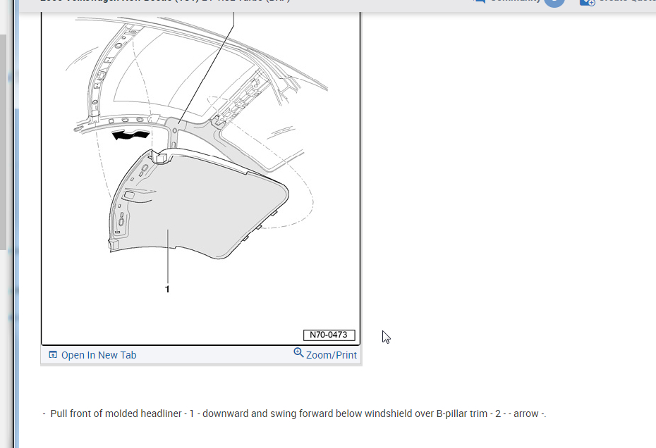

More than likely you are going to have to drop the headliner. However, I included the process on how to remove the sun protection portion which is what that is called. However, due to it being stuck, I would just go ahead and drop the headliner to what is going on in there.
Please run through this info and let us know if you have other questions. Thanks
