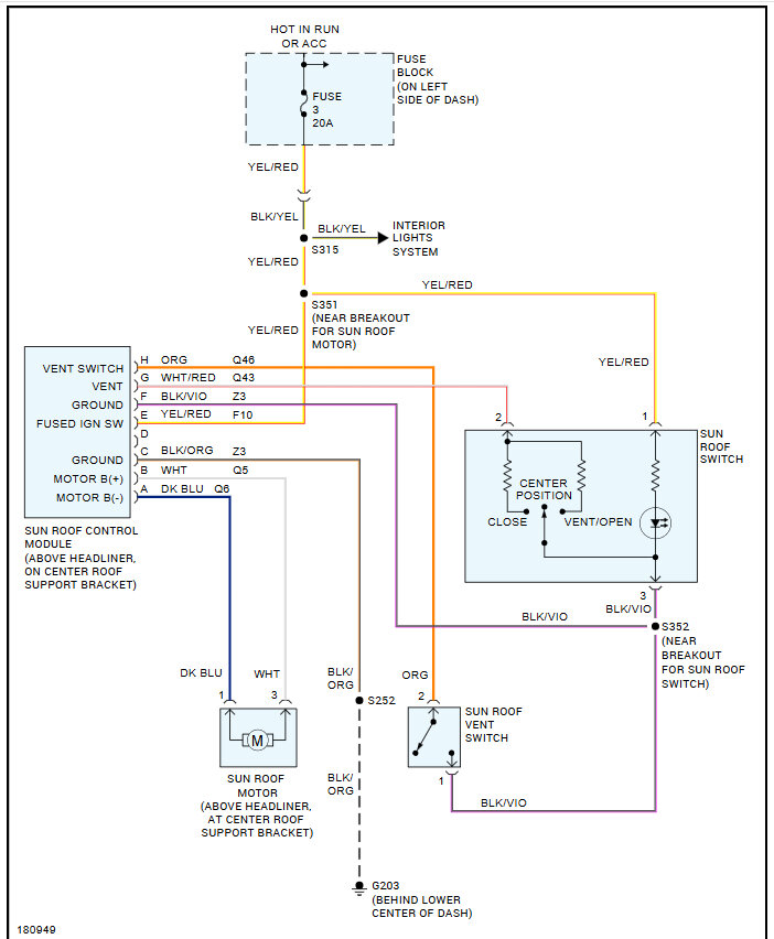

Bought the car listed above SXT model from someone couldn't get the sunroof to work but found out they had the switch unplugged. I plugged it in the sunroof opened perfectly but will not shut/close. I need help it's raining.

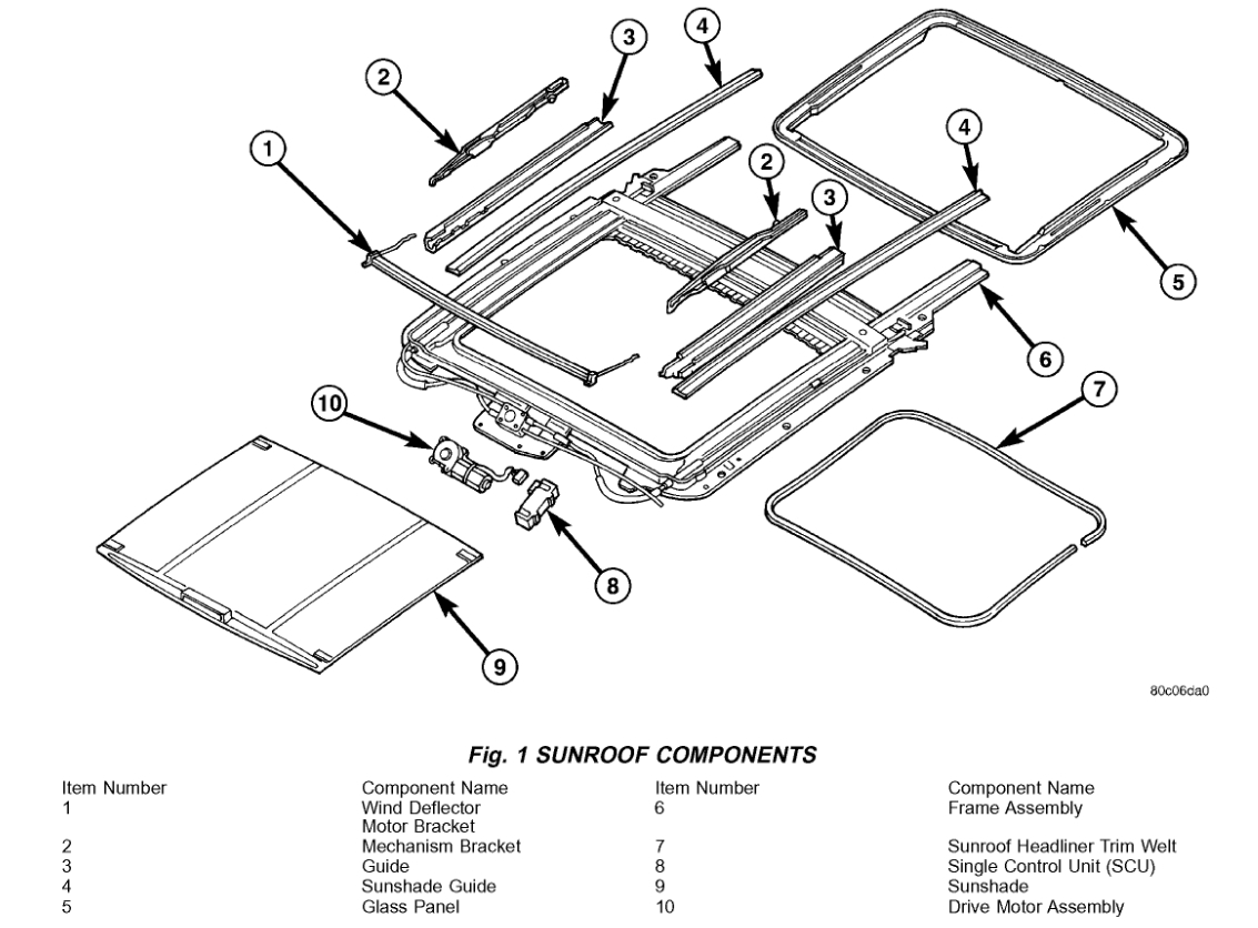

Yep, it sounds like the switch is bad which is common. I would try working the switch rapidly to close and it make work, here is how to change it out which should fix the problem. Here is the sunroof construction and wiring diagrams so you can see how the system works. There is a chance the control module is out FYI. Check out the images (below). Please let us know what happens.
