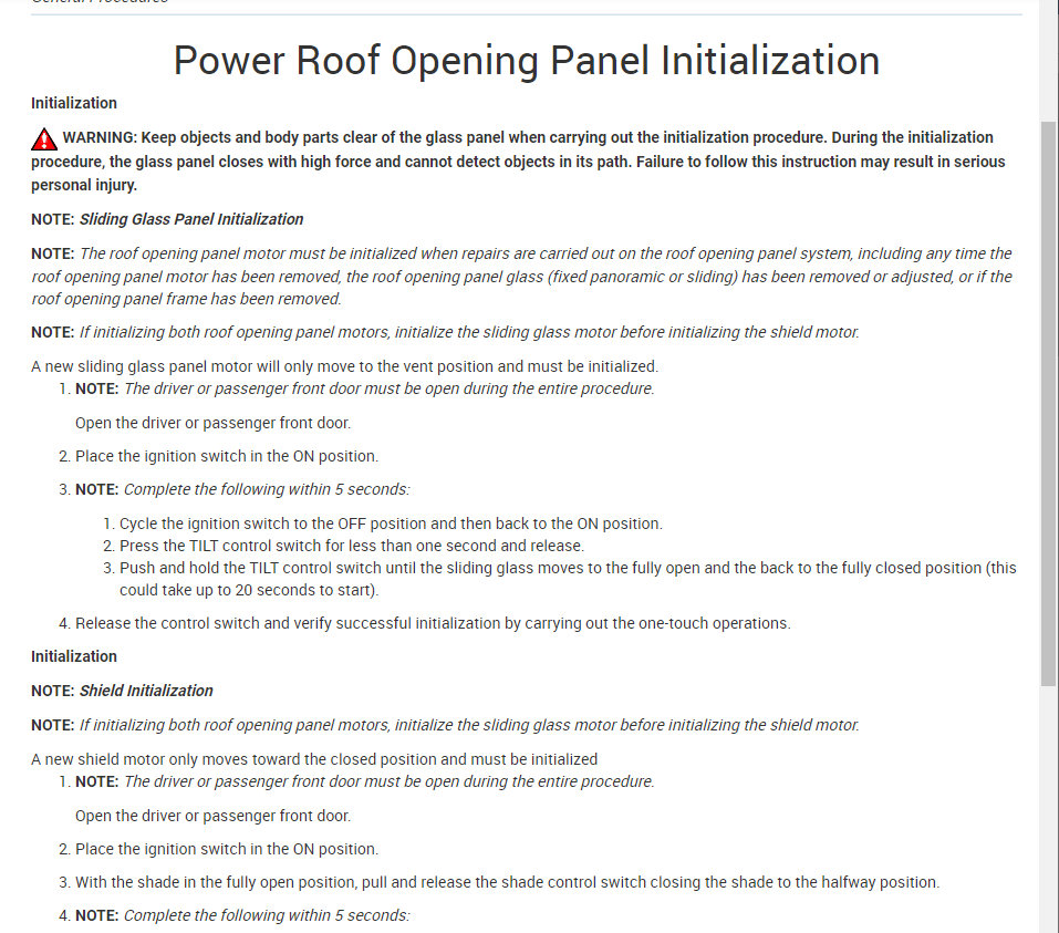

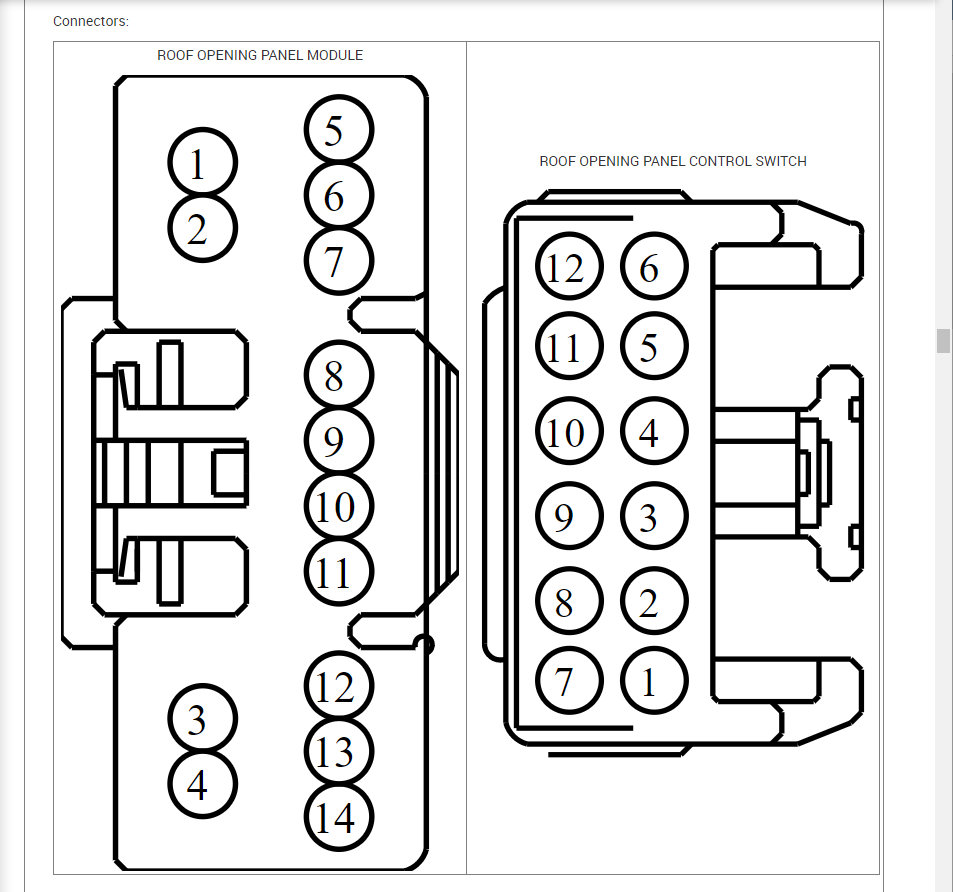

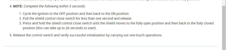

i have the vehicle listed above (Sport) i bought it second hand. my problem is when i try to open the sunroof it doesn't work. so i follow the guide for initialization so it works but only up to tilt position when i try to close it it doesn't work. so i decided to step back from the start for initializing i hear the motor works for 1 second just like a beep for the open tilt but if i press close it doesn't work.

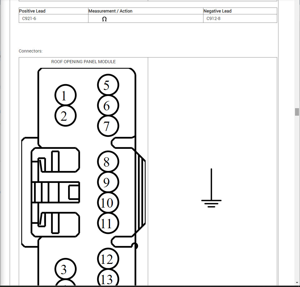

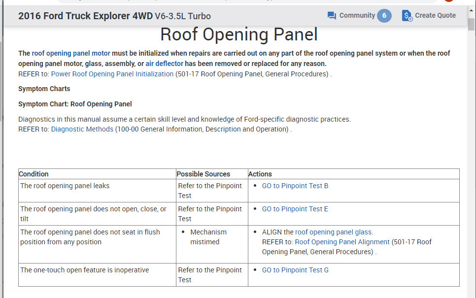

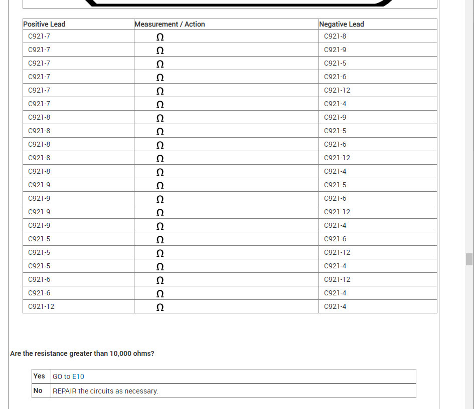

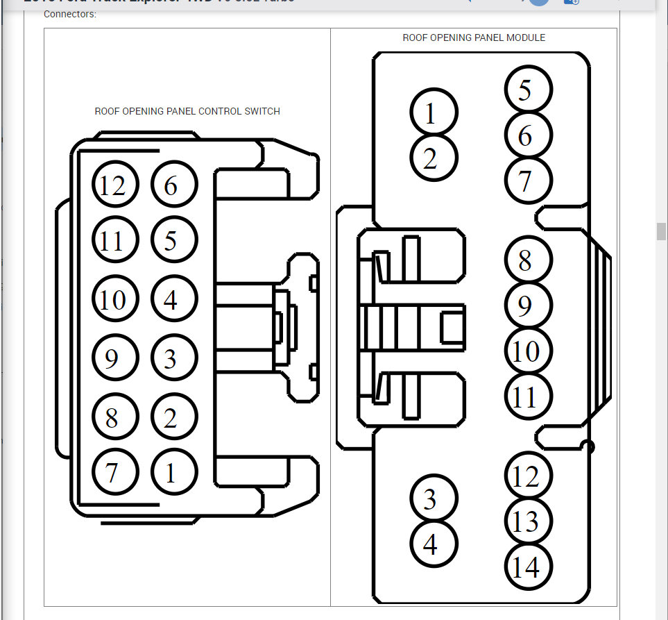

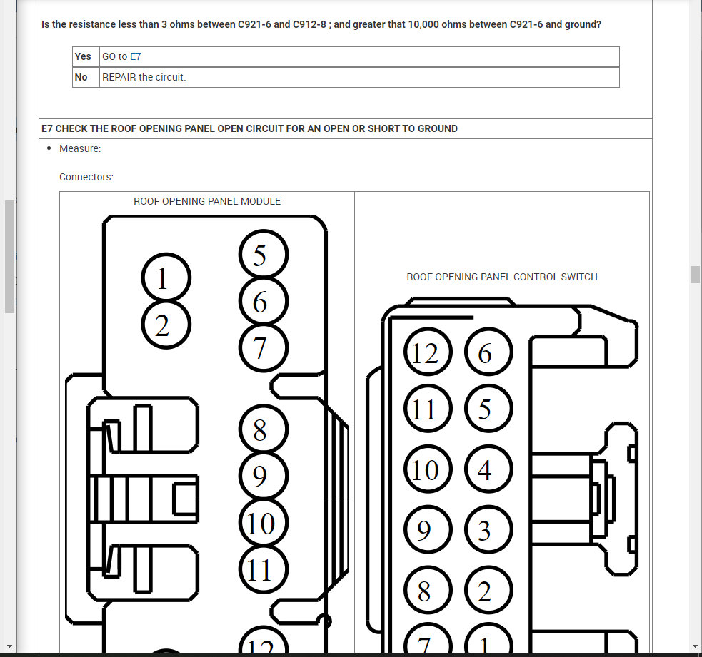

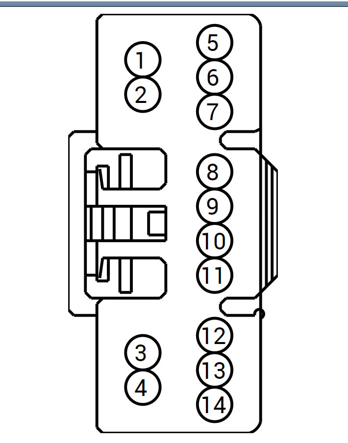

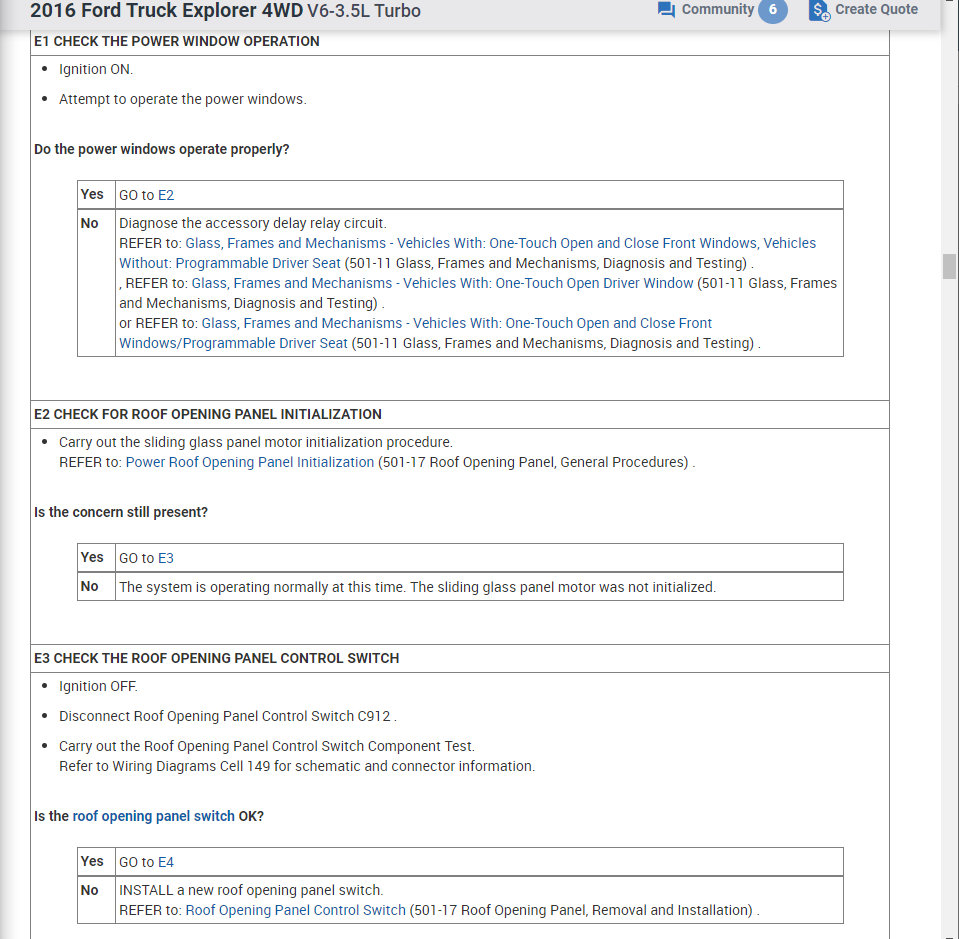

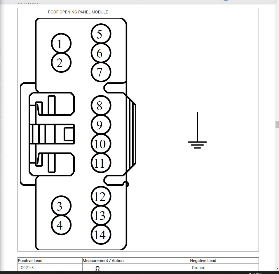

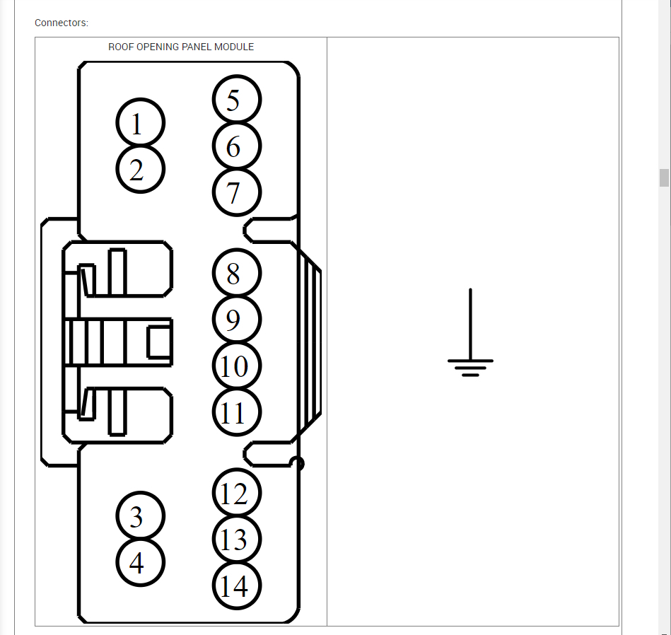

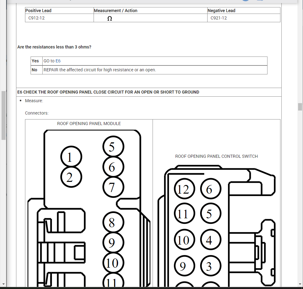

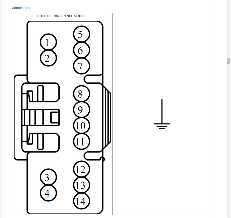

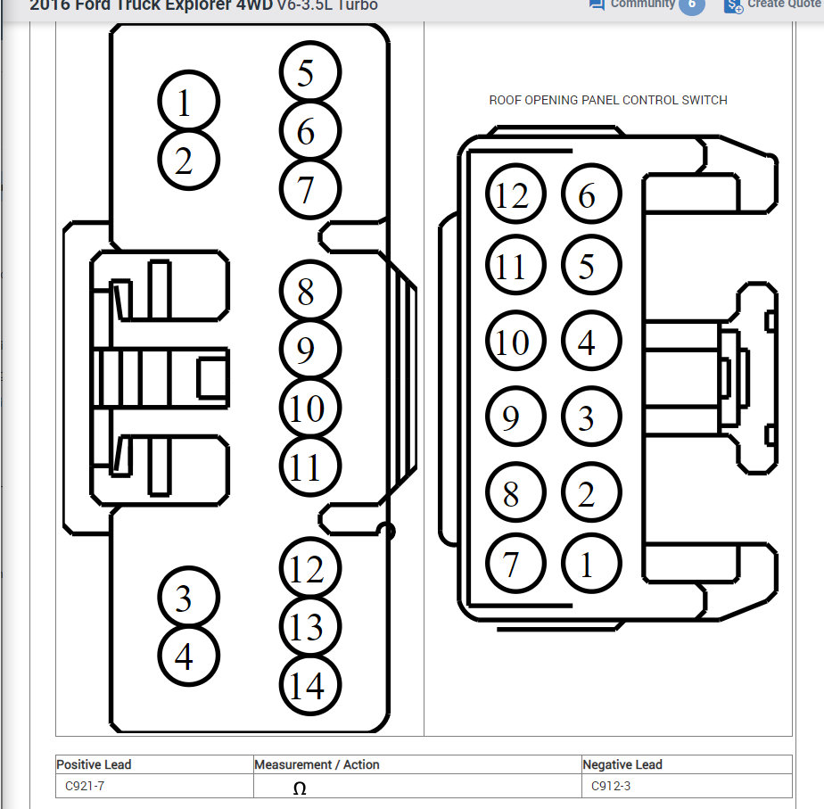

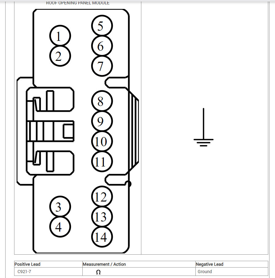

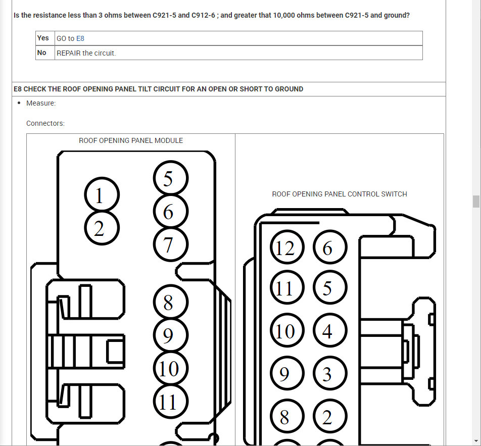

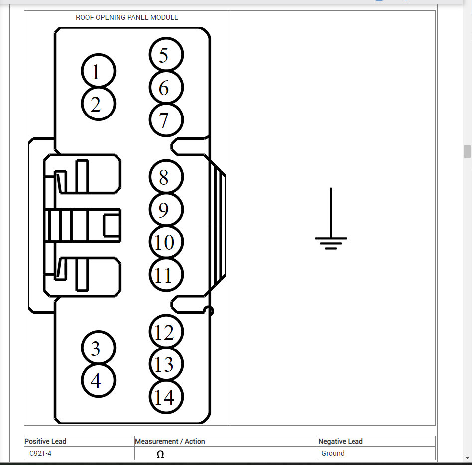

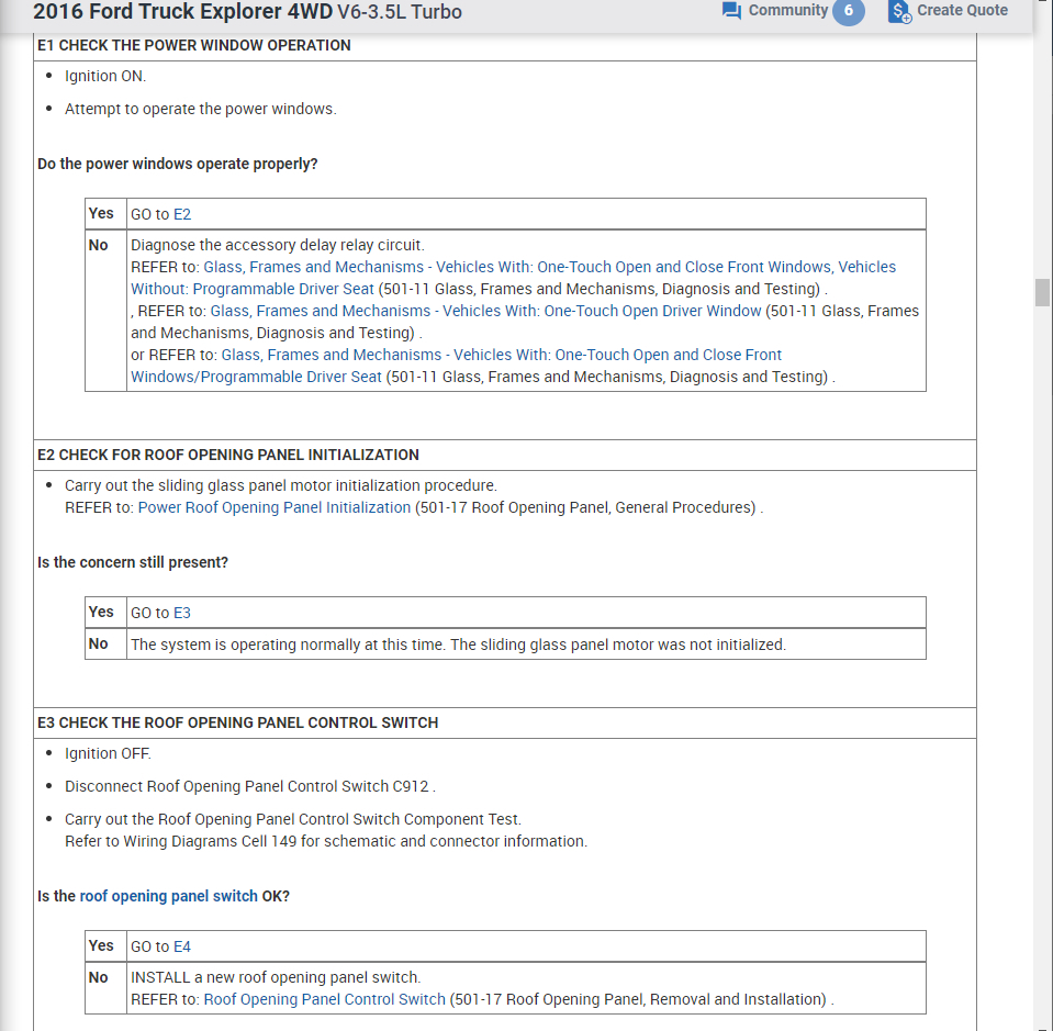

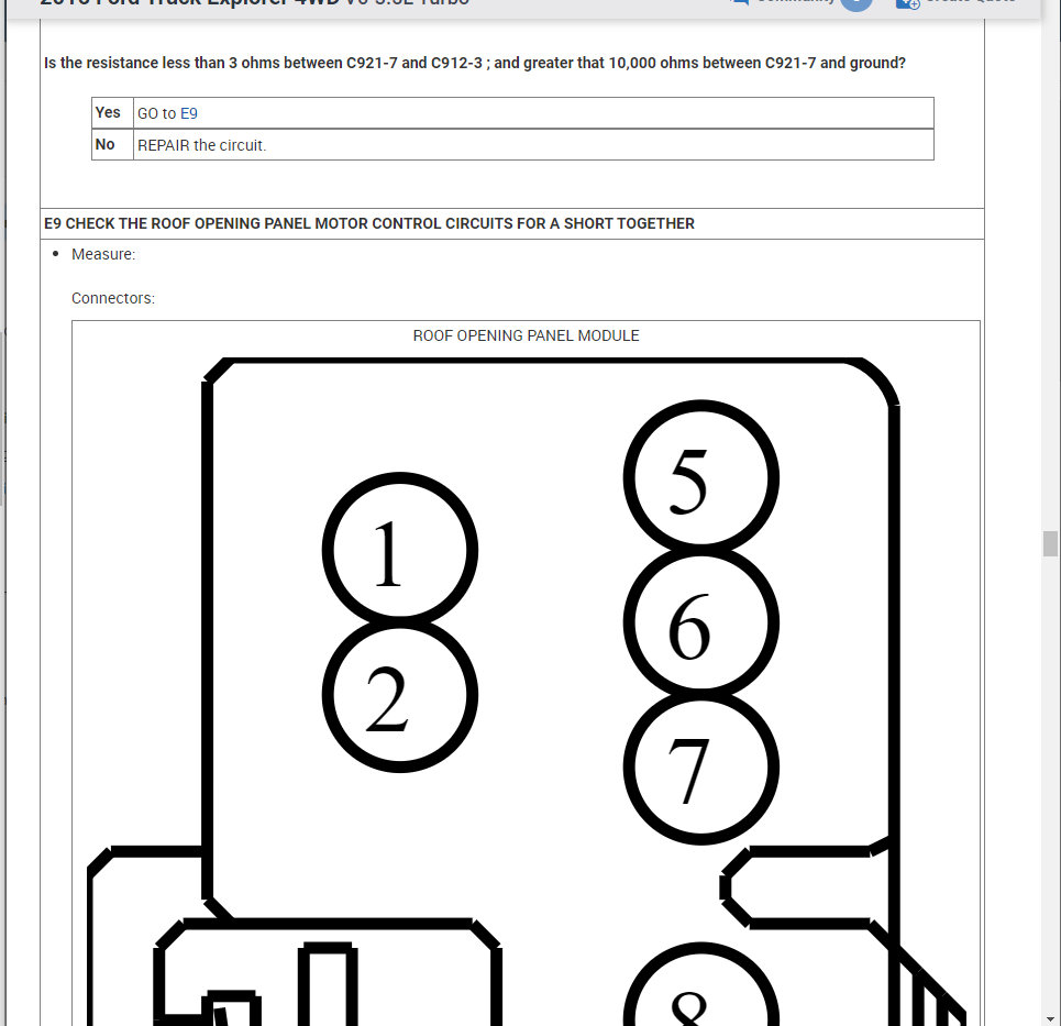

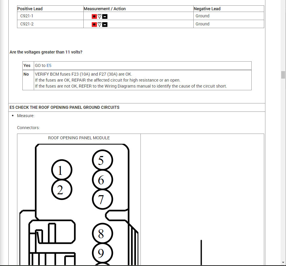

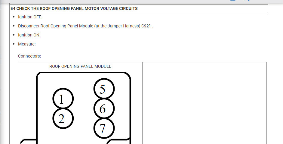

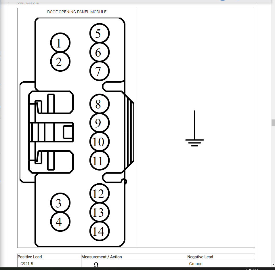

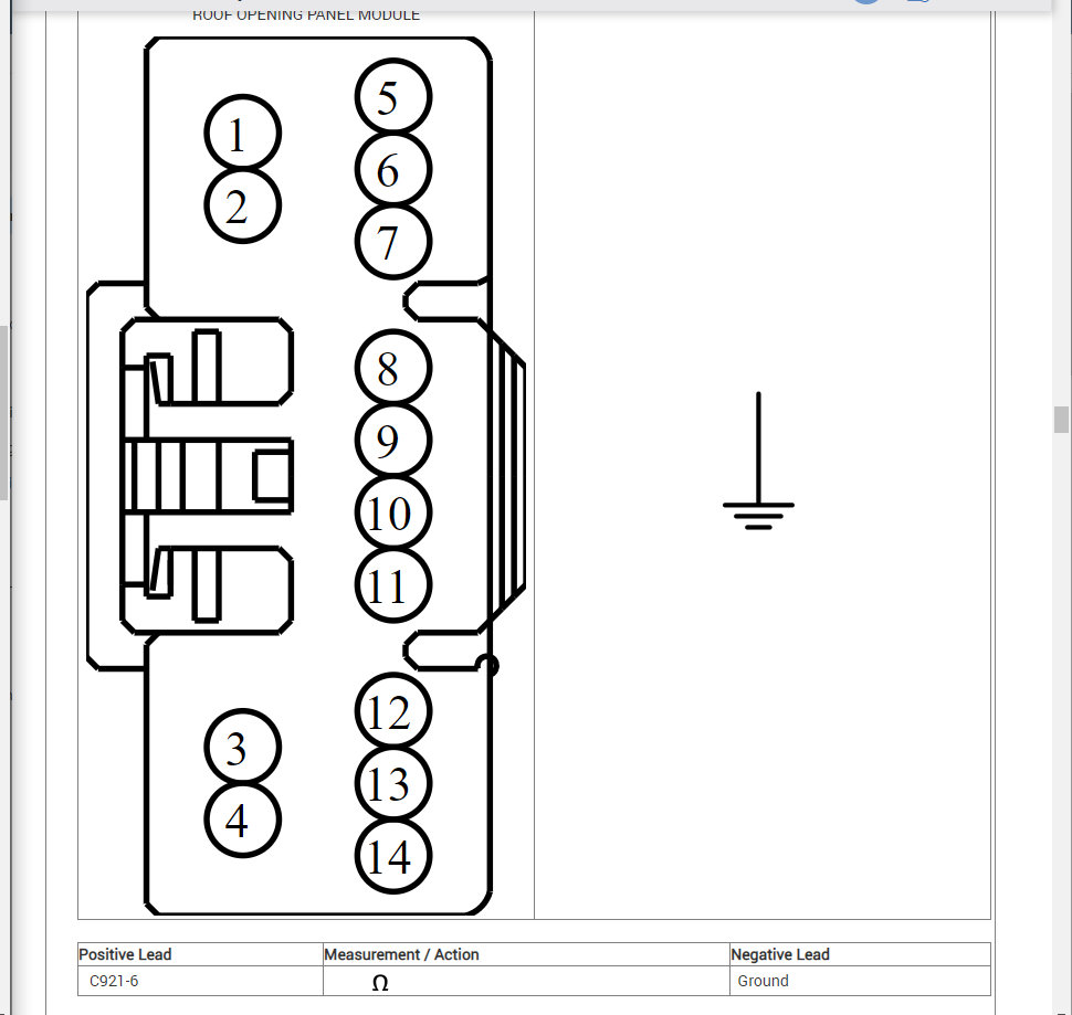

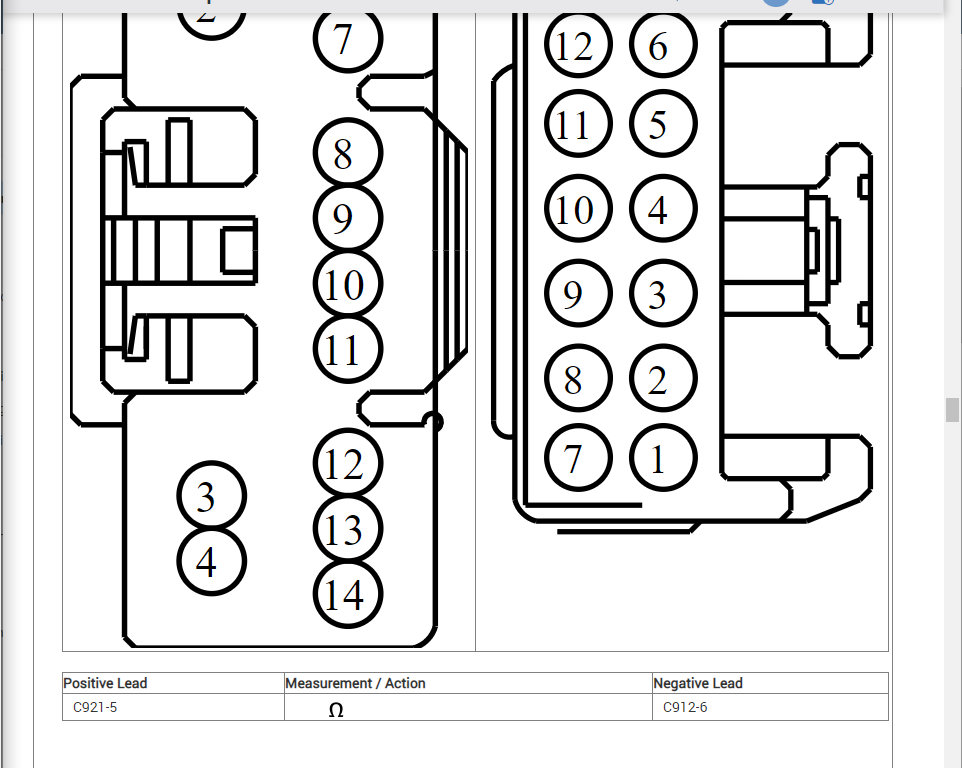

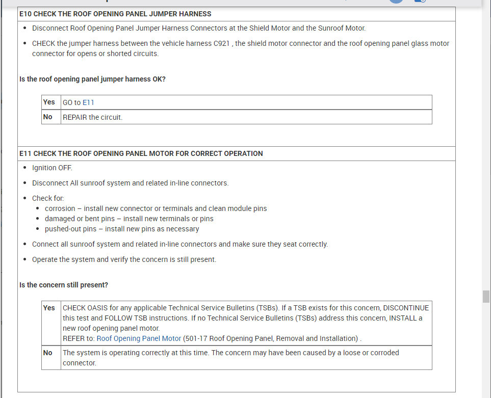

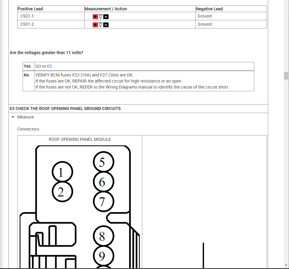

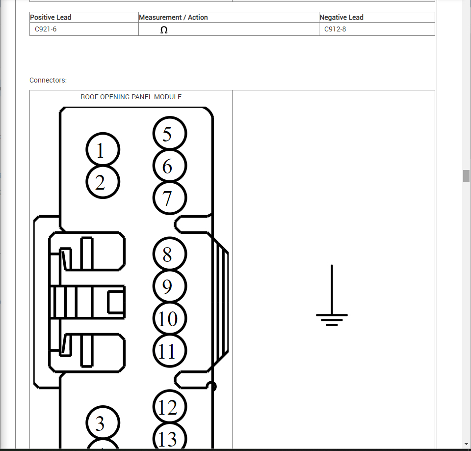

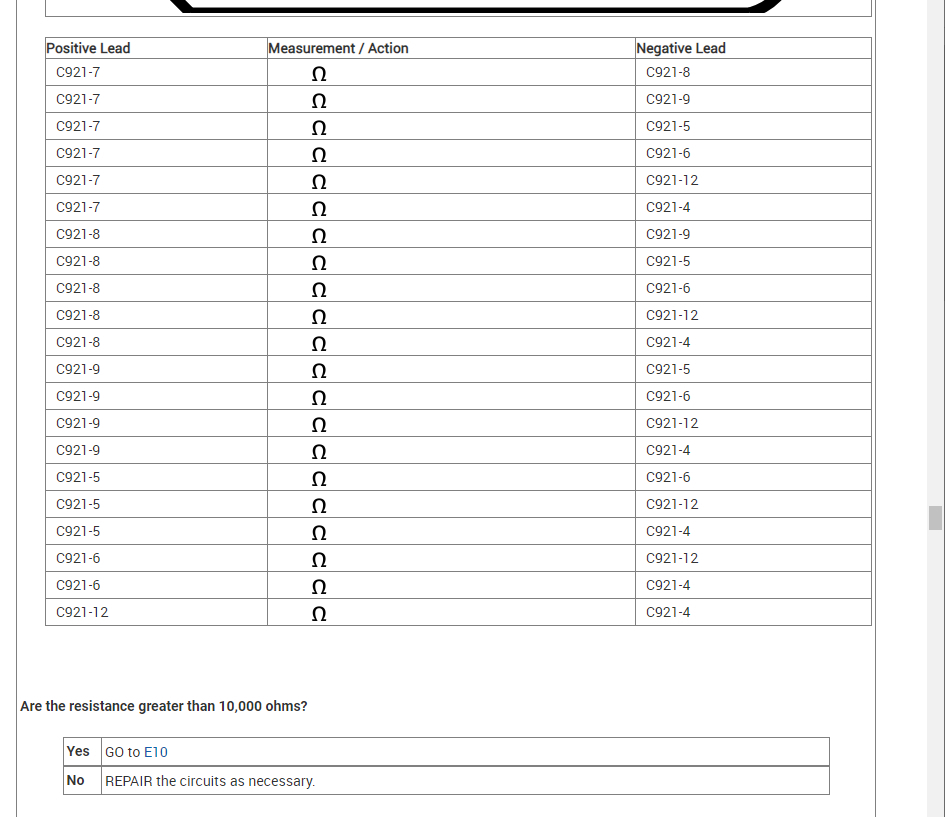

There are a number of things that would cause this but we are going to have to start with the testing that I will attach below. This will run us through the entire process on how to test it and will lead us to the issue.
Here is a guide that you will need to help with this type of testing as there is quite a bit of electrical:
Below is the testing from the manual. There are quite a few pages so we need to run through all of this.
please let me know if you have questions . Thanks
