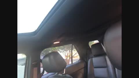

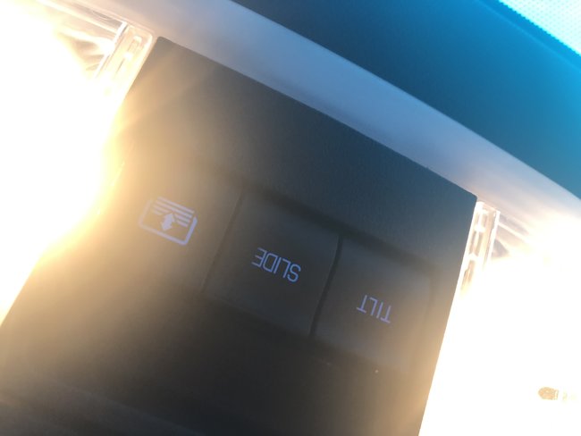

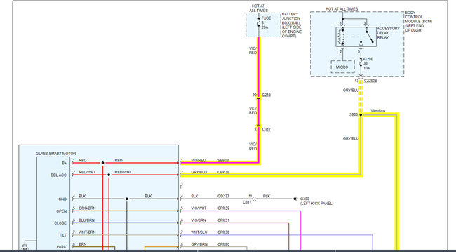

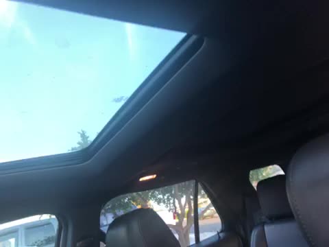

i have the XLT model with sunroof/moon-roof combo.
the sunshade will only close in the back moon-roof portion but refuses to close over the front sunroof portion.
Tilt and slide buttons also non responsive

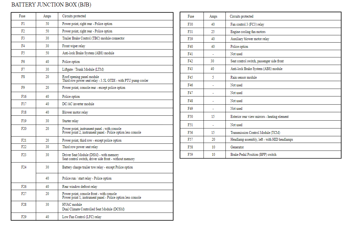

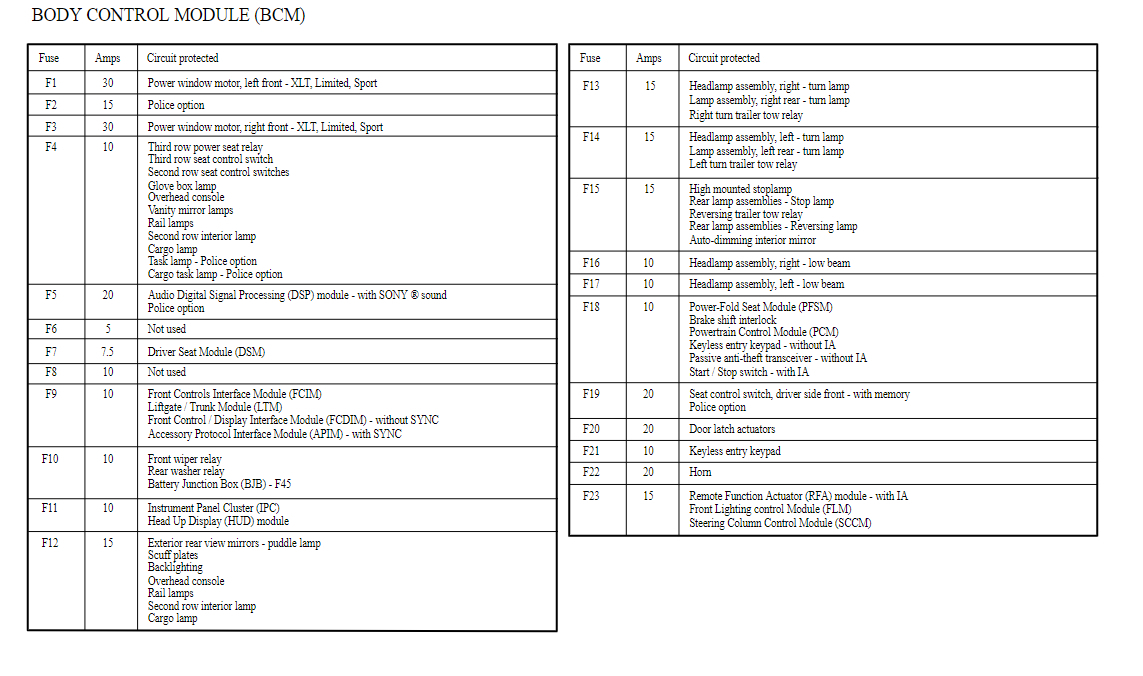

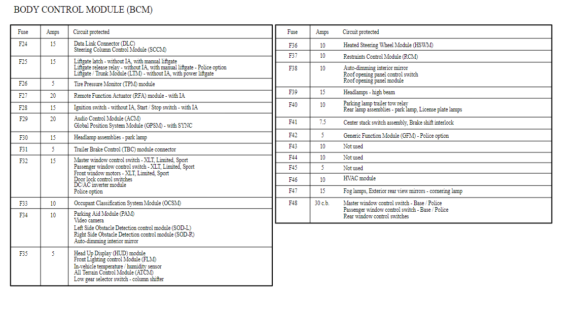

i have tried to look for the fuse for this but the manual is no help.
Jun 16, 2019 at 12:53 PM
  • 55,732 POSTS

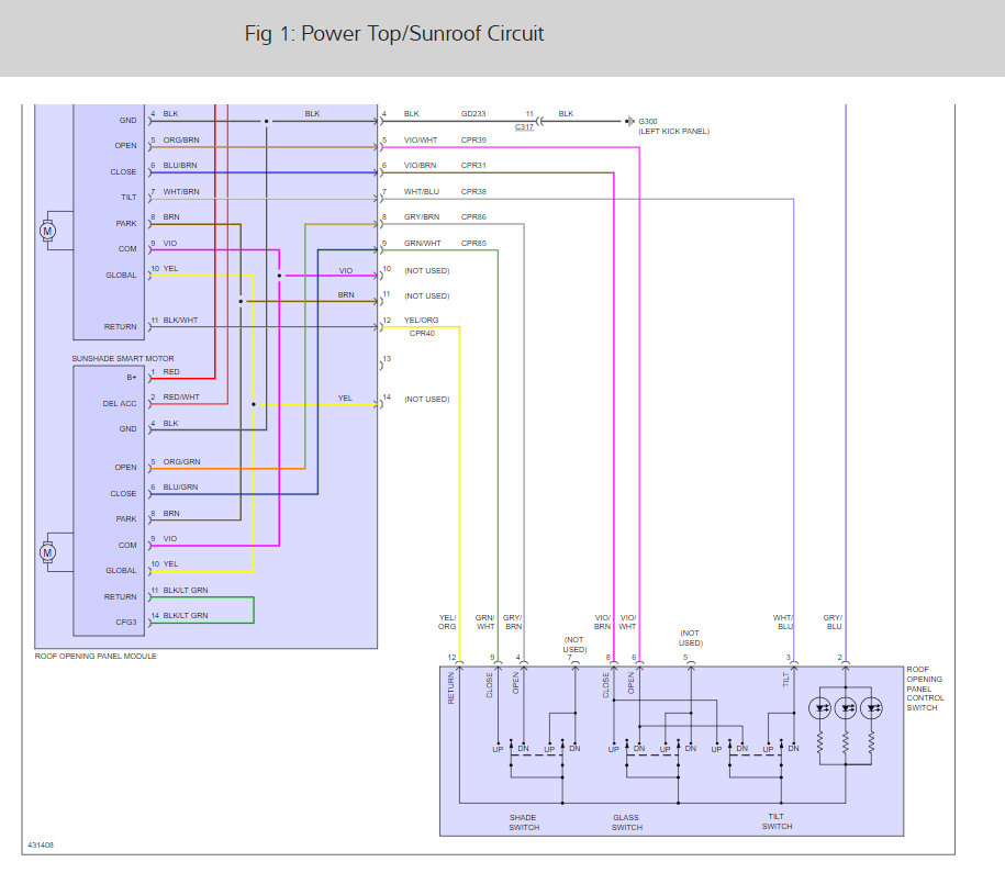

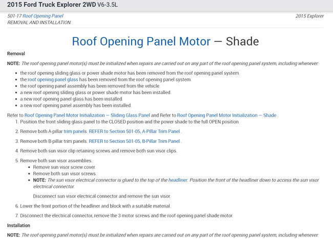

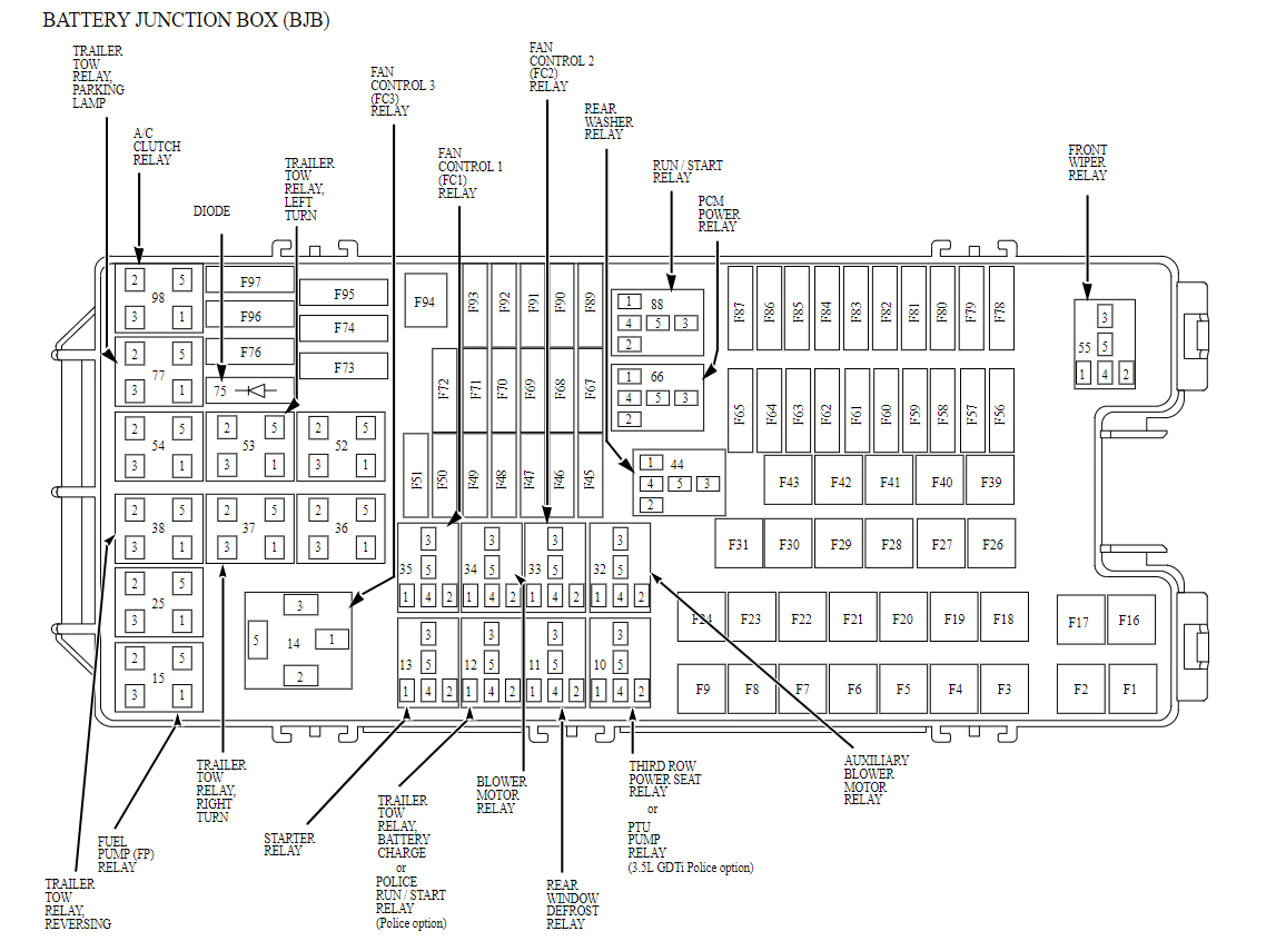

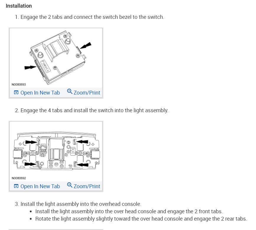

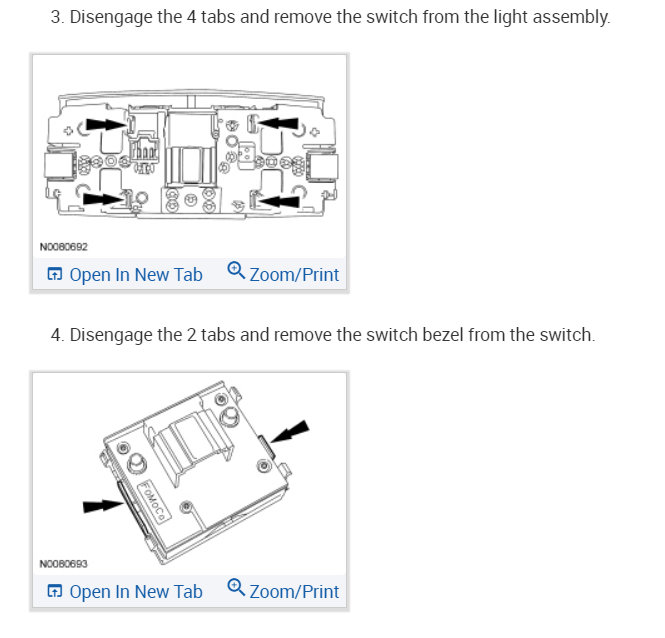

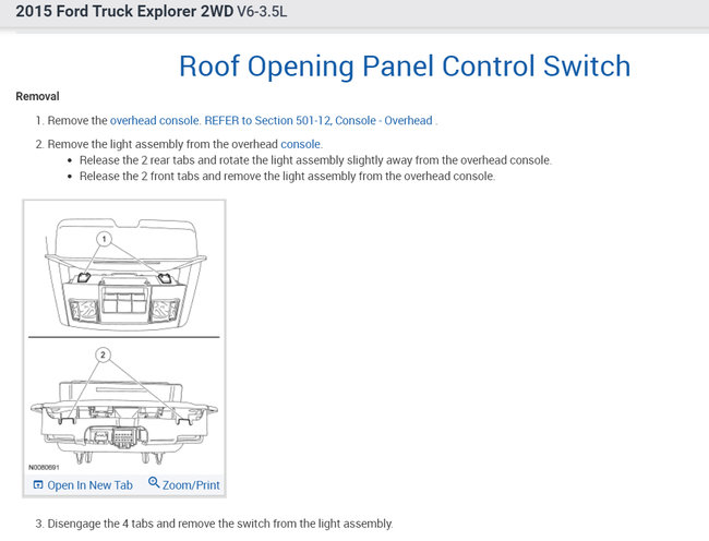

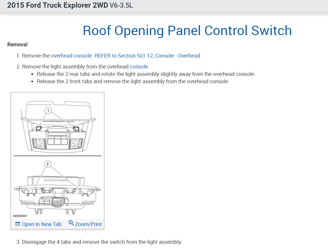

Thanks for the video it really helps. here are the sun roof wiring diagrams and a guide to help check for power, but it looks like the smart motor has gone out. here are instructions on how to change it out:
Jun 18, 2019 at 11:38 AM

It looks like they came back to read the post but did not respond so I assume it did. The wiring diagrams above show how the system works and how to change the motor out. Please let me know how it goes.

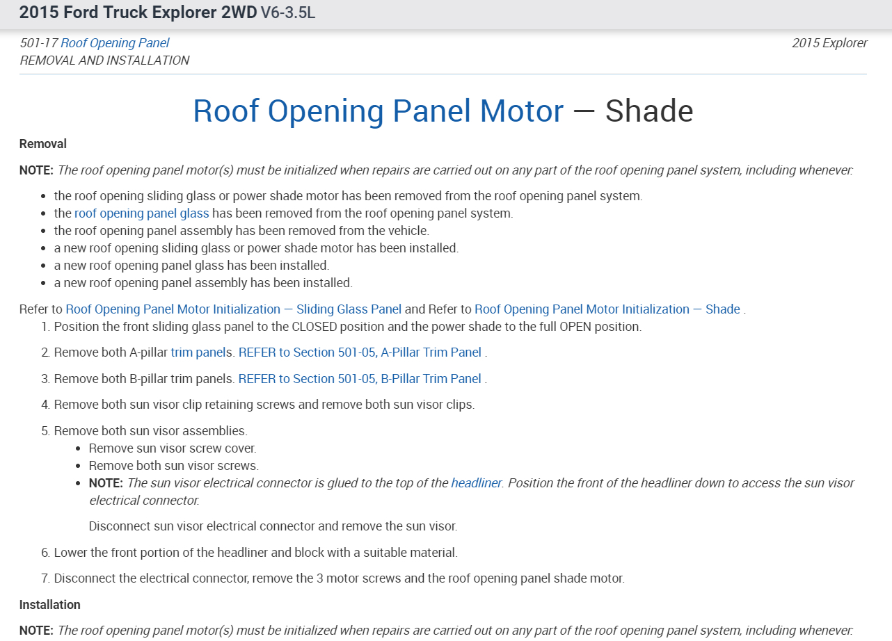

I have the same exact problem described on our 2015 Explorer Sport. Can you please provide the instructions for initialization after the repair is completed?
Also, is there a separate motor for the shade and the glass, or is the just one motor for both?

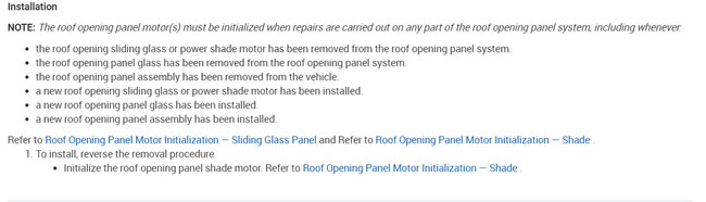

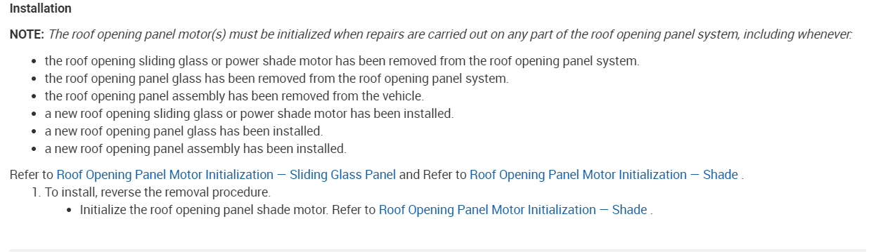

Here is the repair instructions and relearn procedures for the sun roof.
Roof Opening Panel Motor Initialization — Sliding Glass Panel
General Procedure
image WARNING: Keep objects and body parts clear of the glass panel when carrying out the initialization procedure. During the initialization procedure, the glass panel closes with high force and cannot detect objects in its path. Failure to follow this instruction may result in serious personal injury.
NOTE: A new front sliding glass panel motor will only move towards the VENT position and must be initialized.
NOTE: The roof opening panel motor(s) must be initialized when repairs are carried out on any part of the roof opening panel system, including whenever
the roof opening sliding glass or power shade motor has been removed from the roof opening panel system.
the roof opening panel glass has been removed from the roof opening panel system.
the roof opening panel assembly has been removed from the vehicle.
a new roof opening sliding glass or power shade motor has been installed.
a new roof opening panel glass has been installed.
a new roof opening panel assembly has been installed.
NOTE: The driver or passenger front door must be open during the entire procedure.
Open the driver or passenger front door.
Turn the ignition to the ON position.
Complete the following within 5 seconds:
Cycle the ignition to the OFF position and then back to the ON position.
Push the TILT switch for less than one second and release.
Push and hold the TILT switch until full glass open and closed is witnessed (this could take up to 20 seconds to start).
Release the switch and verify successful initialization by carrying out one-touch open, one-touch close and one-touch vent operations.

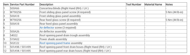

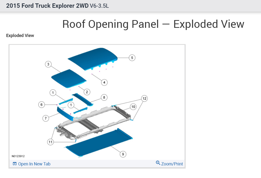

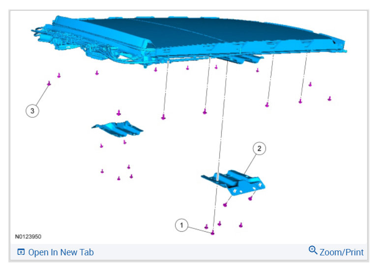

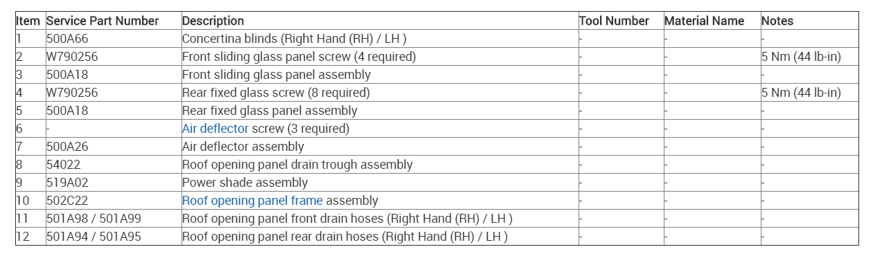

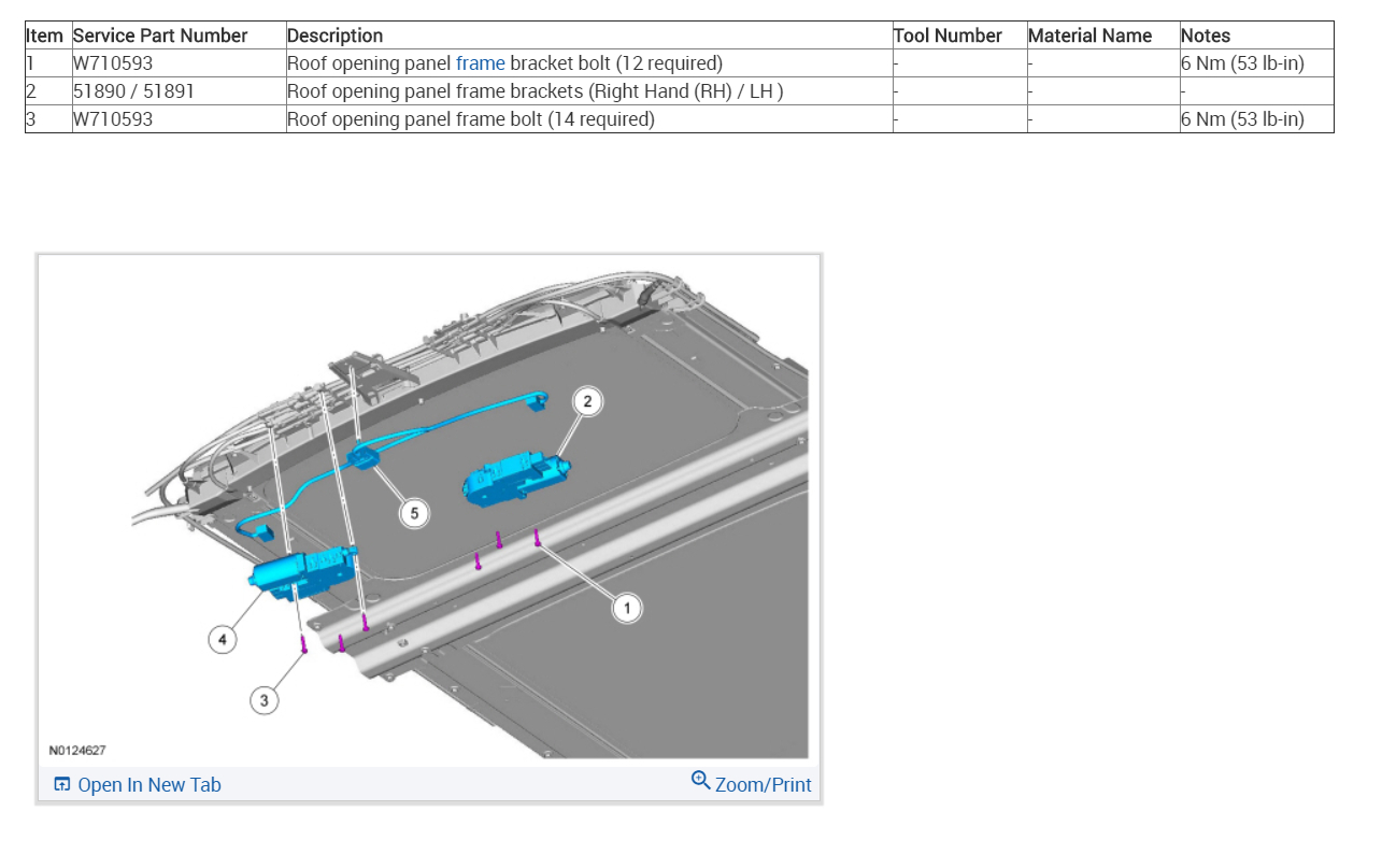

Thanks Ken, this helps a lot. Can you please provide provide an image of the parts listed in the 4th photo (the one showing the motor)? Thank you.
Aug 12, 2020 at 10:25 AM
  • 55,732 POSTS
Here is the part numbers for the motors:
Motor BB5Z15790A $178.00

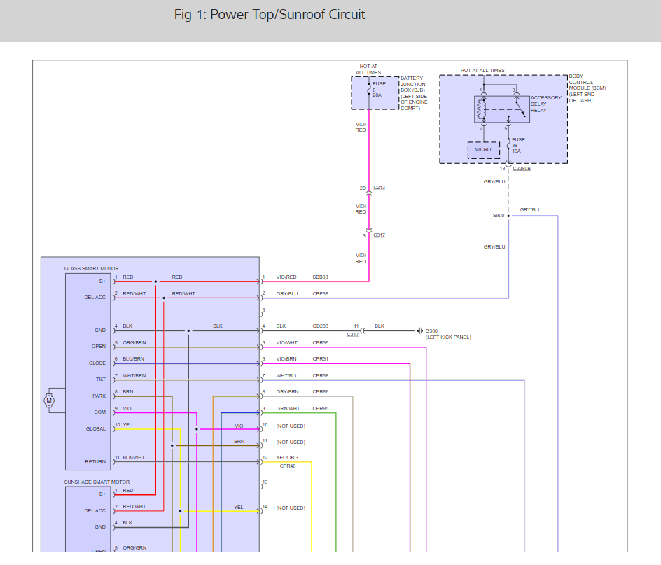

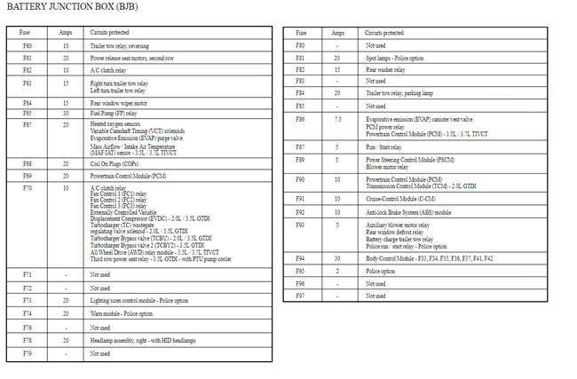

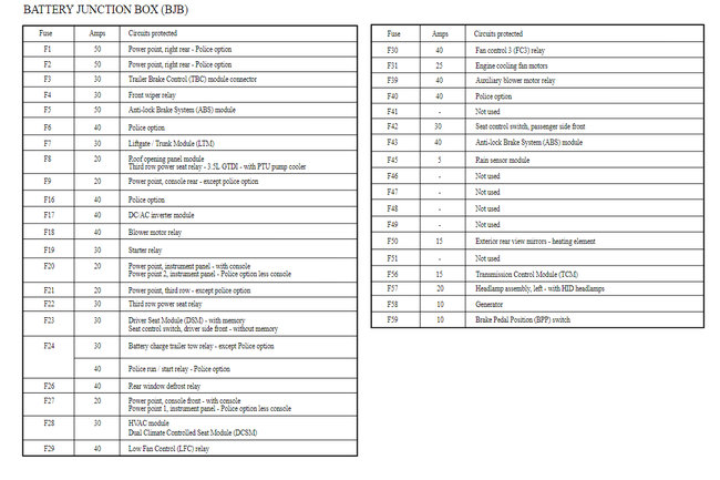

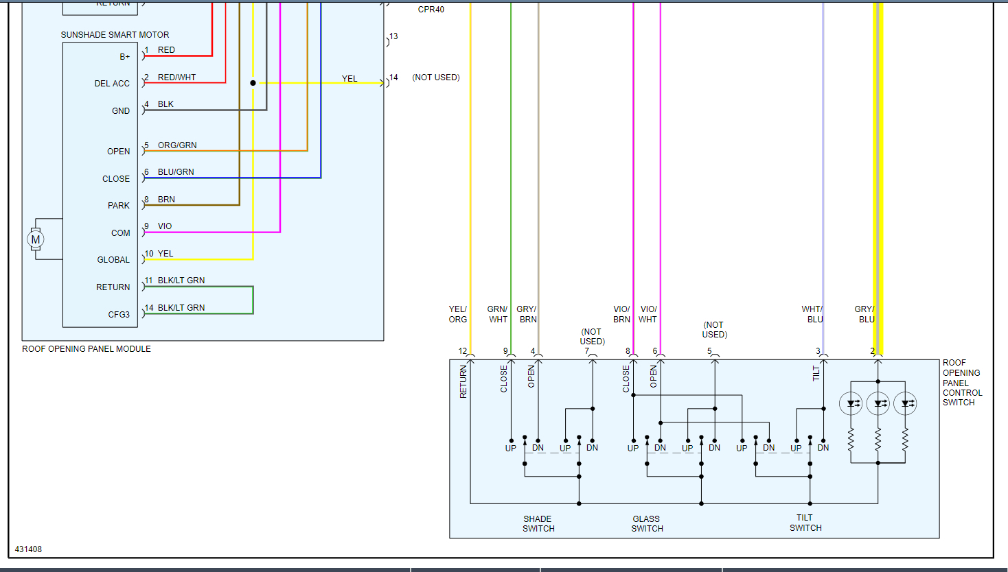

Do you have power at the violet/red wire at the controller or #F8 fuse (key on) in the fuse panel under the hood? This guide will help:
Sep 26, 2020 at 3:01 AM

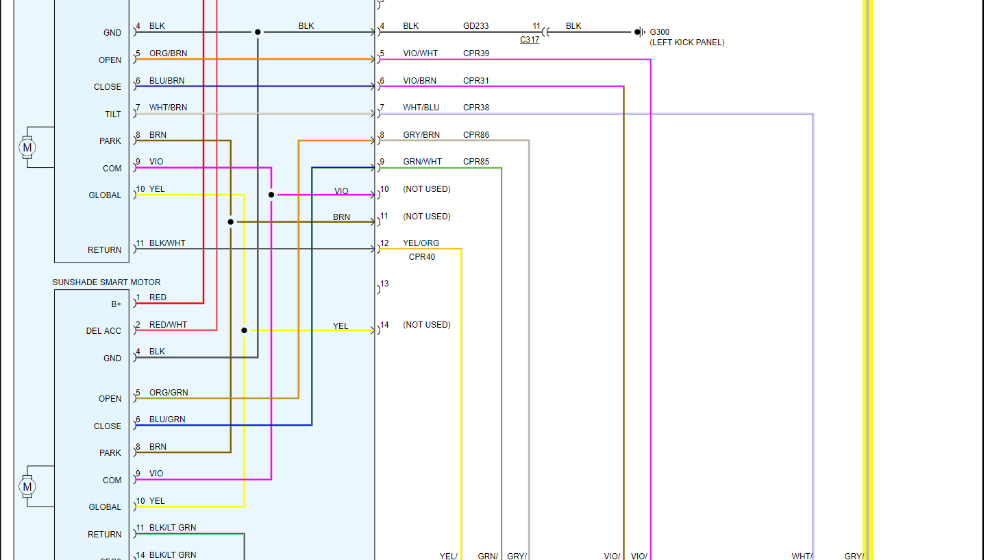

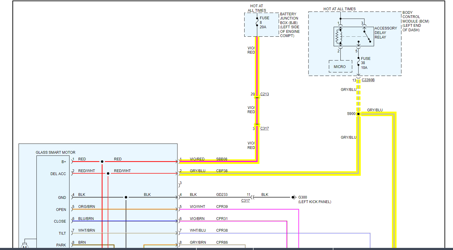

I’m having the same issue with my wife’s 14 limited. After some preliminary diagnostics,
-both fuses are good
-have 12 volts on terminal 1 at the glass smart motor
-ground on terminal 4
-only showing roughly 4.5 volts on terminal 5 and 6 when I press the switch accordingly
I guess my question is, is this correct? I’m familiar with the fact that some electronics use a 5 volt reference. But just unsure of this. Any input would be greatly appreciated.
Aug 9, 2021 at 11:08 AM
Good morning,
I attached the wiring diagram for you to view.
No, the voltage is too low. Looks like you may need the control module as there is not enough power for the motors to work.
There is a second fuse as well I highlighted the wire for you.
Aug 11, 2021 at 8:25 PM
