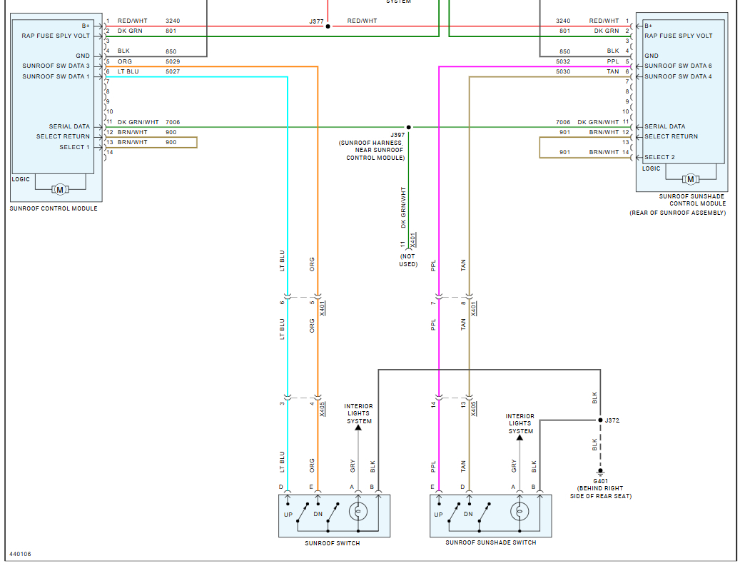

Can anyone help me with identifying the colors on the sunroof switch or a diagram?

Sure, here are the sunroof wiring diagrams for the switches, let me know if you need anything else. Check out the images (below).
