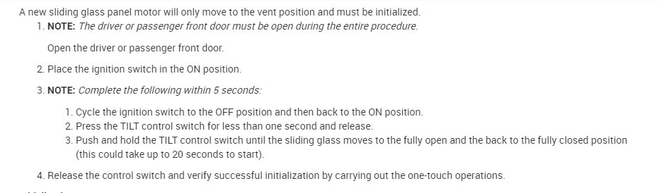

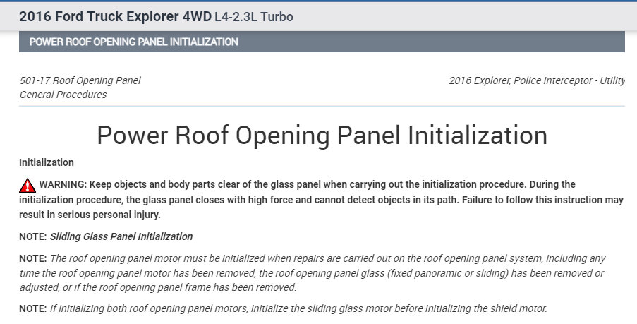

I just replaced the sunroof motor on the vehicle listed above, now it won’t initialize, and the slide and tilt buttons seem to do random actions. For example, if I do the “slide close” the sunroof tilts open. If I do the tilt close, it slides back but only just barely. When I do the tilt close, it just barely closes stand I have to keep pressing it until I get it all the way shut.

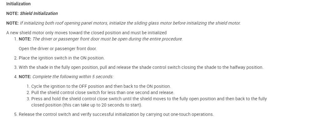

There is a module that controls this, but they usually are very dependable. Do me a favor, take a look through the initialization procedure below, and let me know if that is what you are doing.
Next, and don't laugh, when you perform the initialization procedure, one of the front doors must remain open throughout the entire procedure.
See pics below

Thank you, I will give this a try again. I’ve run through it a handful of times so maybe I just wasn’t holding it long enough. I’ve had the driver side door open each time, so maybe I’ll try with the passenger door open as well.
