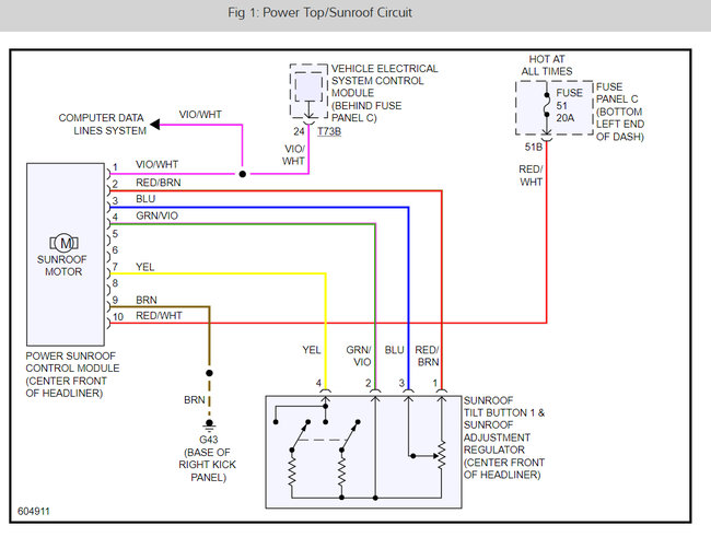

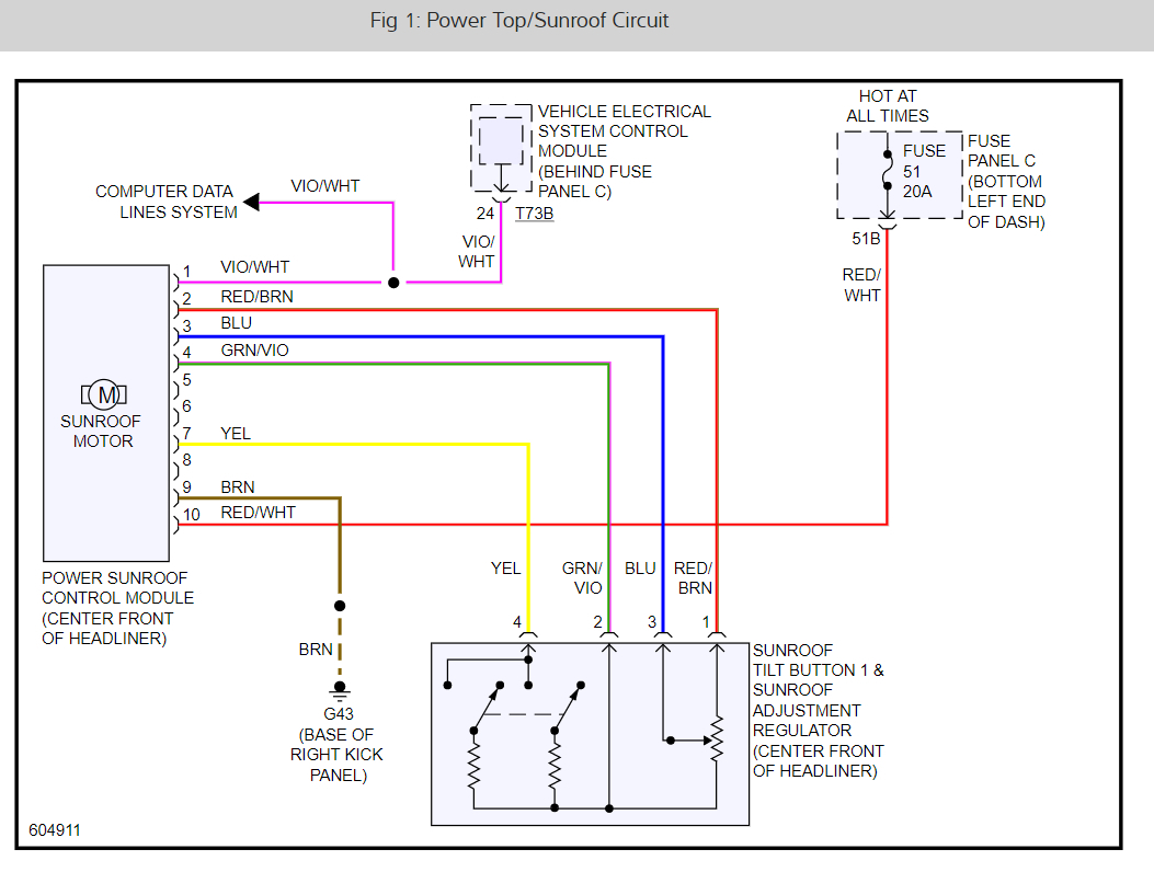

The mobilizer is not working to open or close windows and sunroof.
Jan 28, 2020 at 2:27 AM
  • 55,721 POSTS

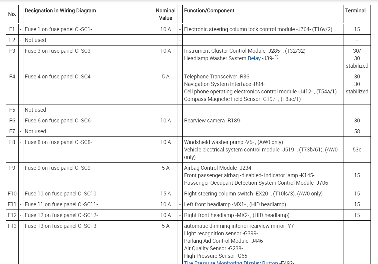

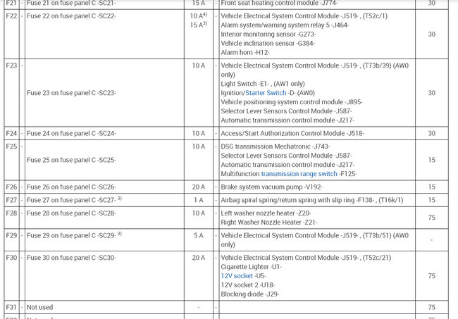

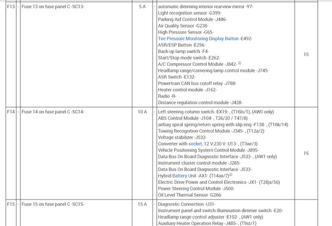

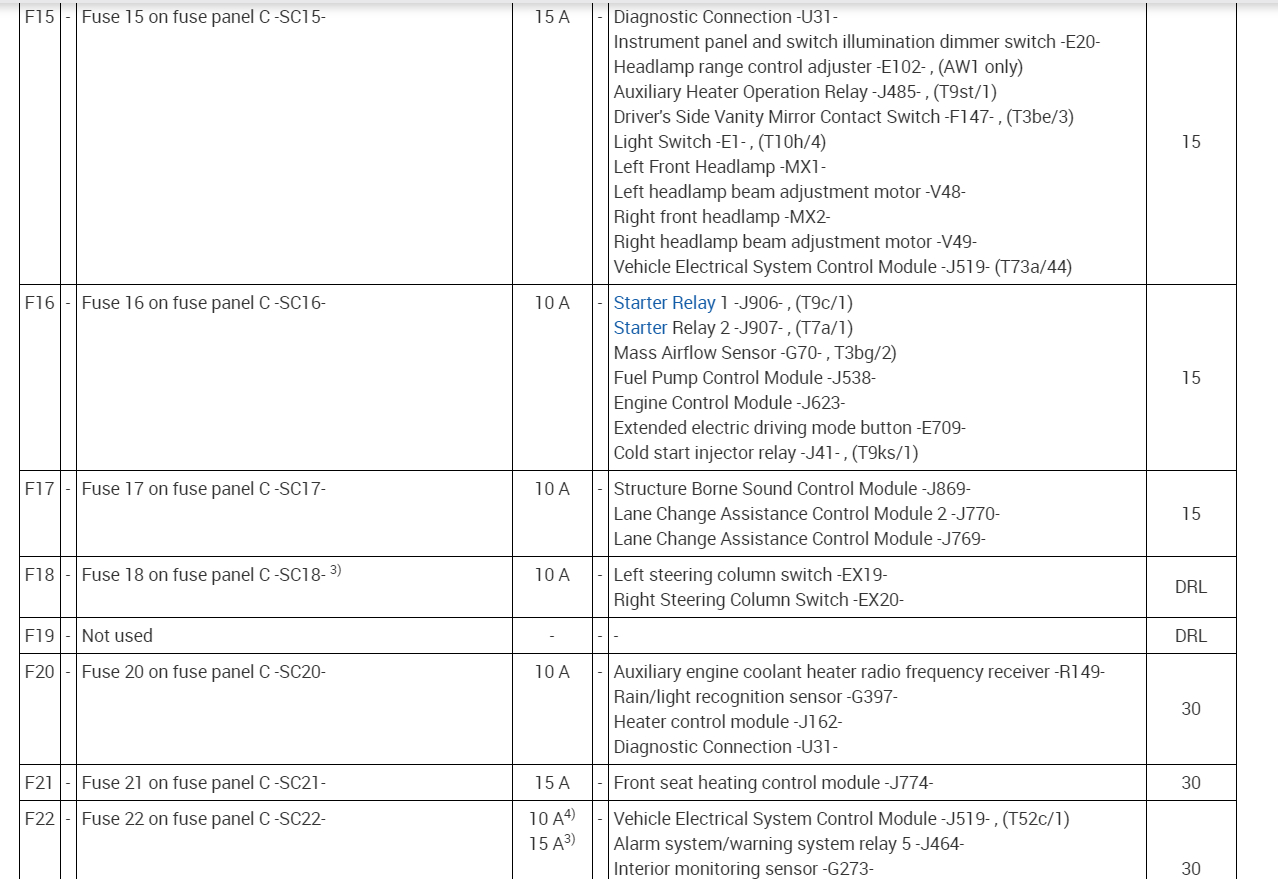

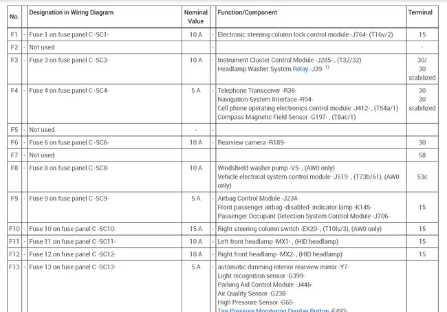

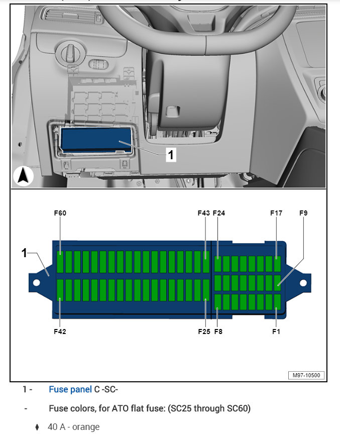

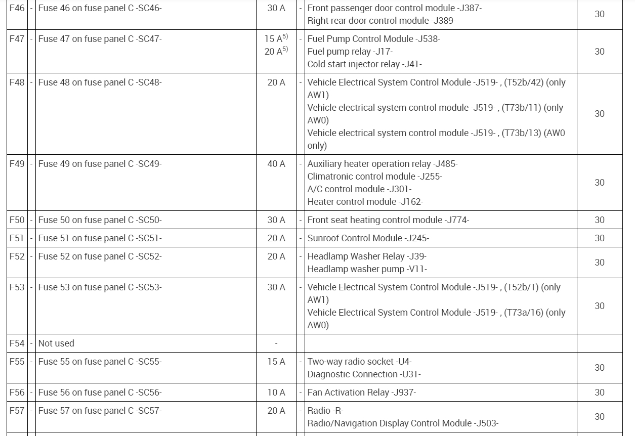

Do you have power at fuse #51? here is a guide to help you check and the sunroof wiring diagrams so you can see how the system works with the fuse location as well:
