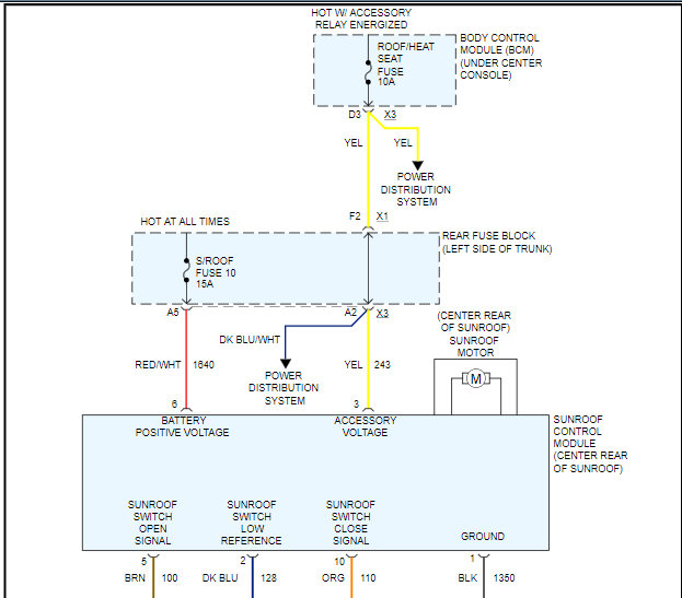

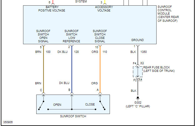

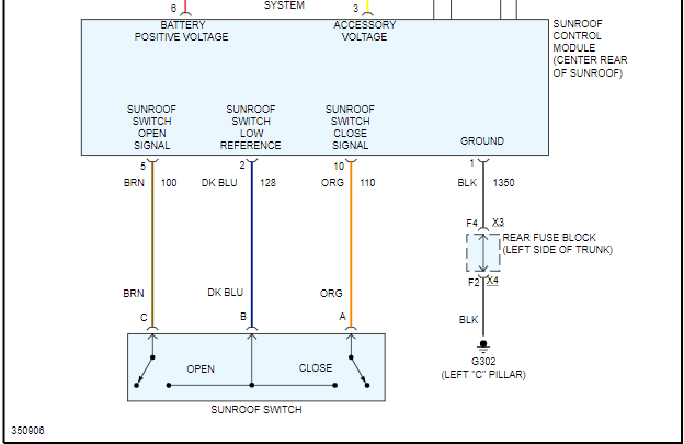

For the pass weeks my sunroof would not open. when i click the switch, a clicking sound is heard on the back of the sunroof. Also the fuse on the interior lights keeps blowing off. Im thinking there is a short somewhere.

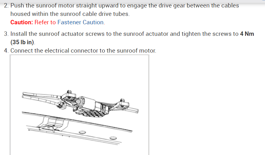

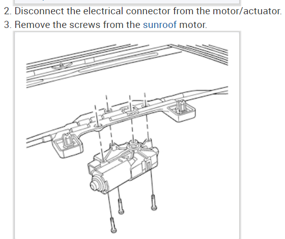

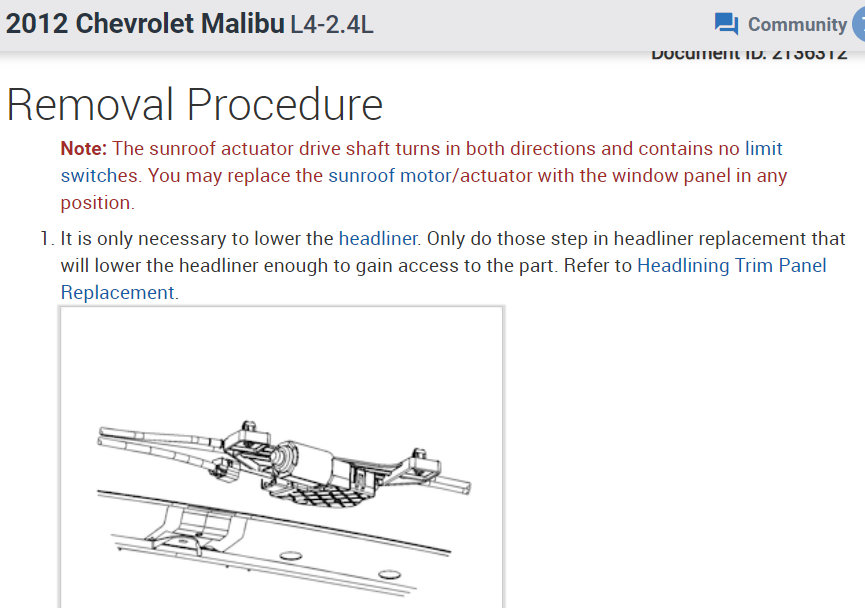

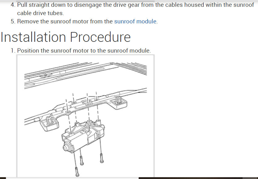

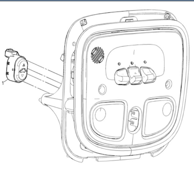

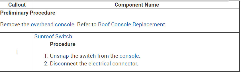

I tend to agree with you thinking there is a wiring short. Here is a tutorial showing how to test wiring:

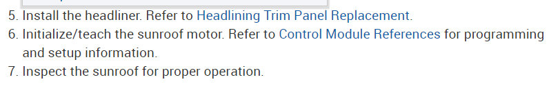

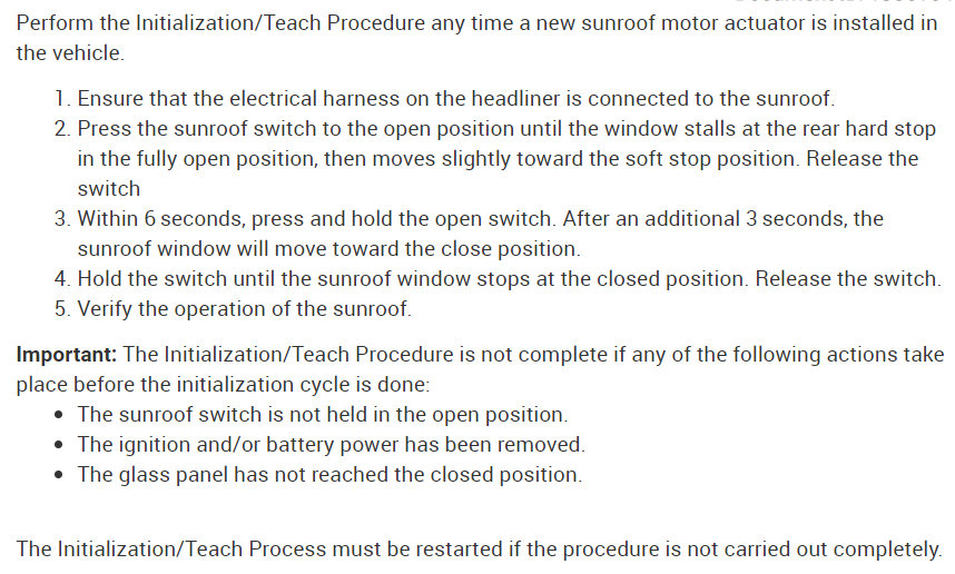

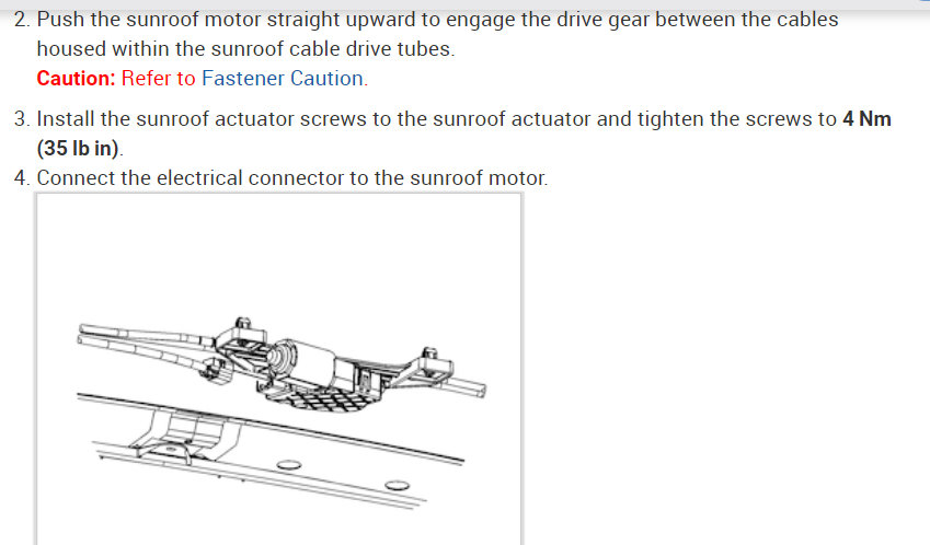

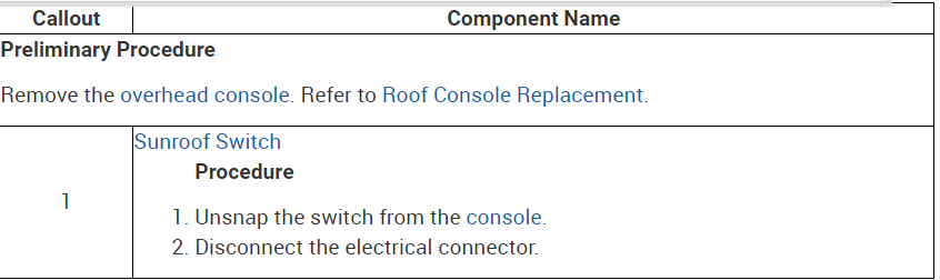

I've attached a wiring diagram below of the sunroof circuit for your car. I've cut the pictures in half so you can view larger. I've also included picture steps on how to remove the sunroof switch and sunroof motor. Hope this all helps and thanks for using 2CarPros.
