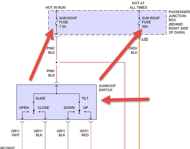

My sunroof wont open, it does not even make a sound when you push the buttons and the air conditioner is blowing hot air.
Aug 12, 2016 at 6:26 PM
HMAC300
  • 48,601 POSTS
check fuses then see if power goes through the switch it may be the unit itself which a mechanic would need to look at . see picture.
