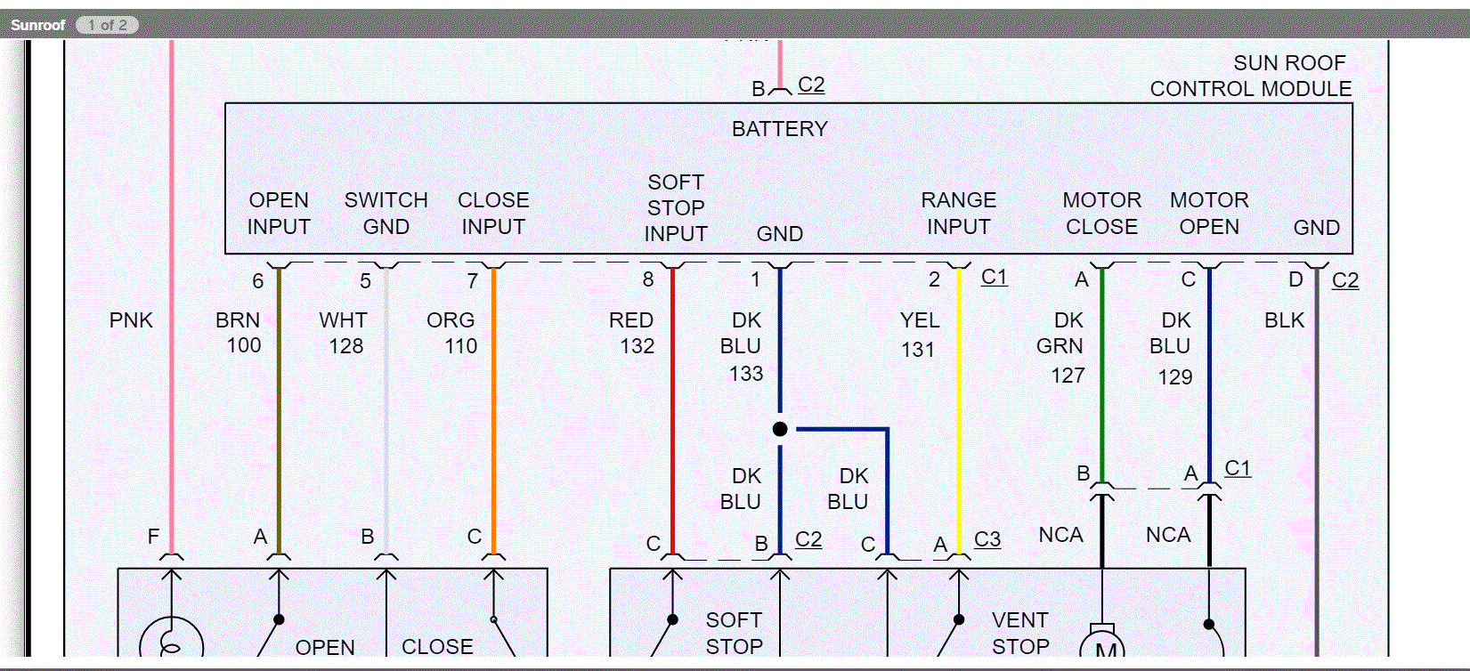

My sunroof is stuck. can you please tell me where is the fuse for it located?
May 17, 2021 at 9:03 AM
  • 110,244 POSTS

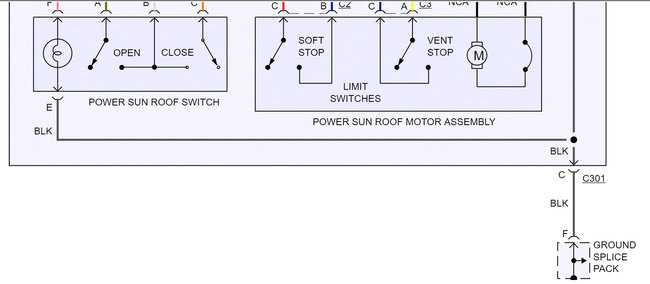

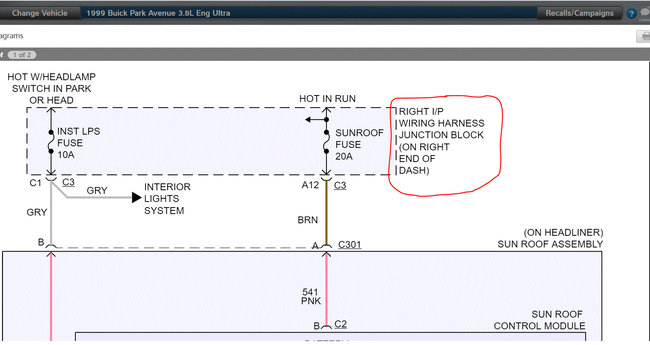

I attached the wiring schematic for the power sunroof below. The fuse is located in the fuse box at the right end of the dash.
I had to cut the schematic into three pics to make it readable.
When you check it, confirm there is power to it in addition to just checking the fuse. Here is a link you may find helpful:
