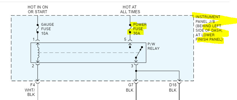

How do I disable power to sunroof so it can't attempt to open?
Nov 15, 2023 at 7:44 AM
MONSTERTRUCKDADDY
  • 31 POSTS

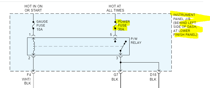

Depending on why you are doing this... the most straight forward way to disable the sunroof would be to remove the fuse and/or relay that supply power to it.
Instrument panel fuse box behind left side of dash finishing panel... Diagram attached.

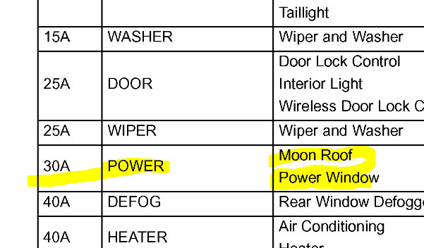

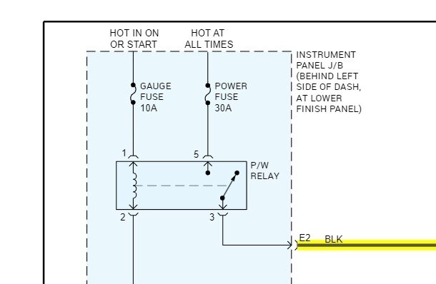

I just tried to find the power supply to the moon roof. The only thing I am able to locate is that the moon roof gets power from the power window fuse.
The fuse is in the interior fuse/junction box. See pics below. If that fuse is removed, the power windows won't work, so I don't feel that is a great choice.
