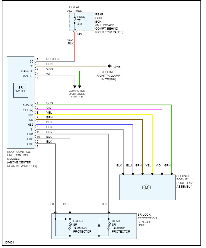

Sunroof wiring diagram needed?
150,000 MILES • V8 • 2WD • AUTOMATIC
DOLLABILL25
  • 49 POSTS
I was just wondering if I could get a wiring diagram for the sunroof switch. What's up on the ceiling and has the two lights with it I just need to wiring diagram for I guess all that right there. thank you

Here are the sunroof wiring diagrams and a get to help you check the connections.
Check out the images (below). Please let us know if you need anything else to get the problem fixed.
