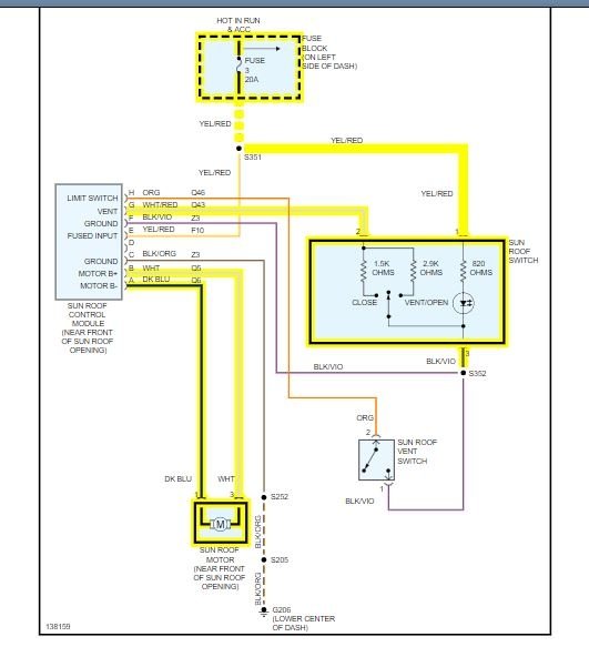

The sunroof doesn't work it clicks when you hit the button but I think it's just the button clicking not the motor what can I do to manually check it?
Jun 3, 2020 at 3:12 AM
Good afternoon,
This could be a bad switch, bad motor, or module.
I attached a wiring diagram for you to view. If you have a test light we can do some basic checks.
