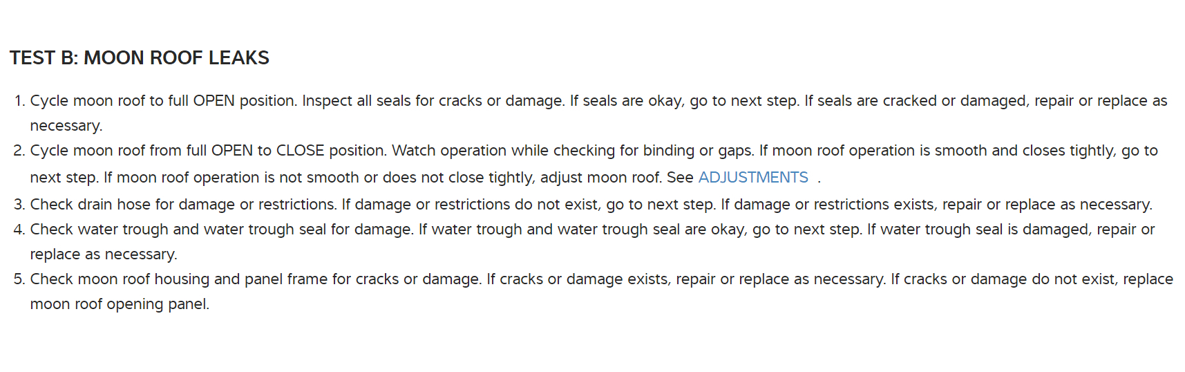

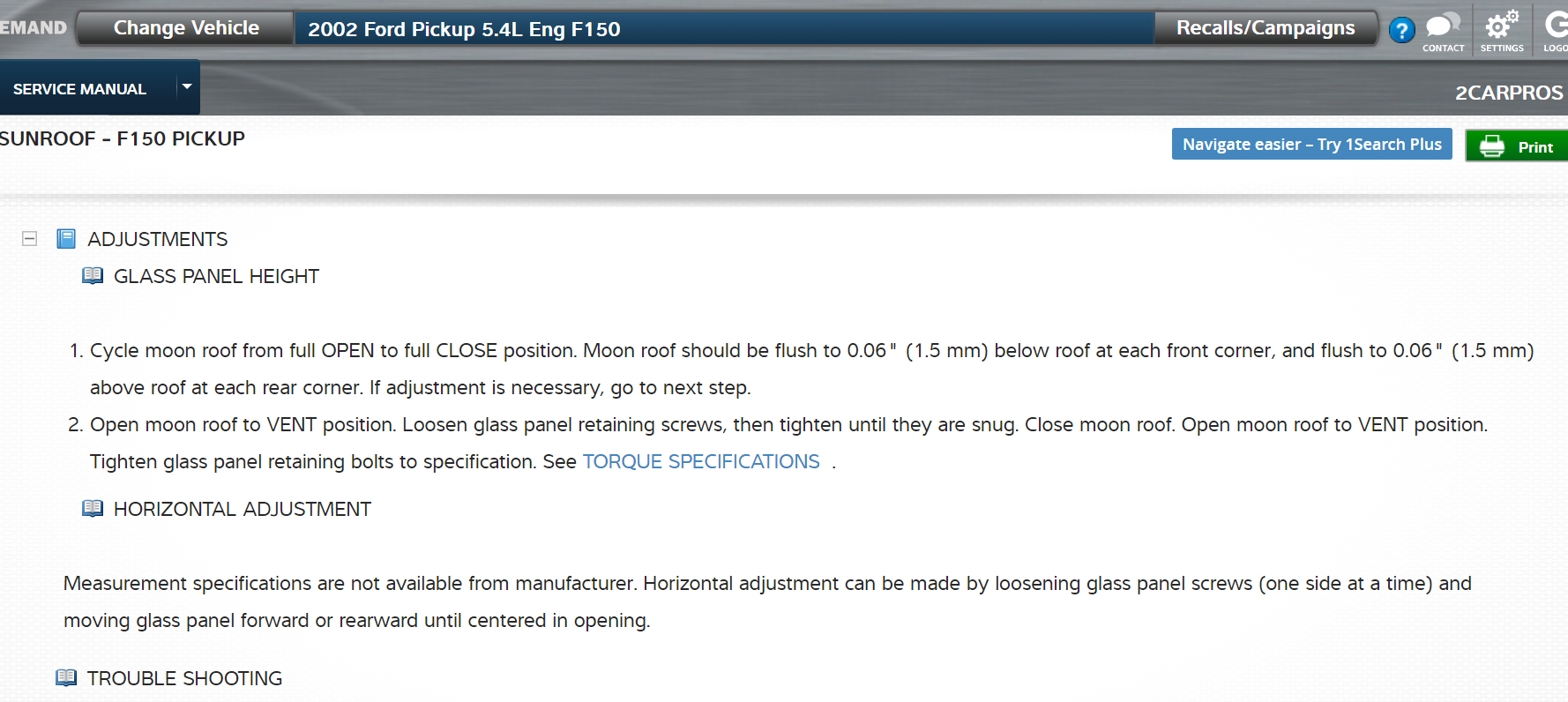

Window does not seal tight at one corner. Is this repairable? If not how much can I expect to have it replaced?

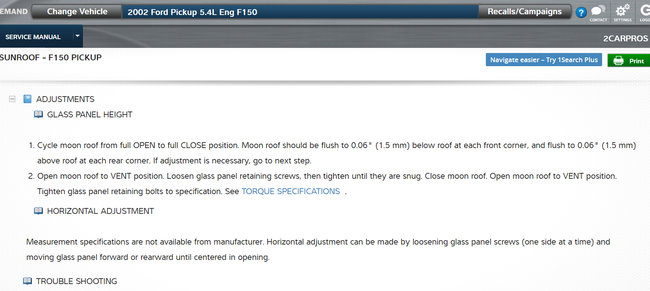

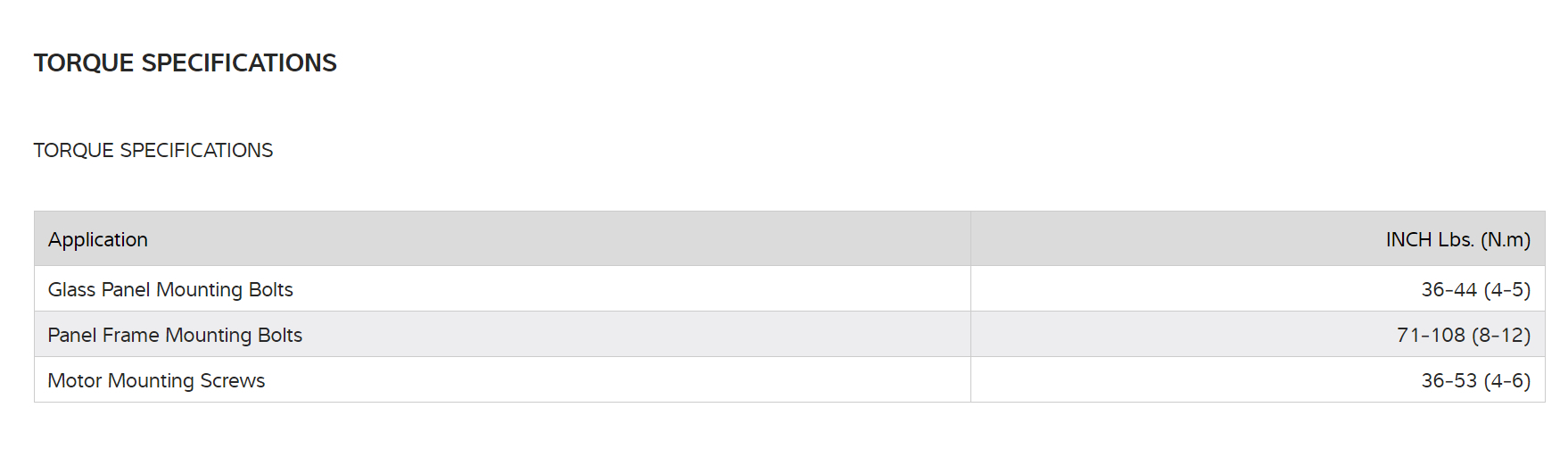

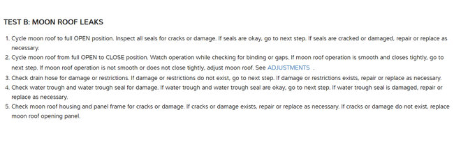

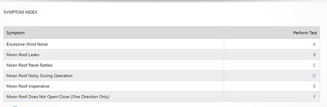

It is repairable, and the ,good news is I have included all the information you need to fo so in the diagrams down below I have included how to make adjustments to the sunroof, torque specs, and a troubleshooting chart for sunroof leaks, and how to fix them.
Please go through this guide and get back to us with what you find out.
