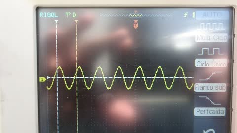

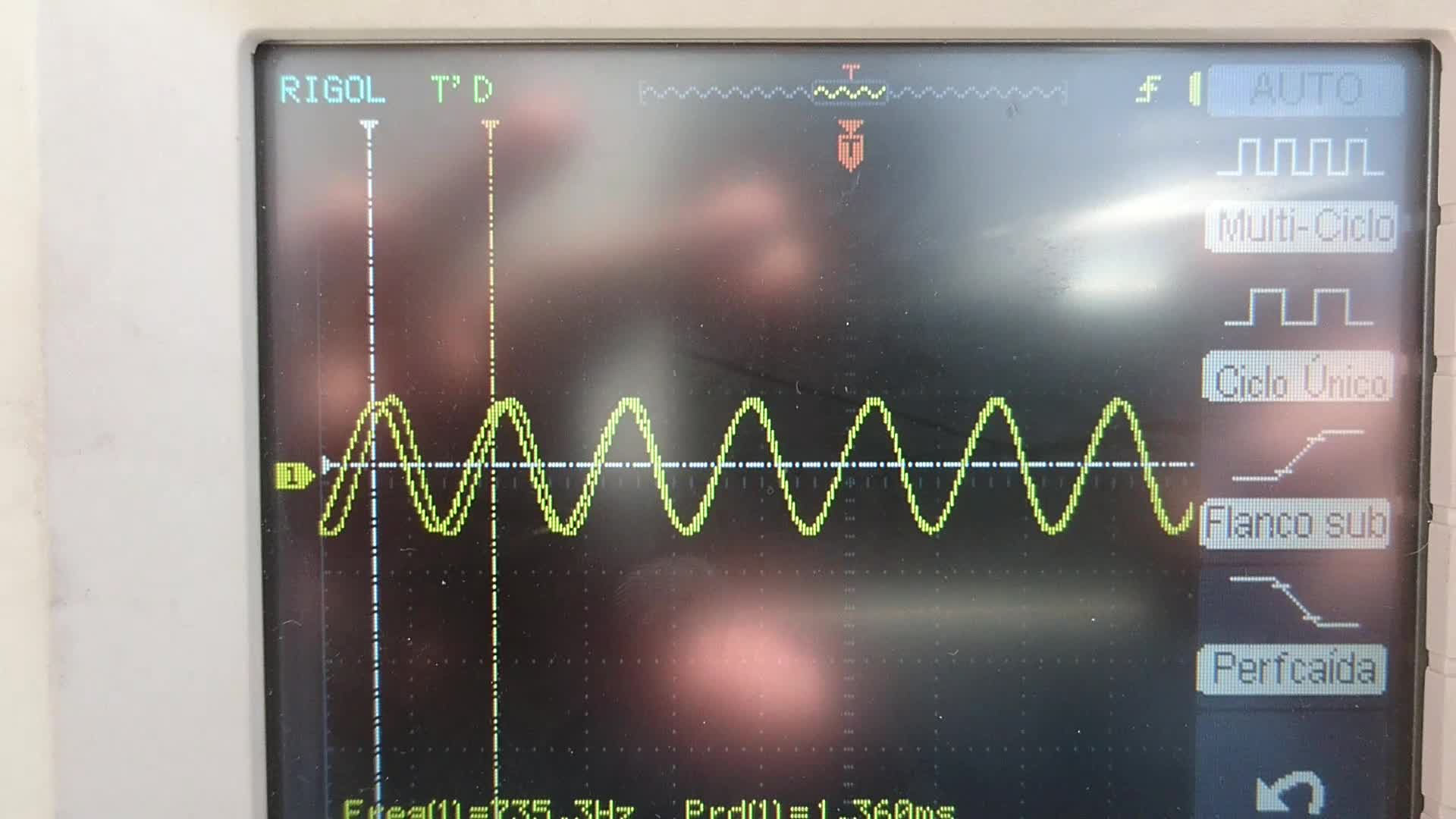

Coming in late in the game here. What were the results of your testing with the scope? Can you post a picture or video of the scope trace while revving the engine up to 2500+? Also, we would not have the schematics of the ECU to be able to identify the driver transistors for the injectors in the ECU. And also can you confirm that you are still receiving those same codes (P1336 and P1337). The next step in my mind would be to probe each of the injector signals coming from the ECU. If you have a four channel scope you could do them all at once. I would like to see a scope trace of that as well if you are able.

Hello there, yes I can send you the video. We have tested with a multi-meter at the output of each injector so what happens is after 2,500 rpm's, one of the injectors gets 12 volts on both terminal making potential difference of 0 volts and hence the injector stops working. All is see that the culprit is the ECU.

Okay, the sensor waveform looks just fine. That is what I would expect to see. See my last post =)

The waveform I have sent is from the output of crankshaft sensor. Which looks okay and as I accelerate, I see that the frequency increases means to day that the wave form has the same amplitude but the waveform squises.( obviously) . If you take a look at the video I do see some interference in the waveform, I was expecting it to be pure. Anyways, the wire harness to the injector looks okay. And I will put the oscilloscope on the output of the injectors as you asked me to do. Even though the result that we got from multi-meter was that the injector gets 12 volts on both terminal and hence it stops working, which looks like the ECU injection drive Bosch 30566 is the one which can make this happen. What do you say?

Yes, I did see the interference on the scope trace. By the way, I have a Rigol scope too, 50 mhz 2 channel. Love it! Saving up for a nice 1Ghz Mixed Domain (I do a lot of EMC work). I would attribute the interference to just having inserted a nice Dipole antenna in the circuit! Nothing to worry about there. And yes you would expect the frequency to change with engine RPM so all looked good there.
