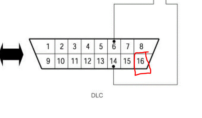

Try to start no crank then after I disconnected battery lead the car cranks but not starting. I am try to connect scan tool but all time I try it gives me no communication . And now sometimes crank but no starting and sometimes no crank just the dashboard on. Check engine light off all time not came on when dashboard on. Thanks for your time .engine 2000cc Doch.

Since this seems to be an electrical issue, I was always taught to start at the source. First, are the battery terminals clean and tight?
Next, I need you to check pin 16 in the data link connector (scanner connector) for 12v power. It should have power at all times. See picture 1.
Now, I would like to go through schematics related to starting, but I need to know if you have a push button (smart key) or not.

My battery is in good condition and I clean and tighten the battery lead good
About obd2 I can to enter for body control ABS, airbag, but my scan tool not communication with engine and transmission ECU. they in the same control box in this car for sure I have 12 v dc in pin 16. I am check for voltage in spark plug no power and no power in fuel injector plugs. I feel that my engine and transmission control unit failure. what you think sir? Thanks so much for your help.

It's possible, but unlikely that both have failed at the same time. Have you confirmed both a chassis ground on pic 4 and a signal ground on pin 5? Have you checked fuses?
