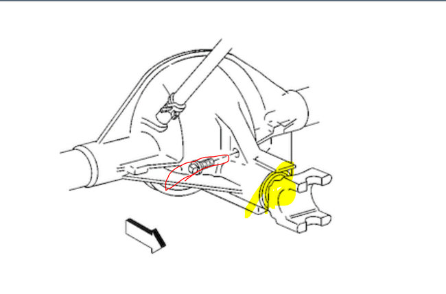

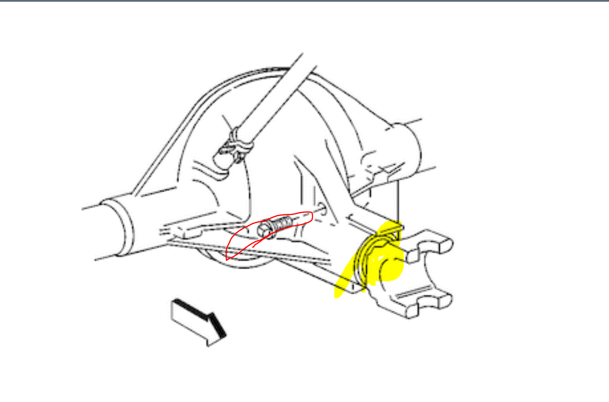

The sound certainly sounds like a bearing. Now, you said it seems to be coming from the rear. Do me a favor. First, look behind the tires/wheels on the rear and see if anything appears to be leaking. If it is in the rear, it could be an axle bearing. Most times it will cause a leak of gear lube from the differential and leave evidence.
Next, confirm the rear differential is full of oil (gear lube). I attached a pic below and circled the fill plug. It is on the passenger side of the differential. Remove the plug and fluid should be to the top of lower portion of the plug threads. Also, the part that I highlighted has a bearings and a seal. See if anything is wet there.

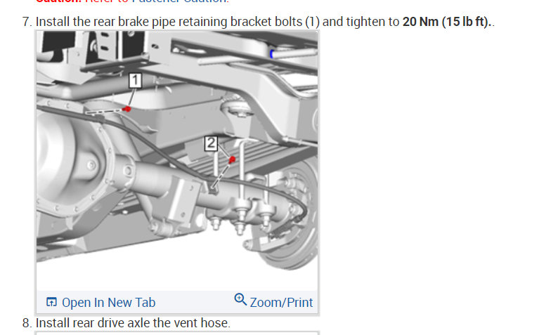

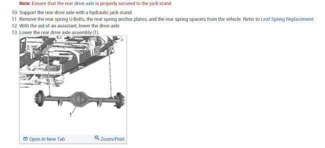

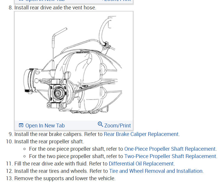

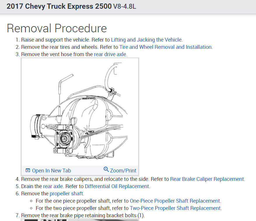

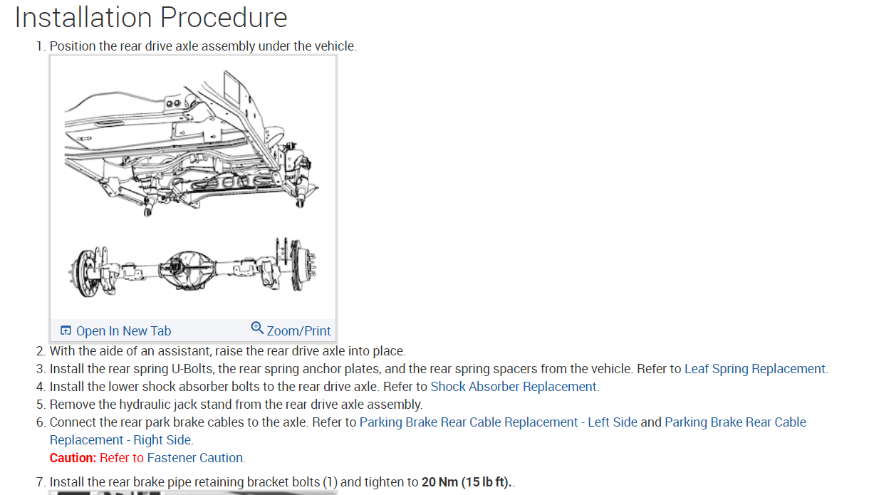

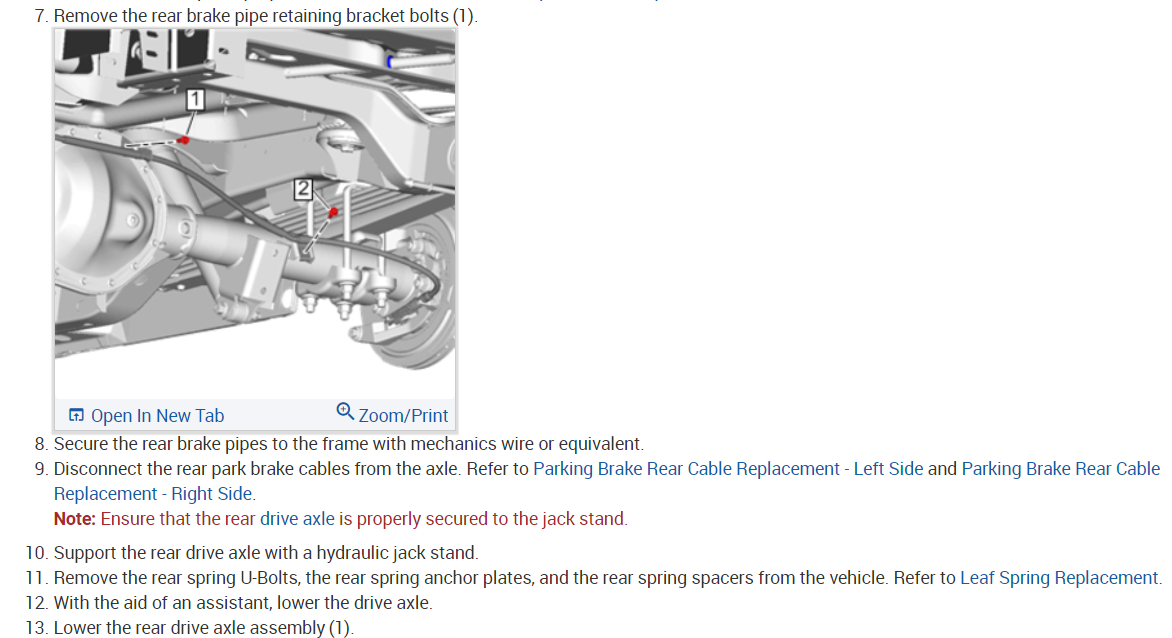

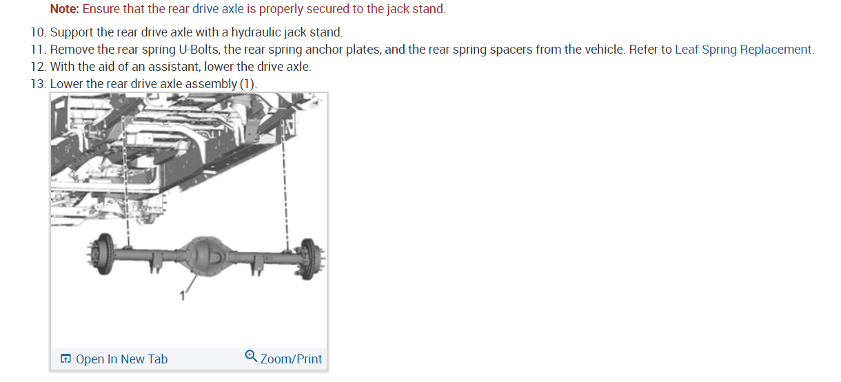

I would take it to a shop that will install a used unit would save money. the rear differentials do not go out often so used would be your best bet in my opinion. Here is the instructions on how to change out the differential in the diagrams below in case you want to do the job yourself. Check out the diagrams (below). Please let us know what happens.
