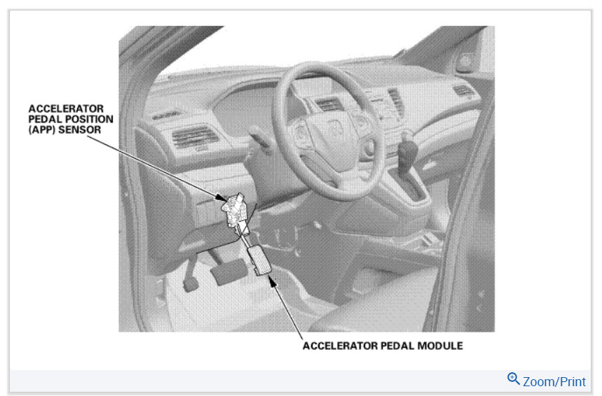

This situation with the car has only happened four times in the past year and a half but is a cause for concern. The car accelerates momentarily without stepping on the gas pedal. On one occasion I was slowing down while approaching a red light at approximately fifteen to twenty mph. I was about to apply the brakes when the car suddenly surged. I thought someone bumped me but there was no vehicle behind me. I had a couple of other close calls, once pulling into my garage and another time pulling into a parking space. Luckily each time allowed me enough time to slam on the brakes. I have read about other Honda owners with the same problem but ended in an accident. I realize with this situation only happening a few times makes it difficult to diagnose but any help would be appreciated. (before I crash)

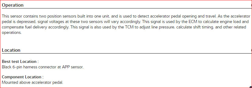

Sounds like you might be having a problem with the APP (Accelerator Pedal Position system). Most cars have a type of linkage connecting the accelerator pedal to the engine but yours is connected by an electrical system using the pedal as a potentiometer. It is also know as drive by wire. I have attached a picture that briefly explains its operation. I will do some more research and get back to you (maybe a dealer recall?). Hope this helps and feel free to ask any questions if needed. Thanks for using 2CarPros.

Just to clarify this situation a little better, this sudden surge happens when the brakes are being applied.

I have to agree with Danny L, when you hit the brakes it sounds like the sensor at the gas pedal is having a problem and giving a false signal to the computer to open the throttle. Here is the location of the sensor.
