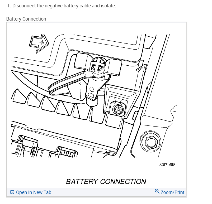

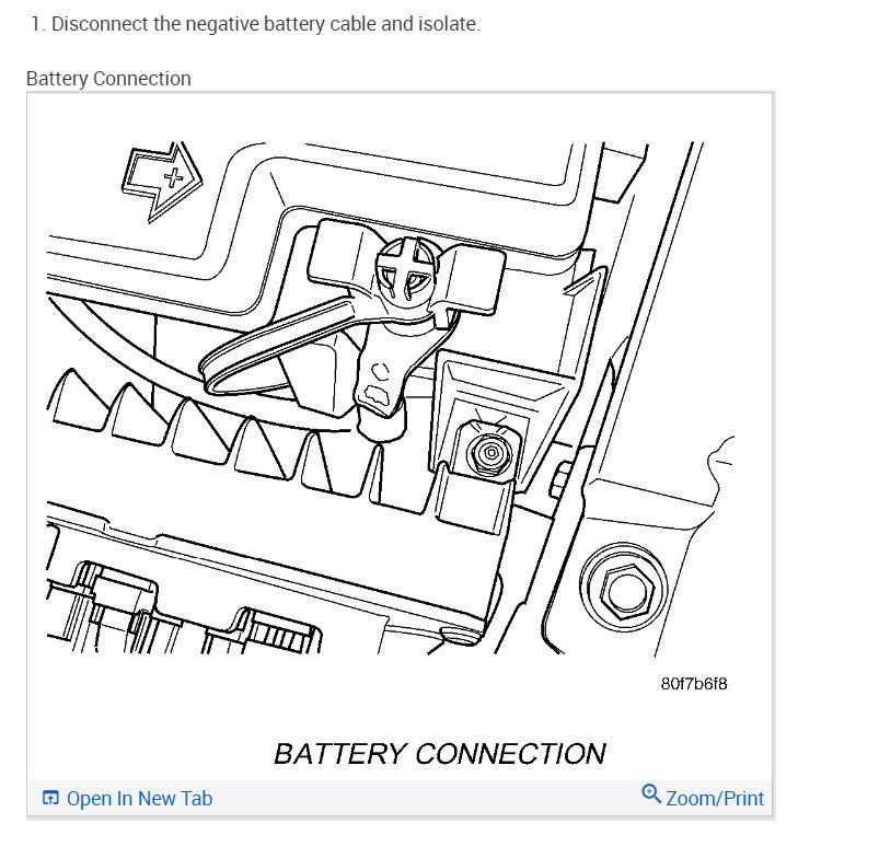

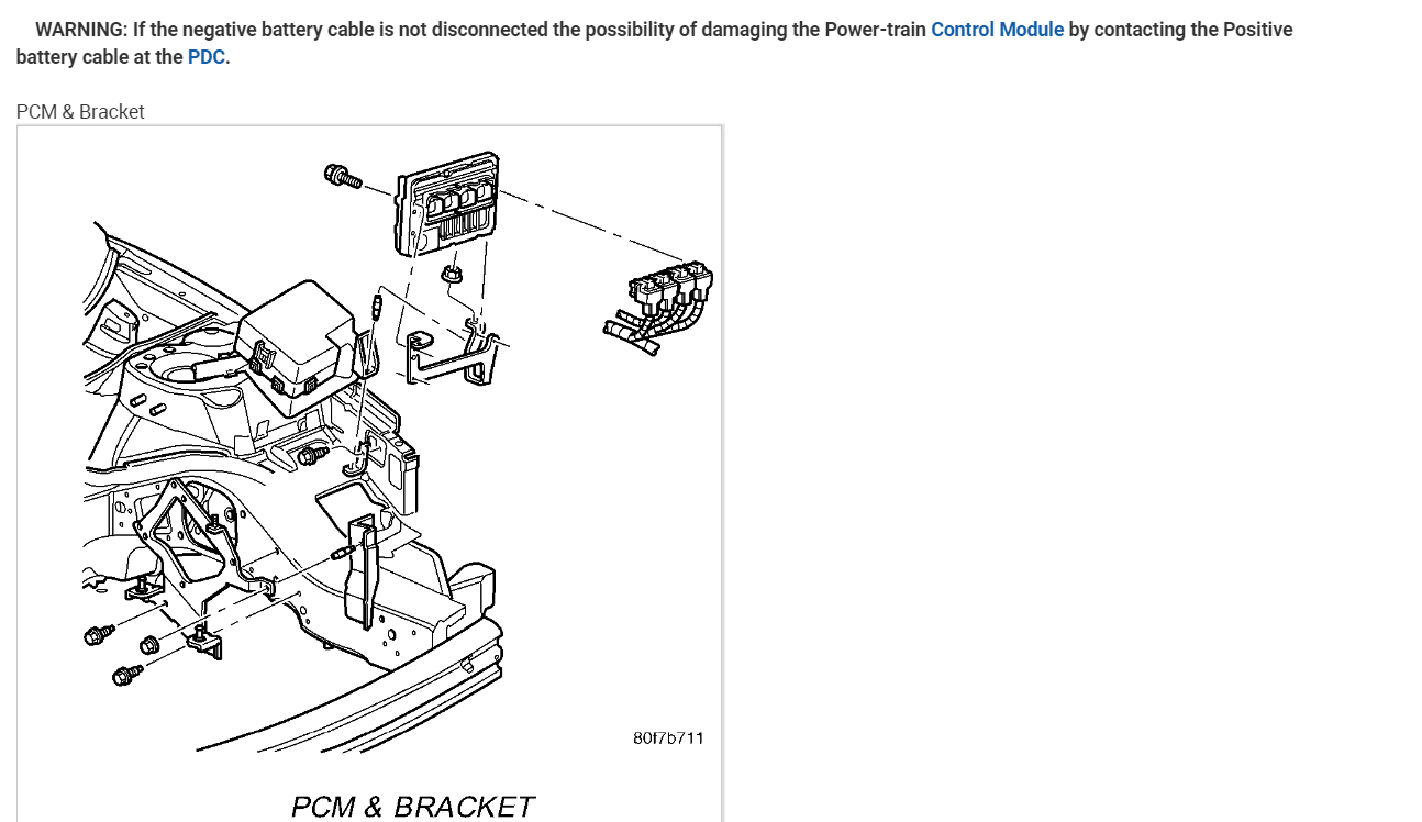

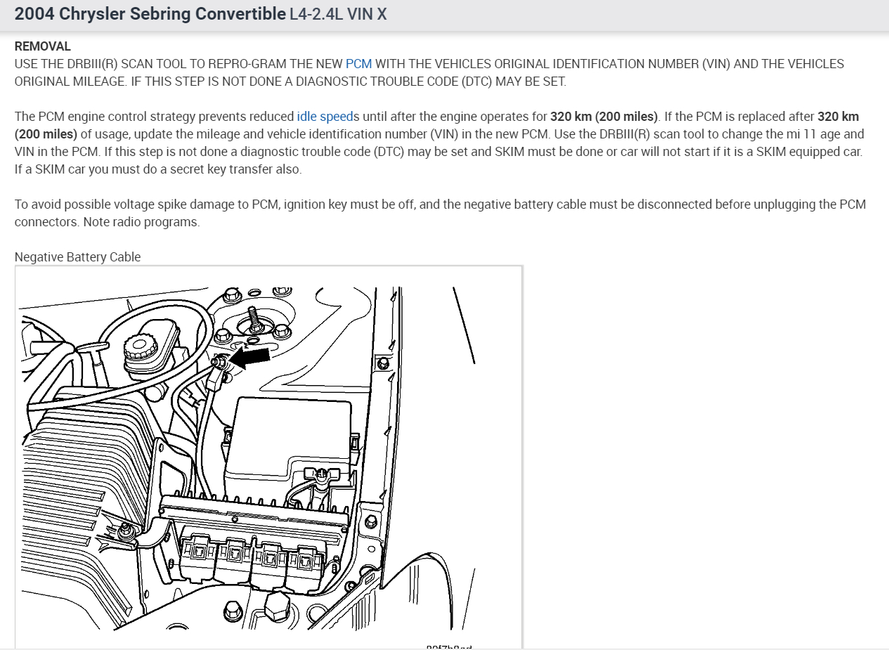

Here is how to replace the PCM just in case you need it, you can get a rebuilt PCM by searching Google or eBay have your VIN number ready. Check out the diagrams (below). Please let us know what happens.
