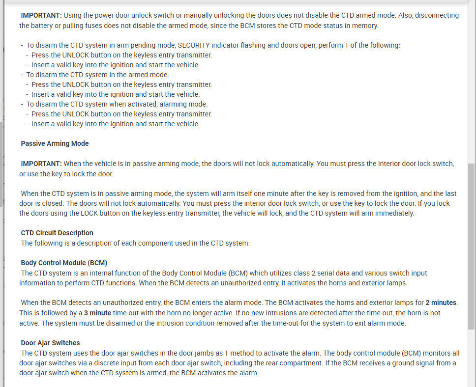

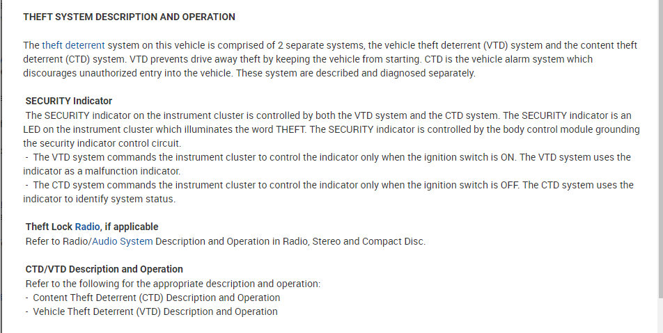

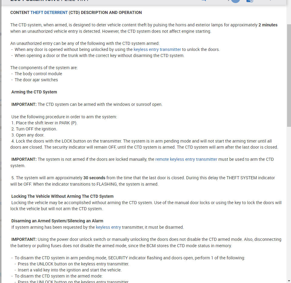

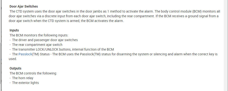

Sounds like the theft system is active which means it thinks the vehicle was trying to be stolen.
Basically you have two systems one when the vehicle has the key on and the other when the key is off.
If the theft light is on all the time then you have an issue the the system called the CTD system.
Please review the material below and let us know if you have questions. There is a part of these that explains how to disarm the system. Let's try this and see if the theft light will turn off when the key is put in the on position.
If not, try putting the key in and turning it to the on position for 10-30 minutes or until the light turns off.
