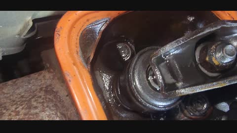

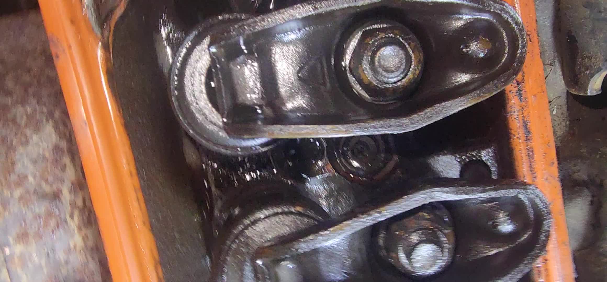

That is a bummer, but it sounds like a rod bearing has spun but to be sure let's remove the valve cover on the driver's side to look for a broken valve spring or bend push rod. Thanks for the video, you can upload the video in your replies in the future or if you have a question about what you find once the valve cover is off.

Everything under the valve cover looks in order to me. No loose rockers or broken springs. The only thing that struck me as odd was the lack of oil pooled around the springs...

Thanks for the video. The valve springs look okay, the oil pressure will fluctuate when a rod bearing has spun which sounds like what has happened, the engine needs to be removed and the engine disassembled to confirm the issue.

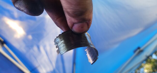

Thought I'd post an update. It was 100% the bearings. See pics xD
Feb 9, 2024 at 8:33 AM
  • 55,758 POSTS
lol, yep, that will do it, thanks for getting back to us :) Also, let me know if you need any more help getting the car back on the road.
