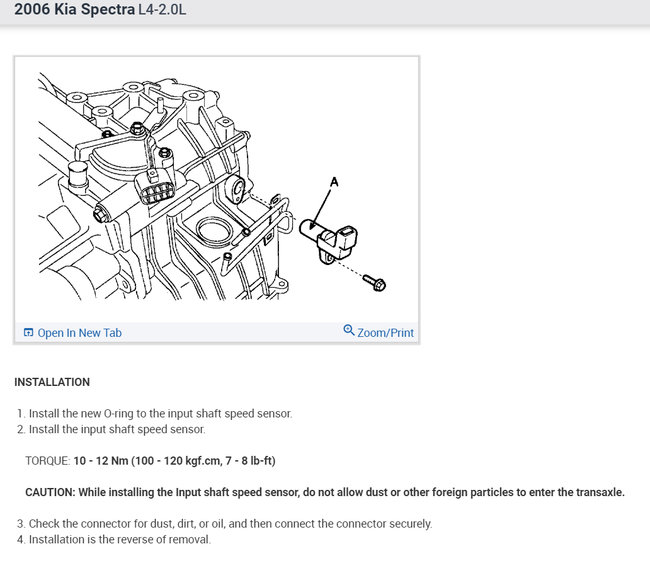

Hello. I have problem when I driving for a little bit I have some bump and gear stuck in third. I was at mechanic he change me solenoid(it was code about solenoid c). But when I drove two days i got again this problem. Also its shows me errors P0170 and p0171. Do you know what is the problem? I checked codes and it sill shows me error about solenoid c.
Jun 15, 2019 at 6:28 AM
  • 55,721 POSTS

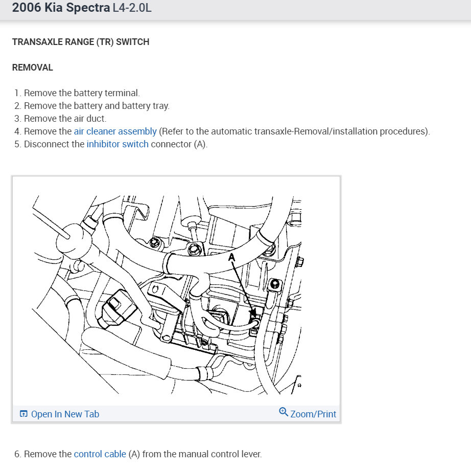

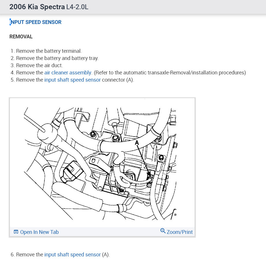

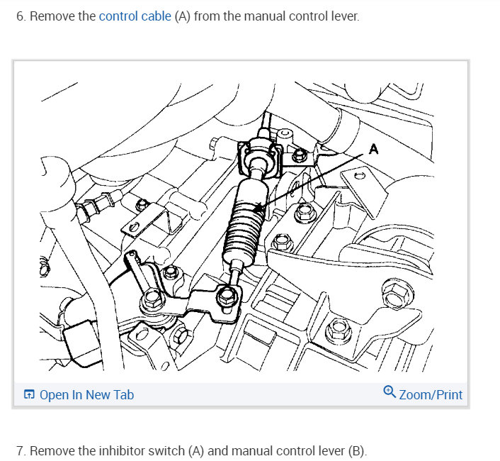

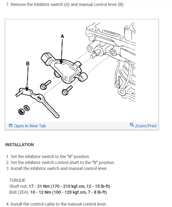

The errors P0170 and p0171 have nothing to do with the transmission they are fuel trim codes. I would check the input shaft speed sensor and the gear position sensor electrical connectors for corrosion and if clean replace them. Here are instructions and diagrams to help you find the components. Check out the diagrams (below). Please let us know what you find. We are interested to see what it is.
