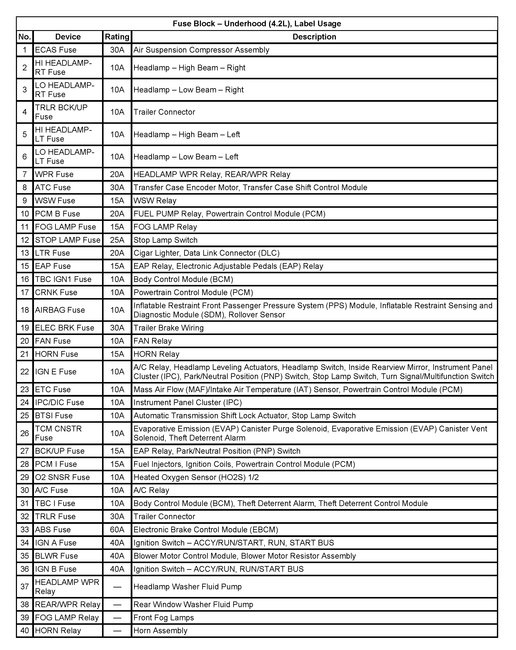

Truck will not start an cannot move shifter from park. The bushing on shifter cable was replaced still not working. What is next to check?
Oct 12, 2018 at 9:07 AM
  • 110,244 POSTS
First, is the engine starter turning the engine in effort to start? Also, I need you to check of the brake lights are working. The park interlock solenoid is powered via the brake light switch. If they are not working, it could be a blown fuse or a bad switch.

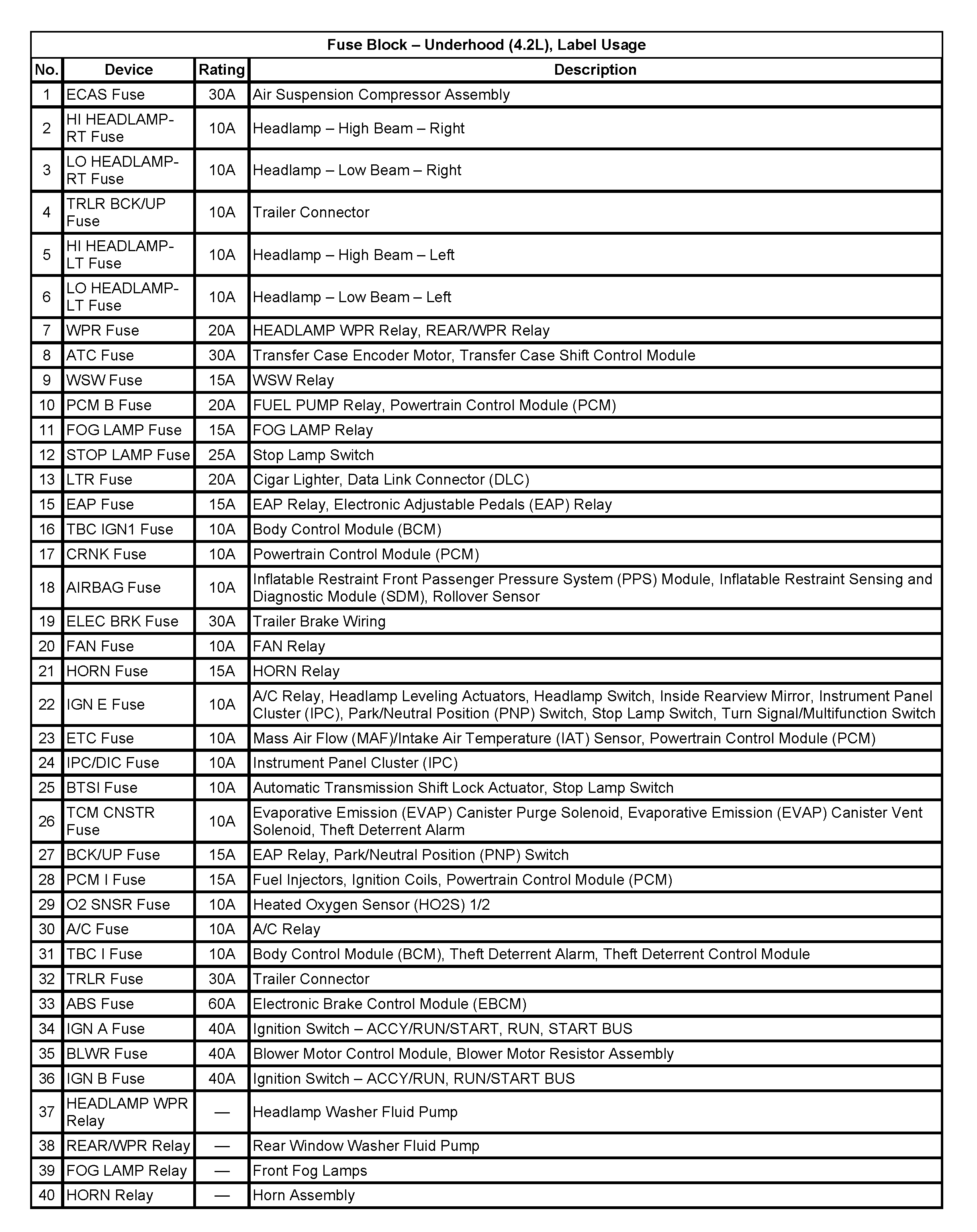

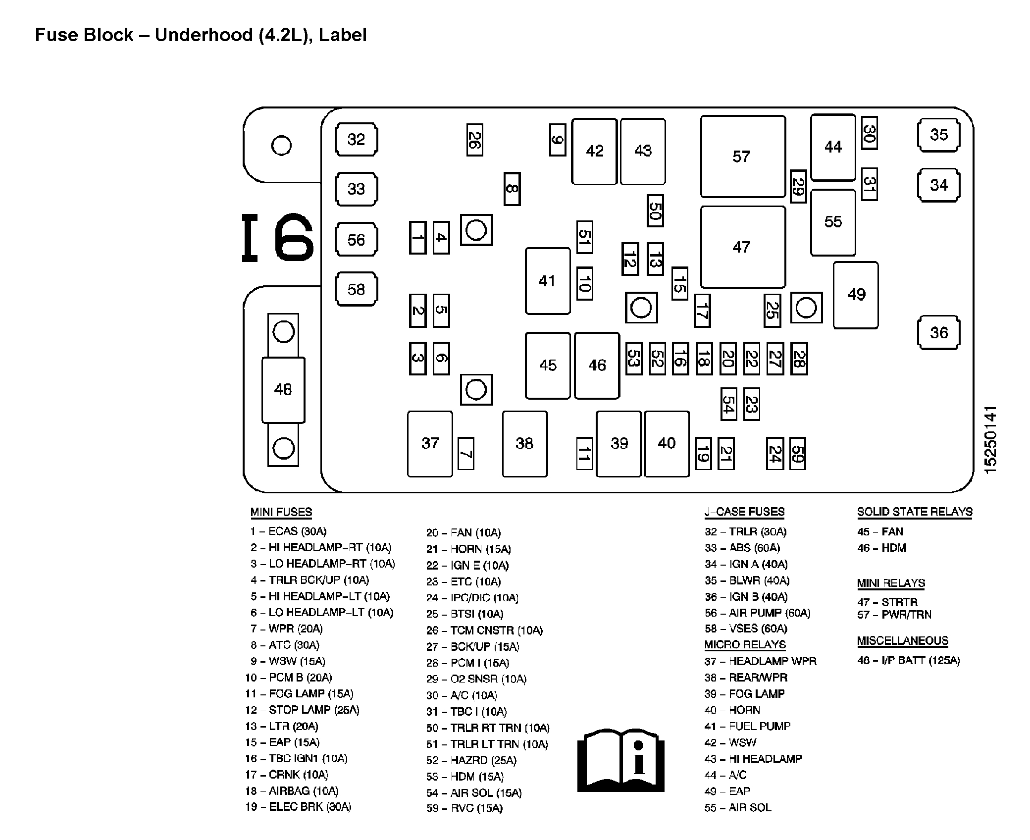

Next, I need you to check fuses under the hood in the power distribution box. Check fuses 22, 34 and 36. See attached pictures.
If when you turn the key, nothing happens, I suspect fuse 22. Fuse 22 powers the brake lights and the park/neutral switch. Regardless, check all the ones I mentioned and let me know what you find.

So far fuse 19 was blown 22 was good and so 34 and 36 . Battery tests fine .
Oct 13, 2018 at 7:21 AM
DAVIDBLANK
  • 8 POSTS
Could it be the ignition switch we had replaced it before?
Oct 13, 2018 at 7:44 AM
DAVIDBLANK
  • 8 POSTS
That is what it was. Thank you for your help.
