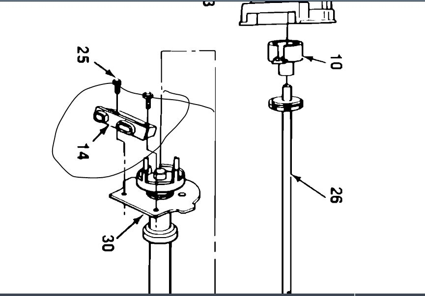

Replaced coil ran fine start stop restarted all day. Next morning wouldn't start no spark. replaced coil again started fine next morning same issue! No clue what's happening. any thoughts?

Sounds like the module is bad and also failing the coil as well.
This time, change the module in the distributor and the module at the same time.
The module is demanding max coil output. Most could not take that for a long time.

Did just that and stated right but now idle is a little rough in gear?
Sep 4, 2019 at 5:03 AM
Okay, drive it for a little bit and see if it straightens out and keeps running. Stay close in case it shuts off.
