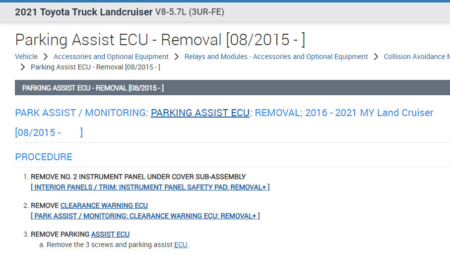

Upon conducting a diagnostic test, I received the Diagnostic Trouble Codes (DTC) C1AEC for the front sensor communication circuit and C1AED for the rear sensor communication circuit. After thorough analysis, I am inclined to believe that the issue may be related to the ECU of the clearance sensor.

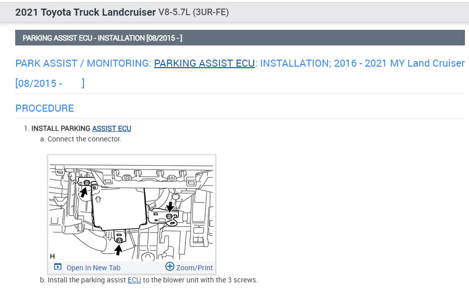

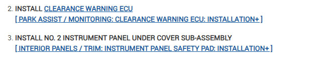

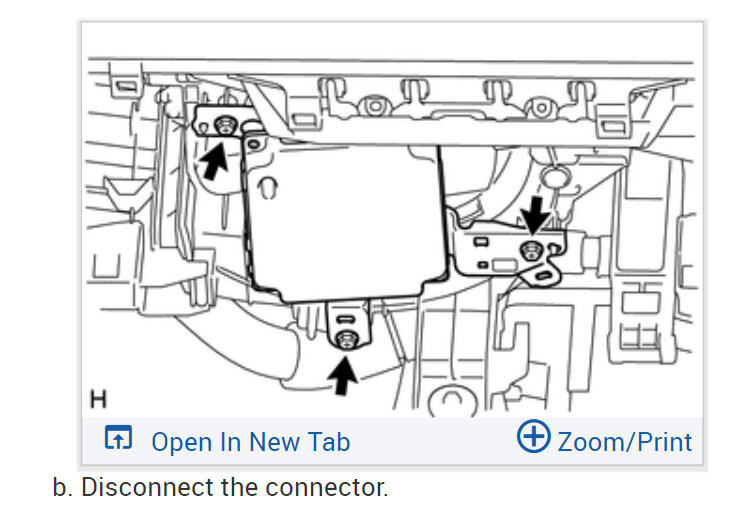

In response to this, I have ordered a new ECU for the clearance sensor. However, I am now seeking assistance on the installation process and calibration procedure. The message "Check your clearance sensor" is persistently displayed on the screen, indicating the need for further attention.
I would greatly appreciate it if you could provide detailed instructions or insights on how to properly install the new ECU and carry out the calibration process. Any specific steps or precautions you can share would be immensely helpful in resolving this issue.
