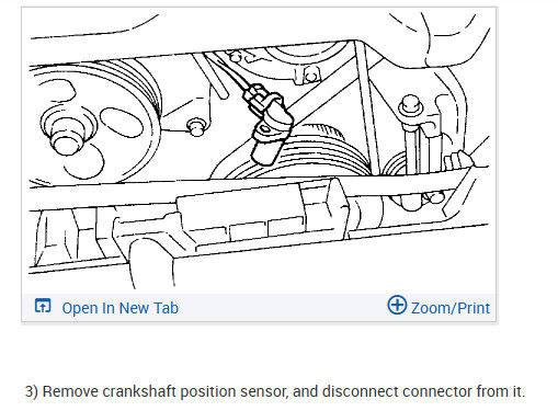

The vehicle listed above just stopped running. Took me home trying to start it, it turns it transport, won't turn change. The fuel point still has the same problem. It cranks but it doesn't turn over.

We need to determine what is missing, ignition spark or fuel.
First, see if the engine starts if you use starting fluid. If it starts and then stalls, we know it is a fuel-related issue. If there is no change, we need to check for an ignition spark.
Here is a link that explains how that is done:
https://www.2carpros.com/articles/how-to-check-for-ignition-spark

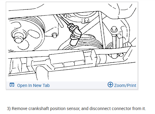

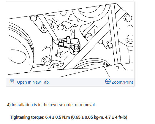

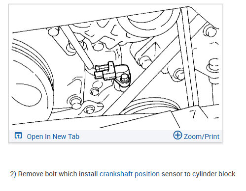

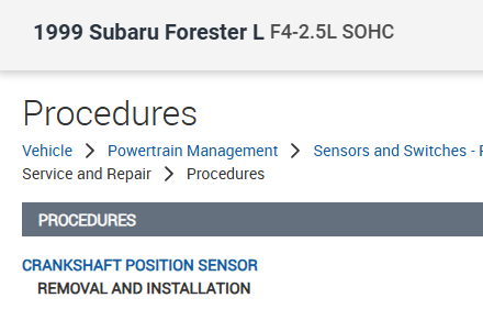

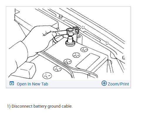

If you find there is no spark, my first suspect is the crankshaft position failed. If you get to this point, I attached the directions below for replacing it.
Also, if you suspect it sounds different when cranking, record it and upload it for me to hear. I should be able to tell you if it is a timing issue.
Let me know what you find.
