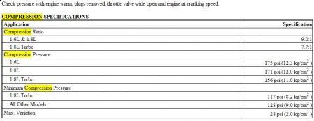

It will run for a sec, then just stop. I have to keep my foot two the floor wsith the gas pedal to even get it to do that. Befor it did that it was going real slow in all the gears and it would ask me to shift early (on the control pannel) and sound as if it needed it? can you help me out?
Nov 15, 2009 at 3:55 AM
MERLIN2021
  • 17,250 POSTS
I think the best place to start is a compression test.. https://www.2carpros.com/dia/how_to_check_compression.htm Follow this link, you migth have jumped a tooth or two on the timing belt.
https://images.2carpros.com/forum/automotive_pictures/62217_compression_Specs_1.jpg
