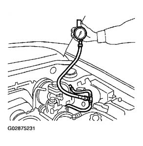

Where do I check the fuel pressure on this car?

You need to reduce fuel pressure, disconnect supply line from filter and fit in line pressure gauger see pic for general arraignment.
