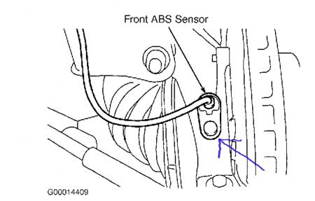

How do I remove the ABS line from the bearing hub assembly?

Remove the bolt, gently twist the sensor clockwise and then counterclockwise until it is moving. Once it is turning do the same motion while pullling. They can seze in there and break taking them out...but not always.
