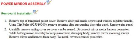

I have a replacement outside passenger side electric mirror. A small plastic cover on the inside of the door hides the screws that hold the mirror in place. I can't figure out how to remove the plastic cover to get at the screws.

Hi there,this is all i can find on the mirror replacement, i hope it is of some help. Mark (mhpautos)
https://images.2carpros.com/forum/automotive_pictures/61395_Noname_29.jpg
