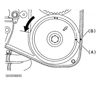

1998 Subaru Outback Timing Belt Marks/Diagrams
1998 SUBARU OUTBACK
STEVEN WINGATE
Engine Mechanical problem
1998 Subaru Outback 4 cyl All Wheel Drive Manual
Can you please tell me which of the marks on the cam sprockets line up with the marks on casing.

https://images.2carpros.com/forum/automotive_pictures/261618_Graphic_728.jpg
