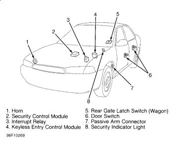

Switch
the switch that at in the door latch
open and close with the door (that tell you if the door was left open )
not the electric switch on the door that to unlock and lock the door actuator
I will try and see if I can get a picture for it
Nov 15, 2009 at 7:59 AM
BMRFIXIT
  • 19,053 POSTS
Security control module monitor doors and truck scanner can be used to check which door is causing the problem
https://images.2carpros.com/forum/automotive_pictures/99387_Graphic1_602.jpg
