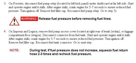

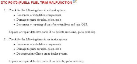

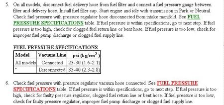

my subaru mil came on i had it checked and the codes were p0170 p0301 p0302 i know what the codes are fuel trim & misfire 1& 3 clys i changed plugs & wires fuel filter pvc cleaned maf i reset the codes the car would run ok for a day or so and than it would ilde funny it hastertate when you step on the gas with lost of power if you pump the pedel it will go and run ok until the next time it doesnt do it all the time but it set off the codes any ideas

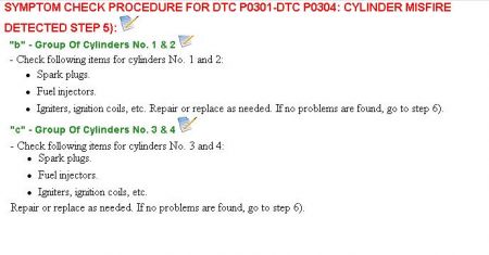

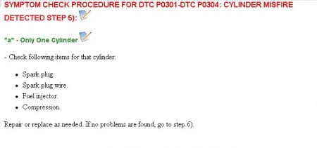

[quote]p0301 p0302 i know what the codes are misfire 1& 3. P0302 is for cylinder #2, so are you misfiring at cylinder 3 or cylinder 2?

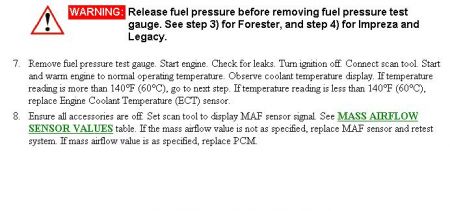

i checked exhaust no leaks i checked for intake leaks didnt find any the engine misfire on 1& 3 clys i erased the codes and it didnt come back over 600 miles but no 1 misfired after engine ran rough with no power and than the car wouldnt go so i checked the fuel pressure it readed 24 lbs with hose connected and 24 lbs with disconnected no change i think the misfiring might be caused by the engine hesitating and loss of power when you step on the gas and it would go what do you think thanks

If you look at step 5 for code P0170, if the fuel pressure is too low (disconnected), problem is within improper fuel pump discharge or clogged fuel supply line. So, before you spend money replacing the fuel pump, I would make sure that the line from the fuel pump to fuel filter is not clogged.

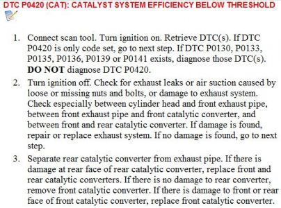

well i cant believe it i just cant believe it the catalyst monitor went to ready but quess what the check engine light came back on--- for code p0420 catalyst efficiency below threshold bank 1 (what)
this is the first time for this code i check the exhaust
for leaks no leaks up front-- but have one after catalyst convertor at the flange on the pipe side down stream--- could this have set off this code--- the car was running fine for 2 weeks ?..i. am going to change the pipe today

That exhaust leak may have caused the code to come on.

the light came on again code p0420 no other codes---no exhaust leaks ---car runs fine---- what should i do next -- there are two converter on this car -- if the catsalytic is bad do i have to replace both -- if so do you know why

I am now leaning towards possible bad converters. Especially after the exhaust pipe replacement, you may have to go to a exhaust/muffler specialist (such as Midas) and have them diagnose the code, prior to replacing the cat converters. As the damage was after the rear cat, Subaru recommends replacing both converters. I do not have any explanation for that.
