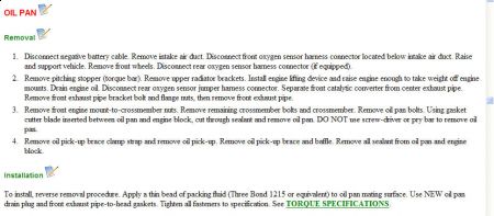

Replacing a oil pan gasket. A number of bolts are blocked by transmission assembly. Do youn have to pull the motor to do this?
Mar 25, 2009 at 2:03 AM
OBXAUTOMEDIC
  • 3,711 POSTS
Hello, Here is the removal instruction for a 2.5L DOHC. Will email also for easier reading.
https://images.2carpros.com/forum/automotive_pictures/188069_97outbackoilpanremove25dohc_1.jpg
