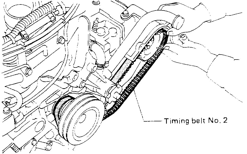

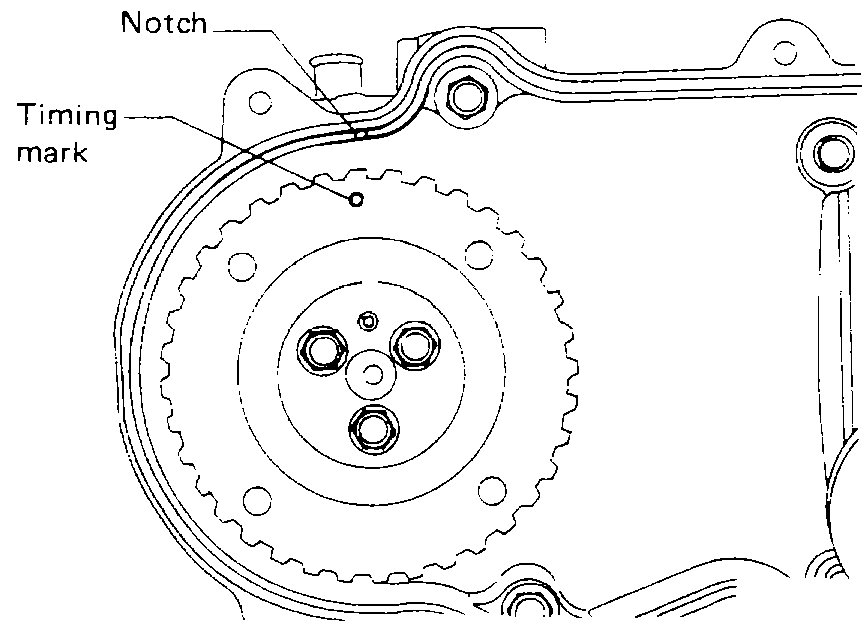

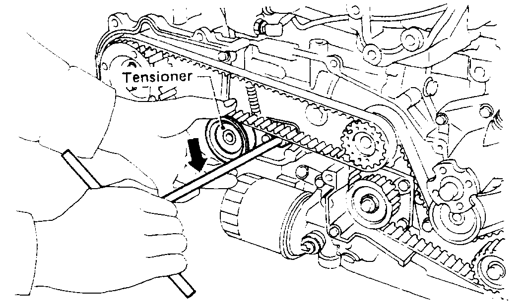

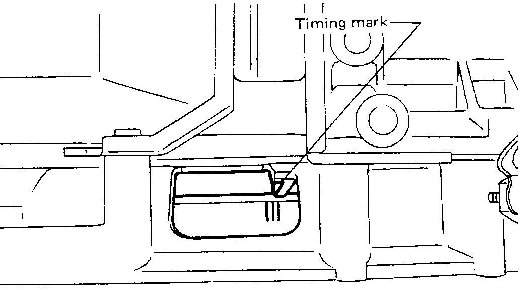

I have a 1989 Subaru Gl 1.8L 4W/Drive with around 80,000 miles on its second motor. I was driving down the interstate doing 75 mph when my rear-end locked up. I towed the car back home and replaced the rear axle. I proceeded to try to start the vehicle and it wouldn't start. I removed the distributor cap and turned the engine over and it didn't move. I have tore down the front end and replaced the timing belts. I first aligned the #2 belt with the locator on the plastic housing and the crank with the three lines aligned at the locator on the casting. I rotated the engine 360 deg. until the crank was inline again and put on the #1 belt i checked to see if the distributor was facing the #1 postilion and then tried to crank it up and if fails to start. It cranks smoothly at first but becomes sluggish like it is 180 off. Can you please help me? Lesslie.

Align the crankshaft so the middle of the three marks on the fly wheel or flex-plate are lined up with the pointer at the top back of the bell housing.Point the dot on the drivers side camshaft down to the mark on the inner timing cover.Put the passenger side Camshaft with the dot pointing up at the mark in the inner timing cover and away you should go.

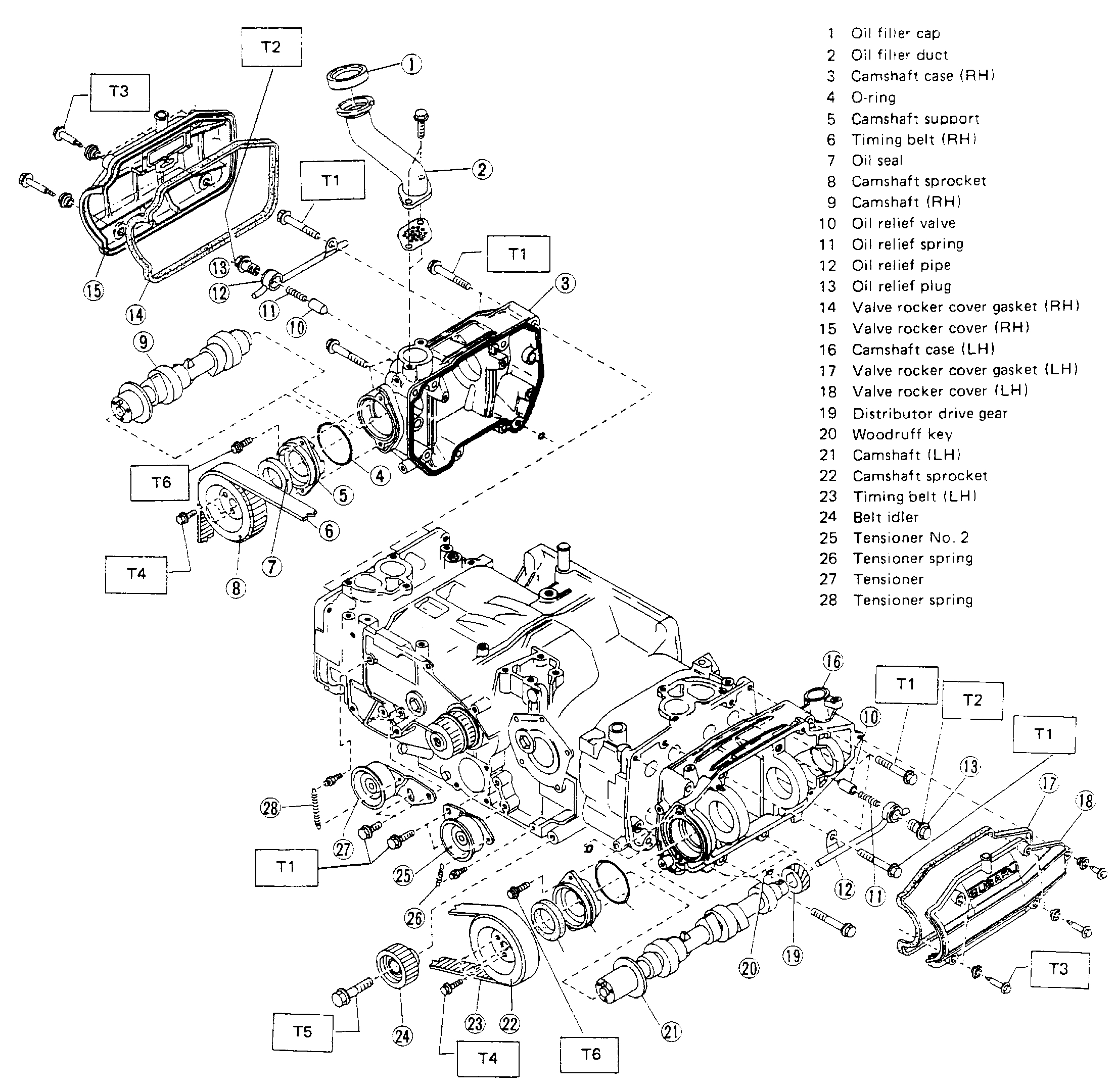

Here are the directions specific to your vehicle for timing belt replacement. It will guide you in properly setting the timing. The attached pics correlate with the directions.
_______________________________________
1989 Subaru Hatchback 4WD F4-1781cc 1.8L SOHC
Procedures
Vehicle Engine, Cooling and Exhaust Engine Timing Components Timing Belt Service and Repair Procedures
PROCEDURES
Camshaft And Timing Belt
pic 1
Tightening torque:
T1: 17.2 - 20.1 N-m (1.75 - 2.05 kg-m, 12.7 - 14.8 ft-lb).
T2: 23 - 26 N-m ( 2.3 - 2.7 kg-m, 17 - 20 ft-lb).
T3: 4.4 - 5.4 N-m (0.45 - 0.55 kg-m, 3.3 - 4.0 ft-lb).
T4: 9.1 - 10.5 N-m (0.93 - 1.07 kg-m, 6.7 - 7.7 ft-lb).
T5: 39 - 47 N-m (4.0 - 4.8 kg-m , 29 - 35 ft-lb).
T6: 6 - 7 N-m (0.6 - 0.7 kg-m , 4.3 - 5.1 ft-lb).
Belt Cover
pic 2
Tightening torque:
T: 4.4 - 5.4 N-m (0.45- 0.55 kg-m, 3.3 - 4.0 ft-lb).

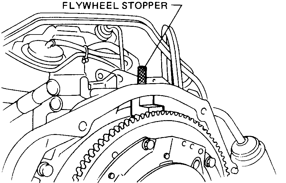

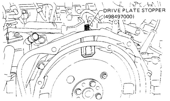

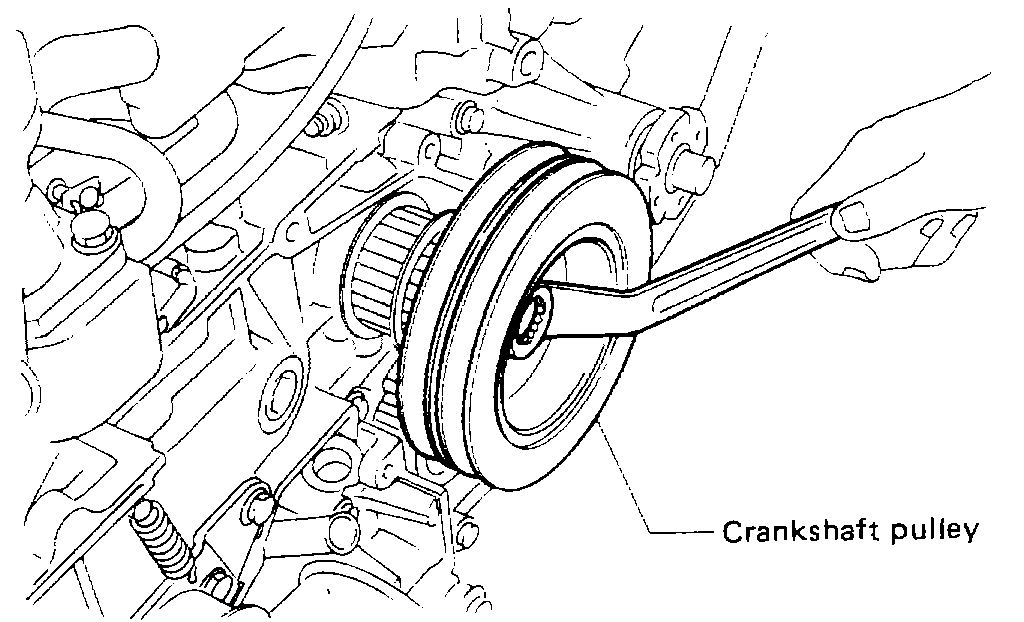

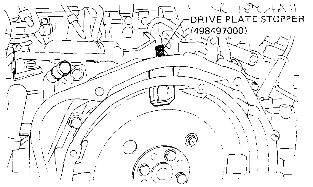

6. Remove crankshaft pulley. To lock crankshaft, use FLYWHEEL STOPPER [manual transmission model] or DRIVE PLATE STOPPER [automatic transmission model].

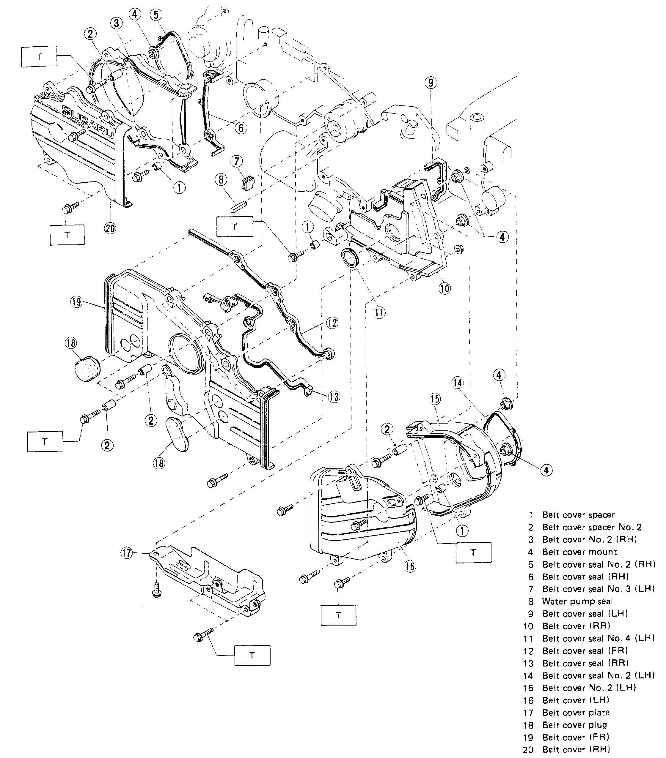

8. Remove belt covers LH, RH and FR.
pic 5

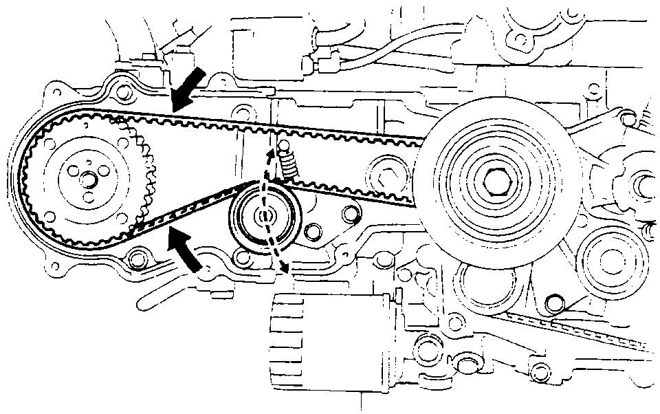

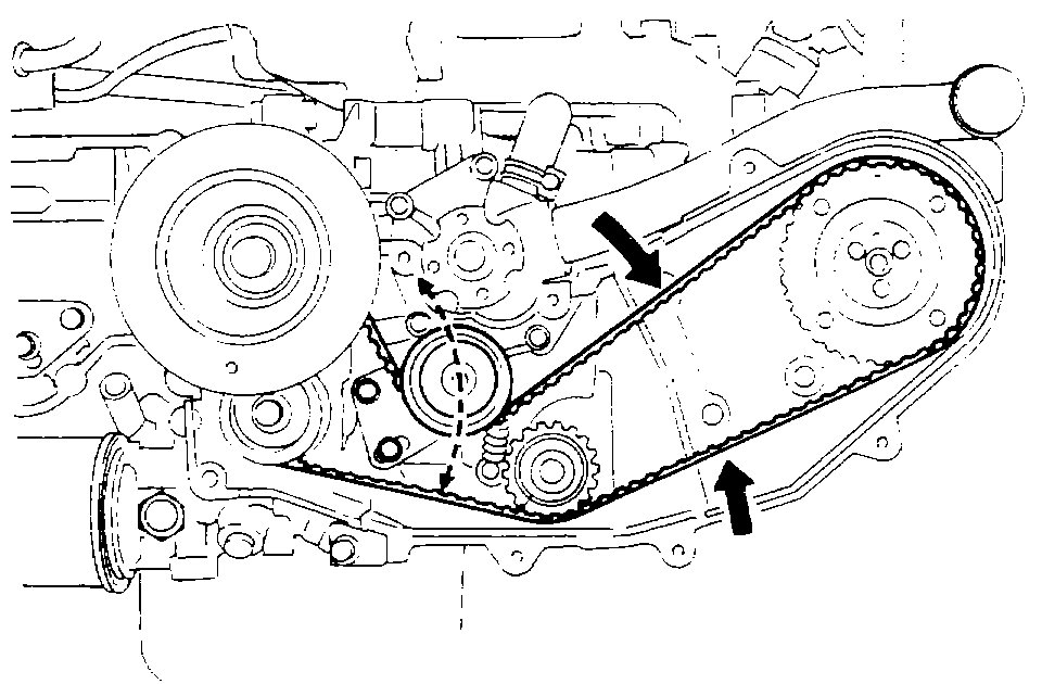

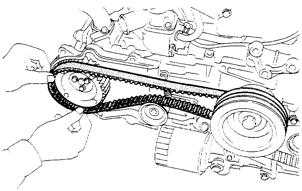

9. Removing timing belt
(a)Loosen tensioner mounting bolts on # 1 cylinder by 1/2 turn.
(b)With tensioner fully turned to slacken belt, tighten mounting bolts.
(c)Mark rotating direction of timing belt, then remove belt.

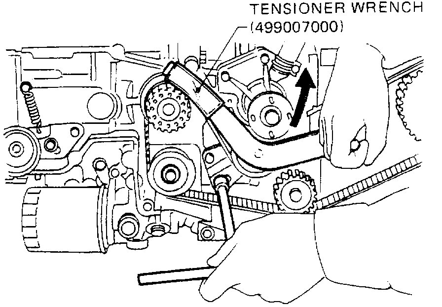

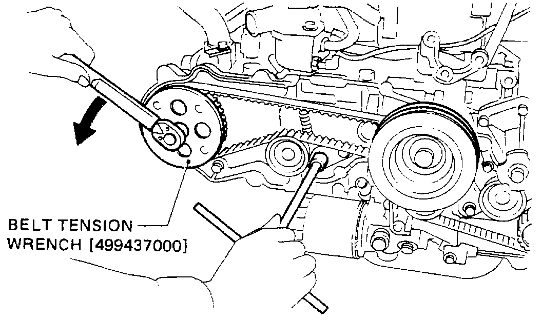

(d)Loosen tensioner No. 2 mounting bolts on # 2 cylinder by 1/2 turn.
(e)With tensioner fully rotated to slacken belt by using TENSIONER WRENCH, tighten tensioner mounting bolts.
NOTE: Cover TENSIONER WRENCH clamping tips with a rubber hose or waste cloth to prevent crankshaft or pulley from being damaged.
pic 6

13. Remove right-hand belt cover No. 2, left-hand belt cover No. 2 and belt cover RR.

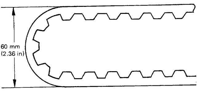

NOTE:
A. Be careful not to let oil, grease or coolant contact the belt. Remove quickly and thoroughly if this happens.

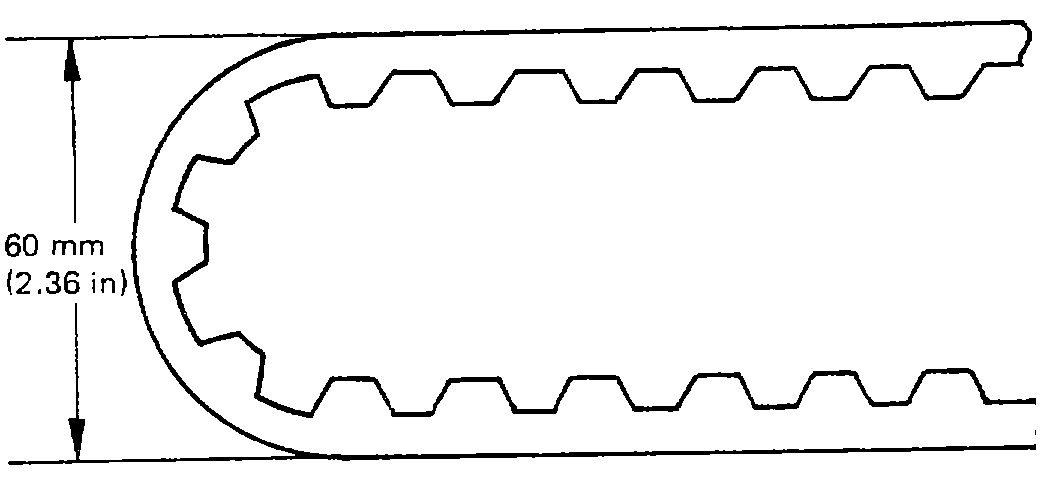

pic 8
B. Do not bend the belt sharply. The bending radius must be greater than 60 mm (2.36 in).
C. When replacing belt, be sure to replace both belts as a matched set.

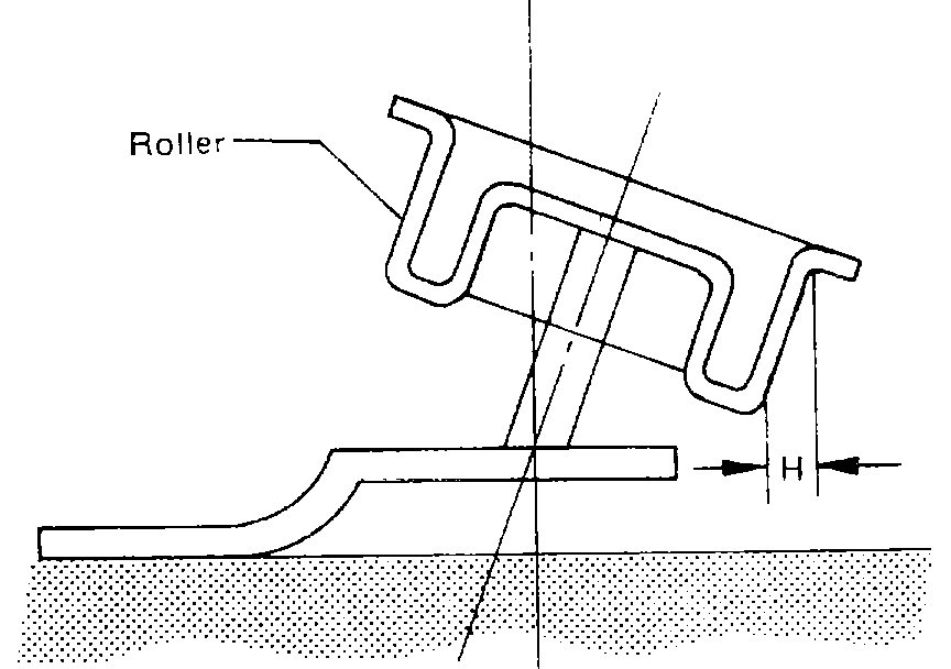

2. Measure the out-of-squareness of tensioner roller H. If it exceeds 0.5 mm (0.020 in)., replace roller.

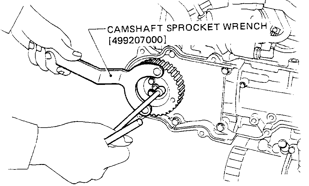

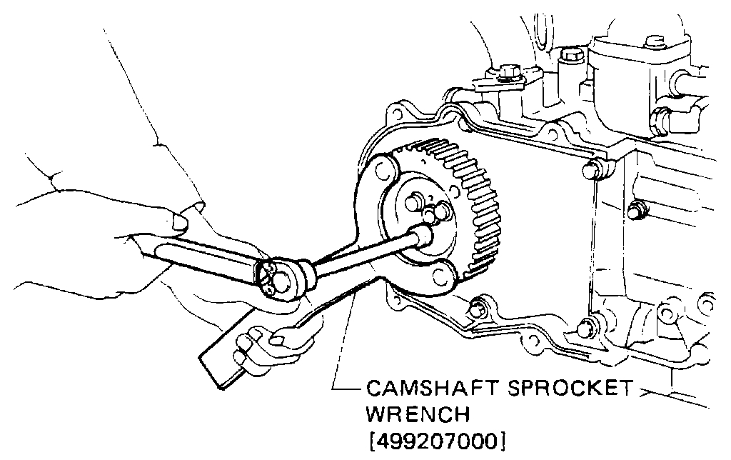

5. Install camshaft sprockets to right and left camshafts. To lock camshaft, use CAMSHAFT SPROCKET WRENCH.
NOTE: Tighten bolts gradually in two or three steps until the specified torque is attained.
Tightening torque:
9.1 - 10.5 N-m (0.93-1.07 kg-m, 6.7 - 7.7 ft-lb).

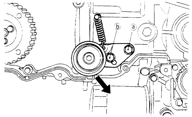

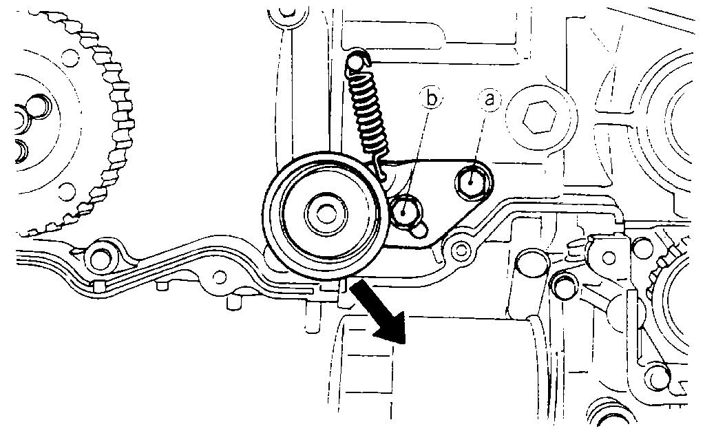

6. Installing tensioner
(a)Attach tensioner spring to tensioner, then install to cylinder block RH. Tighten bolts temporarily by hand.
(b)Attach tensioner spring to bolt, tighten bolt (A), and then loosen 1/2 turn.
pic 11
(c)Push down tensioner until it stops, then tighten temporarily bolt (B).

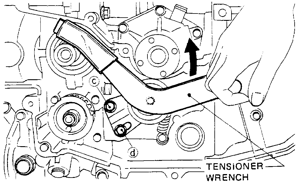

7. Installing tensioner No. 2
(a)Attach tensioner spring to tensioner No. 2, then install the tensioner No. 2 to cylinder block LH. Tighten bolts temporarily by hand.
(b)Attach tensioner spring to bolt, tighten bolt (C) then loosen 1/2 turn.
pic 12

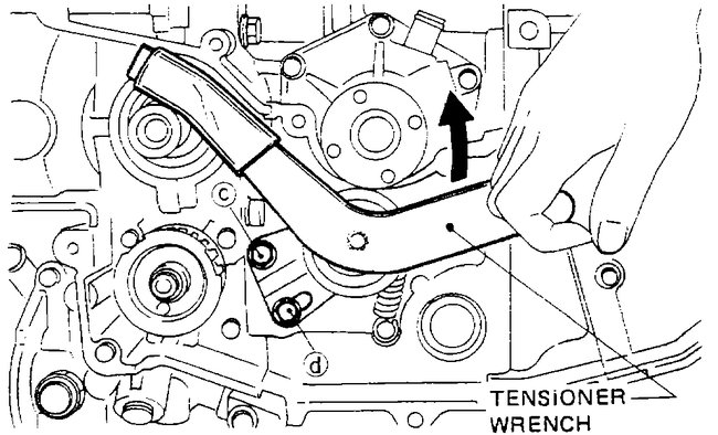

(c)Raise tensioner No. 2 using TENSIONER WRENCH (499007000) until it stops. then tighten bolt (D) temporarily.
NOTE: Cover the tip of tensioner wrench with a rubber hose or waste cloth to prevent crankshaft or pulley from being damaged.

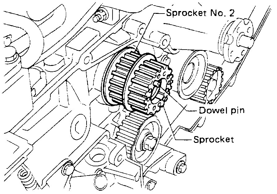

(a)Install sprocket No. 2 and sprocket to crankshaft.
NOTE: Sprocket No. 2 can be identified by the absence of dowel pin.

(c)Align the center of three lines scribed on the flywheel with timing mark on flywheel housing.

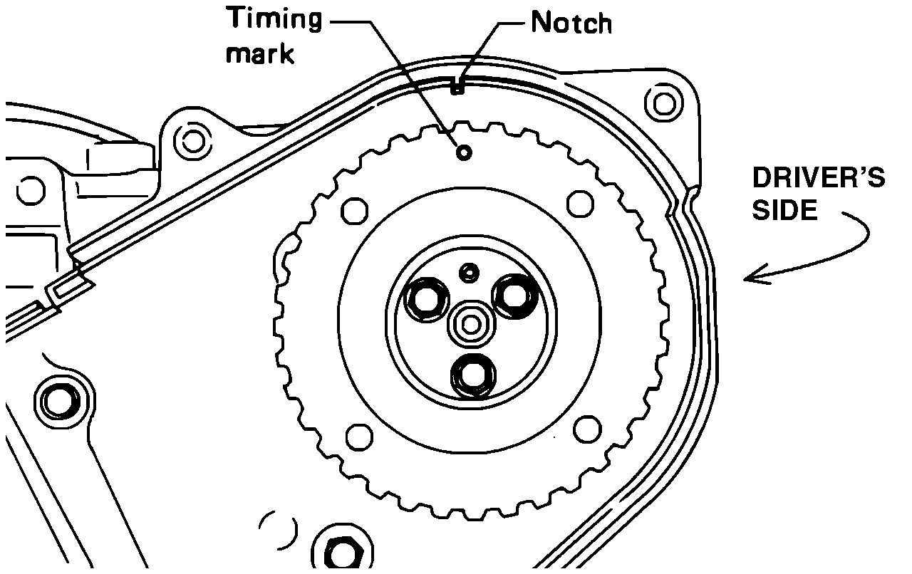

Camshaft Timing Marks, Left Side (DRIVER'S SIDE)
pic 16
(d)Align timing mark on camshaft sprocket LH with notch in belt cover.
pic 17
(e)Attach timing belt No. 2 to crankshaft sprocket No. 2, oil pump sprocket, belt idler, camshaft sprocket, in that order, avoiding downward slackening of the belt.
(6)Loosen tensioner No. 2 tightening bolt (D) by 1/2 turn to apply tension to belt.
pic 18
(f)Push timing belt by hand to ensure smooth movement of tensioner.

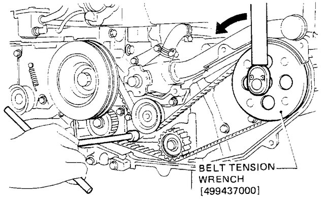

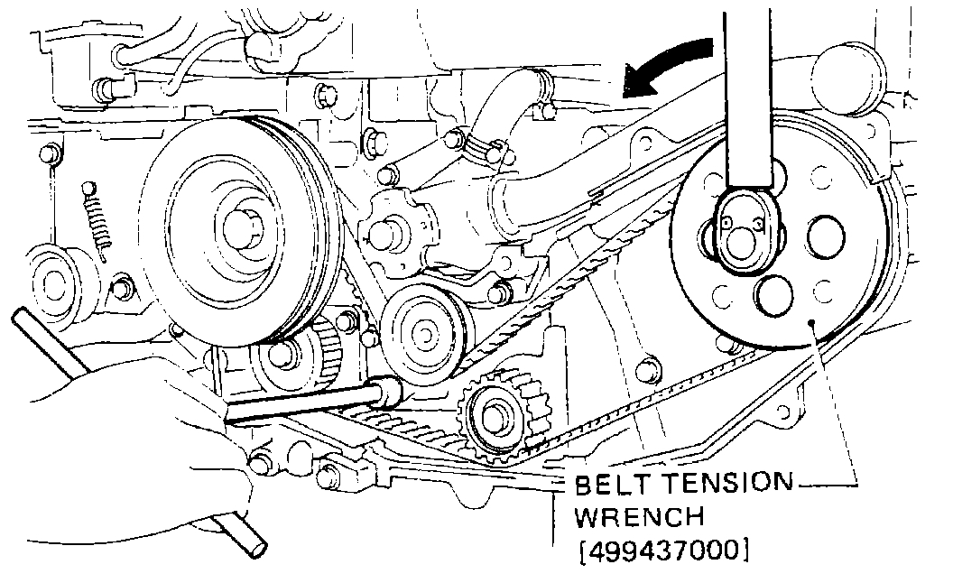

(g) Apply the specified torque to camshaft sprocket in counterclockwise direction using BELT TENSION WRENCH. While applying torque, tighten tensioner No. 2 bolt (D) temporarily, then tighten bolt (C) temporarily.
NOTE: When torquing sprocket, be extremely careful not to apply excessive force to it Excessive belt tension will greatly reduce belt life.
Belt Tension: 147 - 245 N-m (33 - 55 ft-lb)..
Torque to cam sprocket: 24 - 25 N-m (18 ft-lb).

(l)Attach timing belt to crankshaft sprocket and camshaft sprocket, avoiding slackening of belt on the upper side.
pic 21
(m)Loosen tensioner bolt (B) 1/2 turn to apply tension to belt.

(r)Remove crankshaft pulley.
NOTE: Do not remove sprocket with crankshaft pulley.

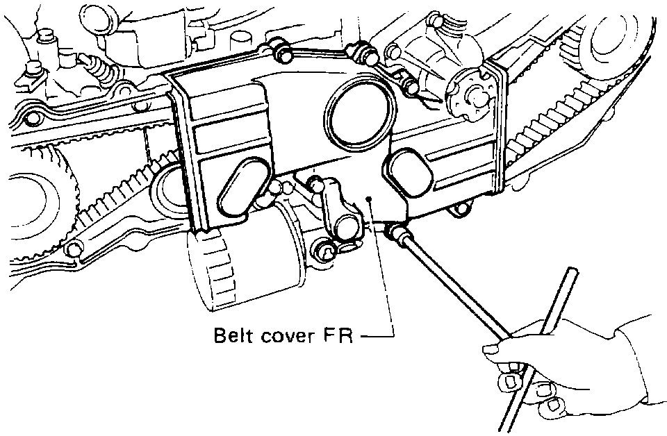

10. Install belt cover FR seal, belt cover RR seal, and belt cover plug to belt cover FR, then install belt cover FR to cylinder block.
NOTE: Before installing belt cover, ensure that no foreign matter such as nut or washer is in it.
11. Install belt covers LH and RH.
12. Install belt cover plate. TURBO model]
13. Install crank pulley to crankshaft using FLYWHEEL STOPPER (498277000) [manual transmission model] or DRIVE PLATE STOPPER (498497000) [automatic transmission model] to lock crankshaft.
Tightening torque:
89 - 107 N-m (9.1 - 10.9 kg-m, 66 - 79 ft-lb).
