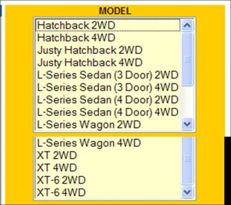

Hey, either jnovack or myself want to assist you but you still left off the model of the vehicle. I have attached the choices. Please let us know.
https://www.2carpros.com/forum/automotive_pictures/248015_Picture3_3.jpg
Sunday, November 16th, 2008 AT 8:52 PM
YORKSHIRE
  • 7 POSTS
IT is a 1988 Suburu 4WD GL10 5 door Station Wagon
VIN# JF2AN53B0JE428298
1800CC SPFI
Hope this is what you require. Roy

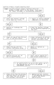

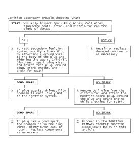

Here are 2 charts to test let me know what you get form tests but let me ask when a tuneup was done (new plugs ,wires,dist. cap,rotor)
https://www.2carpros.com/forum/automotive_pictures/52960_Graphic_2.jpg
https://www.2carpros.com/forum/automotive_pictures/52960_Graphic2_2.jpg
Friday, November 21st, 2008 AT 11:56 AM
YORKSHIRE
  • 7 POSTS
The pugs are new, The wires about a year same as cap and rotor.

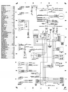

The thing is there is no power going to the distributor
whe wire seems to be from the firewall area. The test sheet you sent is to faint to read. Roy
Friday, November 21st, 2008 AT 1:17 PM
JNOVACK
  • 723 POSTS
Check ecm terminal 17 and 9 for voltage also check coil it suplies spark to dist. here is wiring diagram I also emailed the tests and wiring diagram to you for better seeing check your grounds to and from also fuse #11
