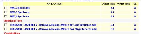

I wanted to know what the flat rate hours are listed for swapping out an automatic trans. in a 1991 Subaru Loyale 2WD?

Becareful with flat rate. This number is determine by a technicain doing the job 3 times consecutively on a NEW vehicle. The time is averaged out. Real time will be different on 17 year old car with other worn or seized parts. According to mitchell this is it:
https://images.2carpros.com/forum/automotive_pictures/30961_sub1q_1.jpg
