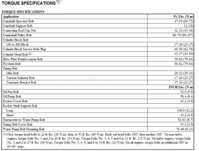

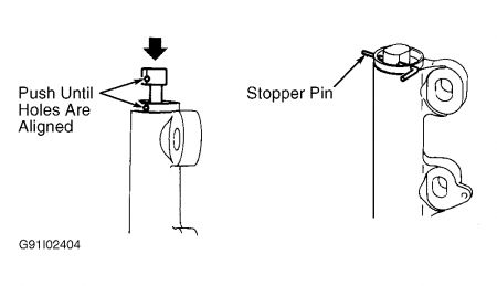

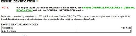

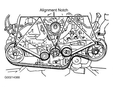

1990 Subaru Liberty GX I am a Mechanic doing up this vehicle for my daughter, please I need all relevent information on replacement of all Camshaft Seals, & Valve Timing procedures for 2200cc Engine. I need this information A.S.A.P. Thankyou so much. Nev.
Aug 30, 2008 at 2:28 PM
MHPAUTOS
  • 31,937 POSTS
HI there, Thank you for the donation, I dont have the Liberty on this data base but there is info for a 2.2 litre engine with Vin No id infomation for you to check, i hope that this is of help for you. When doing the cam seals use a small anount of sealand to the can caps as they tent to leak. Ther eshould be enough info to do the job. Mark (mhpautos)
