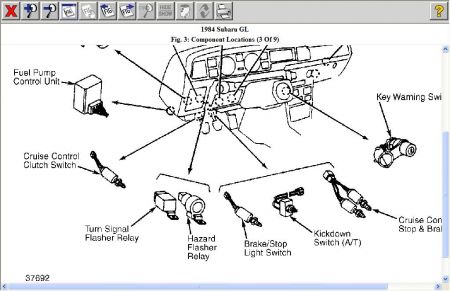

where is the turn signal flasher unit located on a 1984 Subaru 4 dr GL Automatic sedan

Hazard and turn signal Flashers are contained in a combination which is secured to the bulkhead under the instrument panel.
