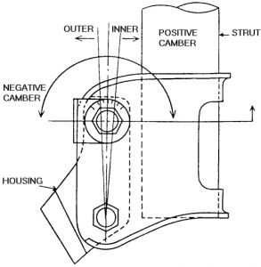

I would like to know how to adjust the Cambers on my Subaru. thanks James Hunt

Adjust the camber at the upper strut bolt, pictured belowl..
