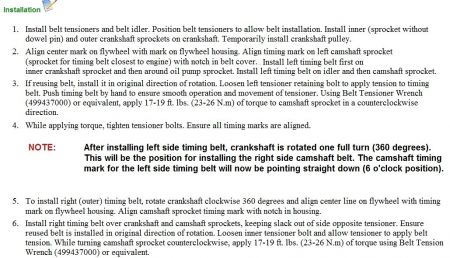

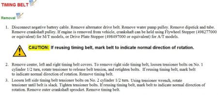

How do I change the timming belt on my car?
