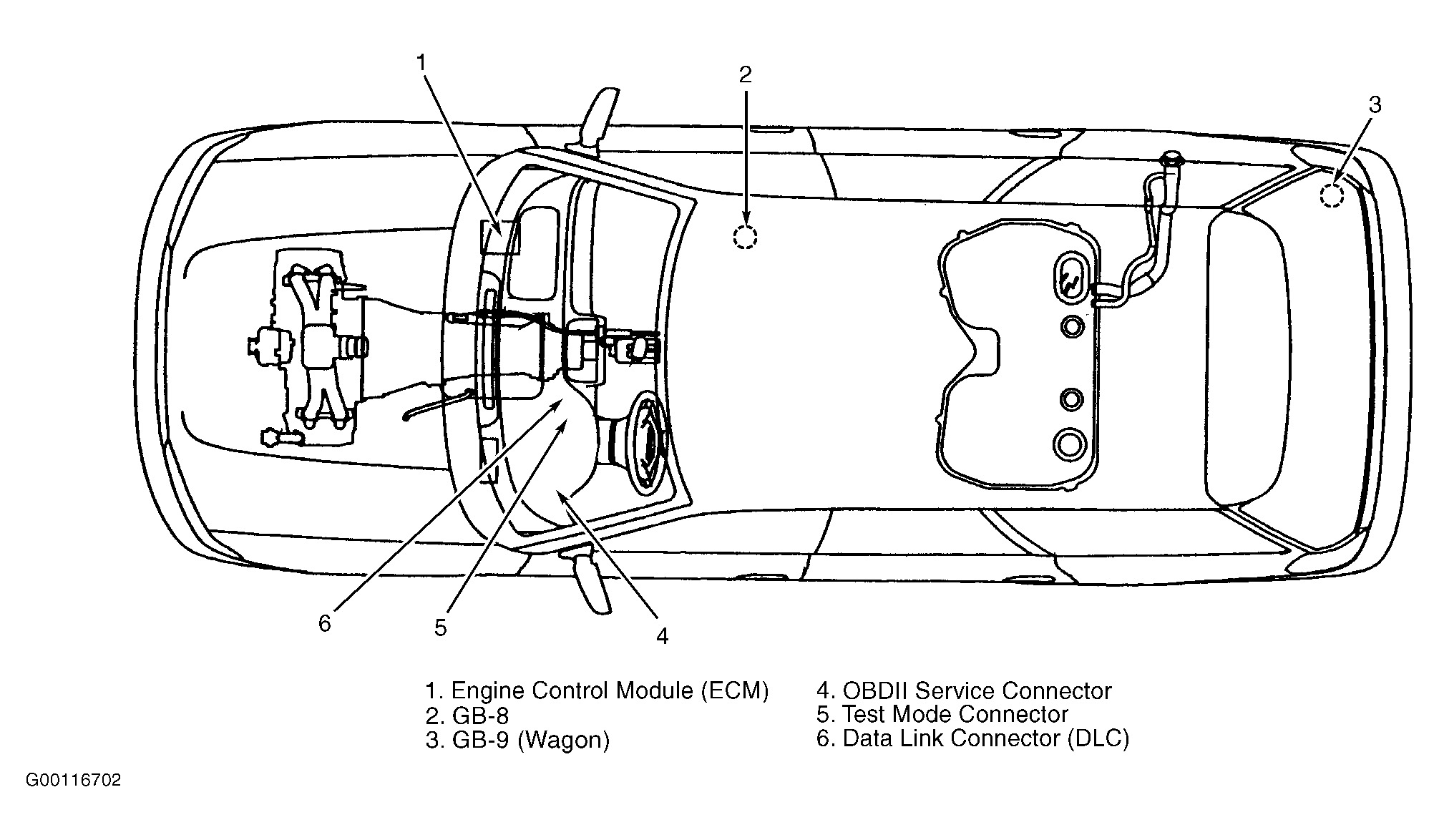

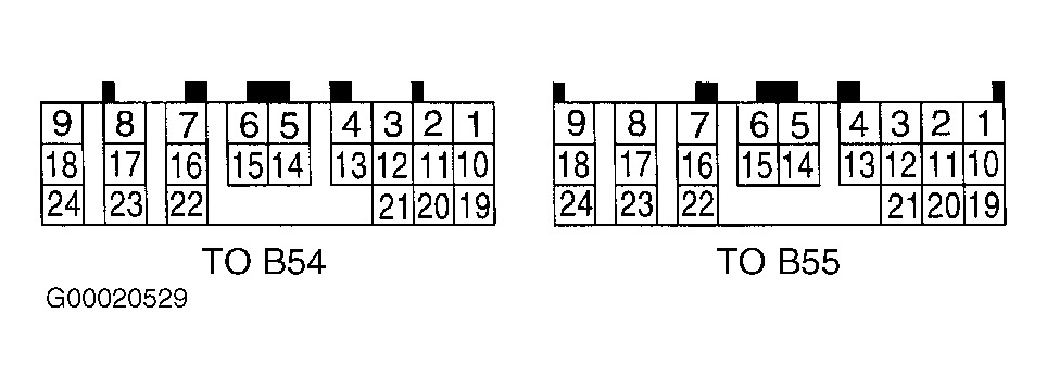

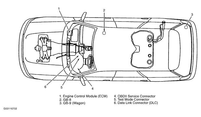

I just found out that the RX Impreza motor isn't the original it's been replaced. Can u tell me if/where I can find the engine ID number so I can be certain? I know it's definitely a EJ20 RX Impreza engine. I just got worried when I tried to swap the inlet manifolds over so I could use the best one but the RX Impreza's manifold has a smaller inner dimension and bolt holes are totally different. I'm guna try swapping over the Alternator + Power Steering Pully today and we see if they'll fit, they look very similar. Also is the ECU computer located up behind the glovebox? I do need to swap this as well because the connection plugs are different, the RX has 1x14 pin plug + 1x8pin plug + 1x6pin plug, while the Liberty has 2x14 pin plugs,do you know if there's an adaptor I can buy to save me changing to wiring harnesses that way I can just swap the ECU's. Also is it guna be to much of a mission to put engine and gearbox in while still bolted together? It was fairly easy to remove this way by lifting from the very front of engine, but as all mechanics know- things never go back together as easy as they come apart. Your feedback is very much appreciated.
Aug 26, 2015 at 12:51 PM
RIVERMIKERAT
  • 6,110 POSTS
The Liberty appears to be sold in the US as the Legacy, so I'm going to cross my fingers and send you what we've got. The first image is of the two ECU connectors for the Legacy.

The second attached image shows the control module location for the Legacy.
