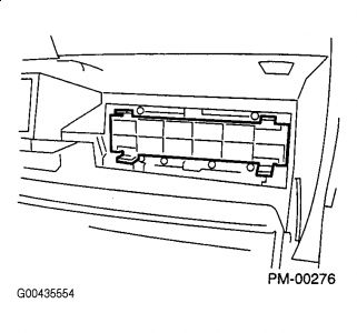

How do you replace the cabin airfilter in a 2006 Subrau Legacy? Where is it located as there is no drawing in the owners maunal.

Remove the instrument panel side cover Remove the glove box clip and damper ( string) Remove the screws and upper storage box Remove the screws to take out the bracket from the hole where the storage box was removed. Peel off Velcro tape attaching the insulator, and push up the insulator Remove the A/C filter Installation is reverse order
