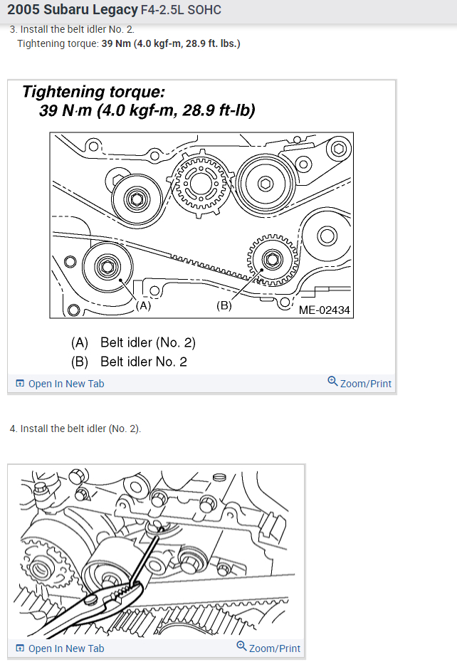

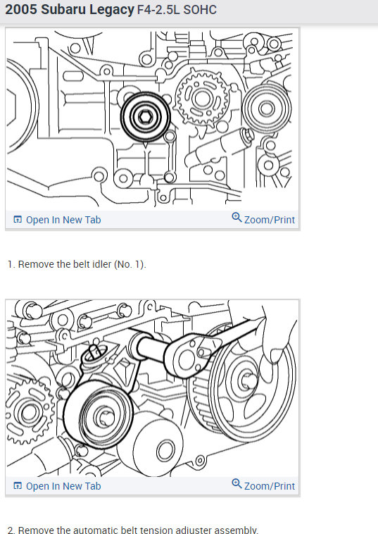

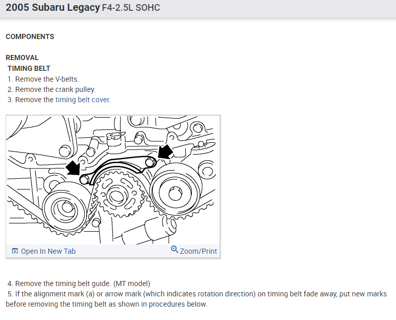

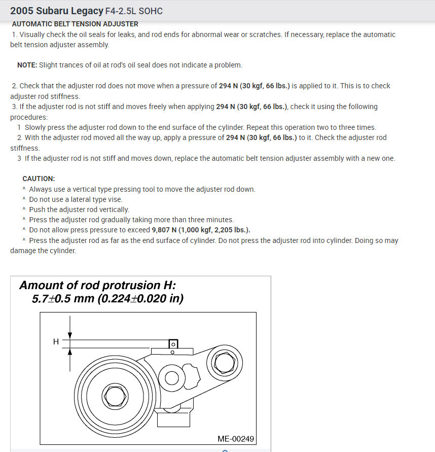

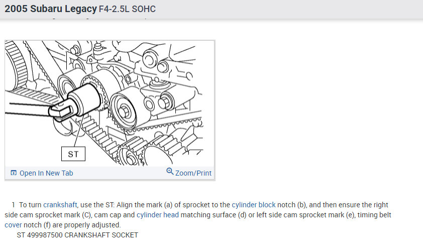

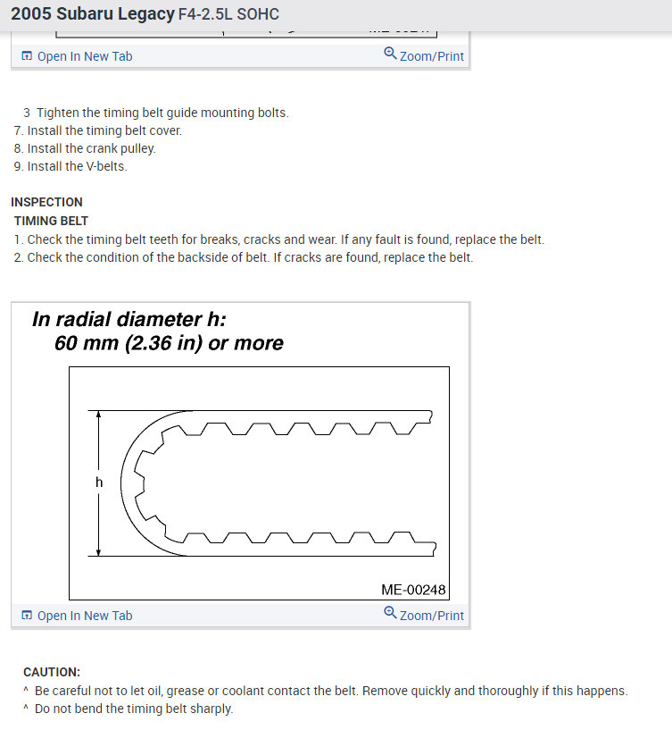

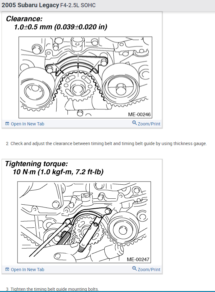

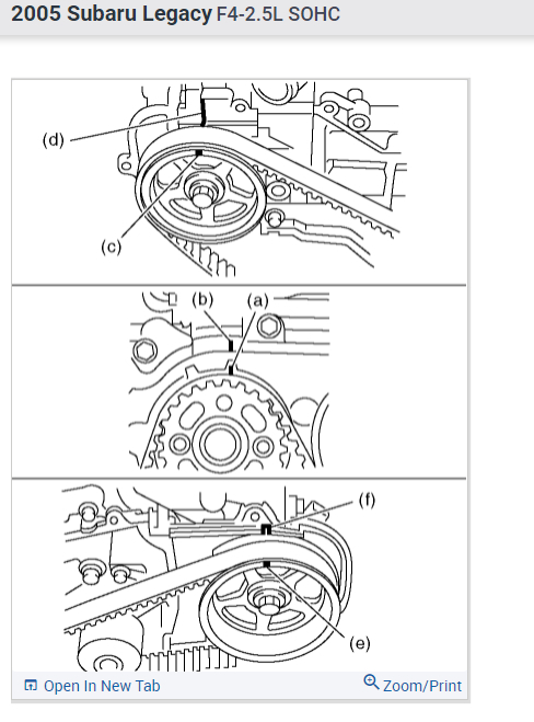

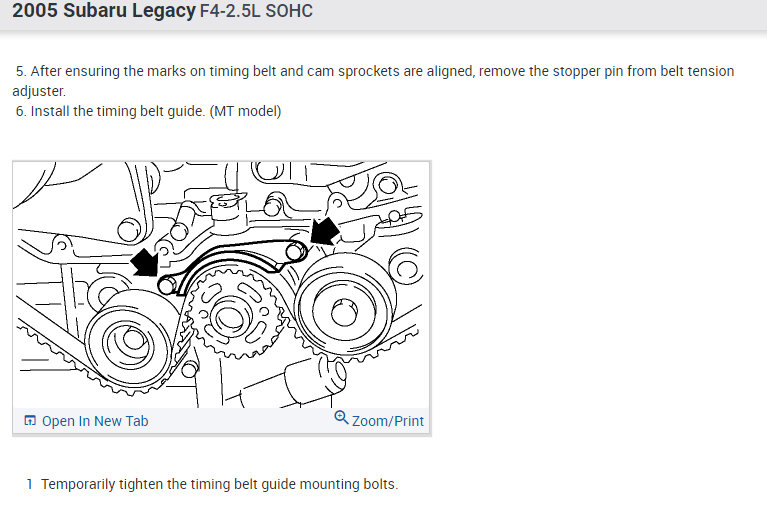

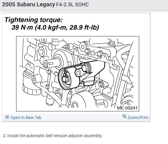

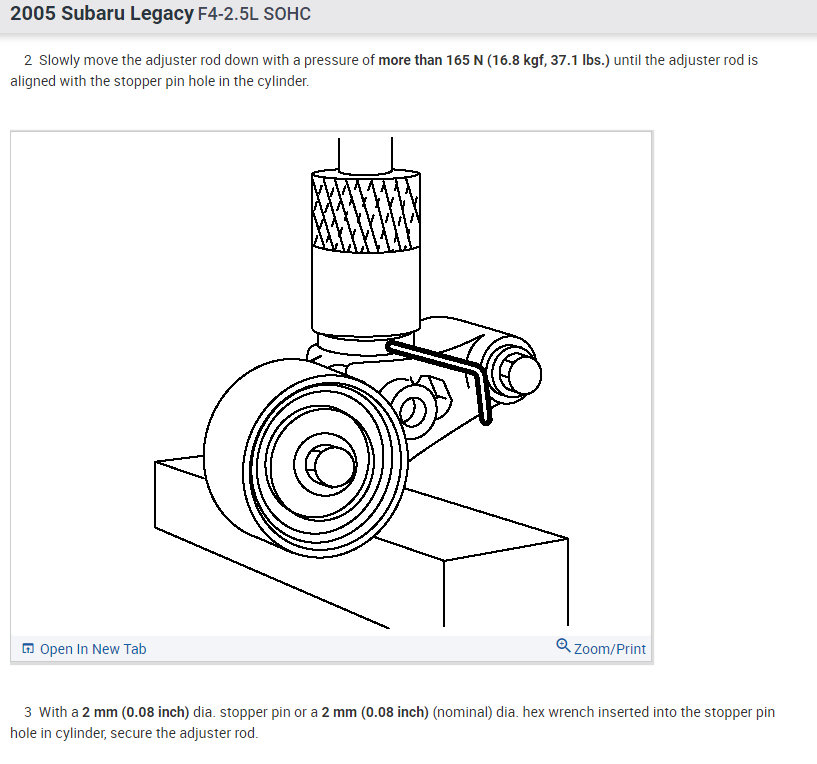

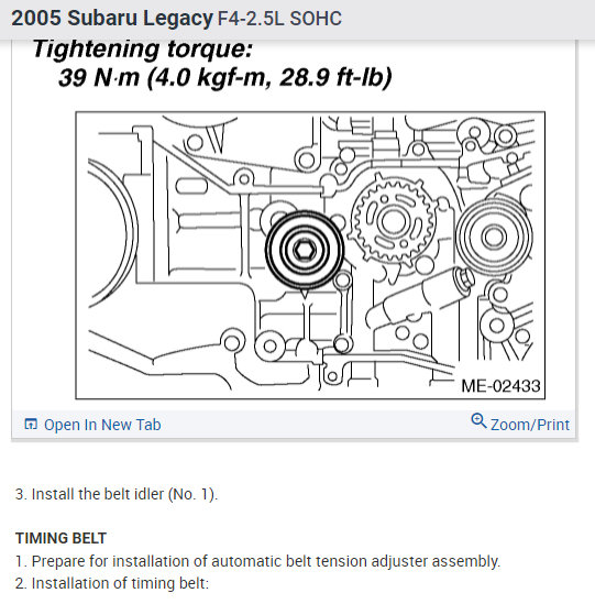

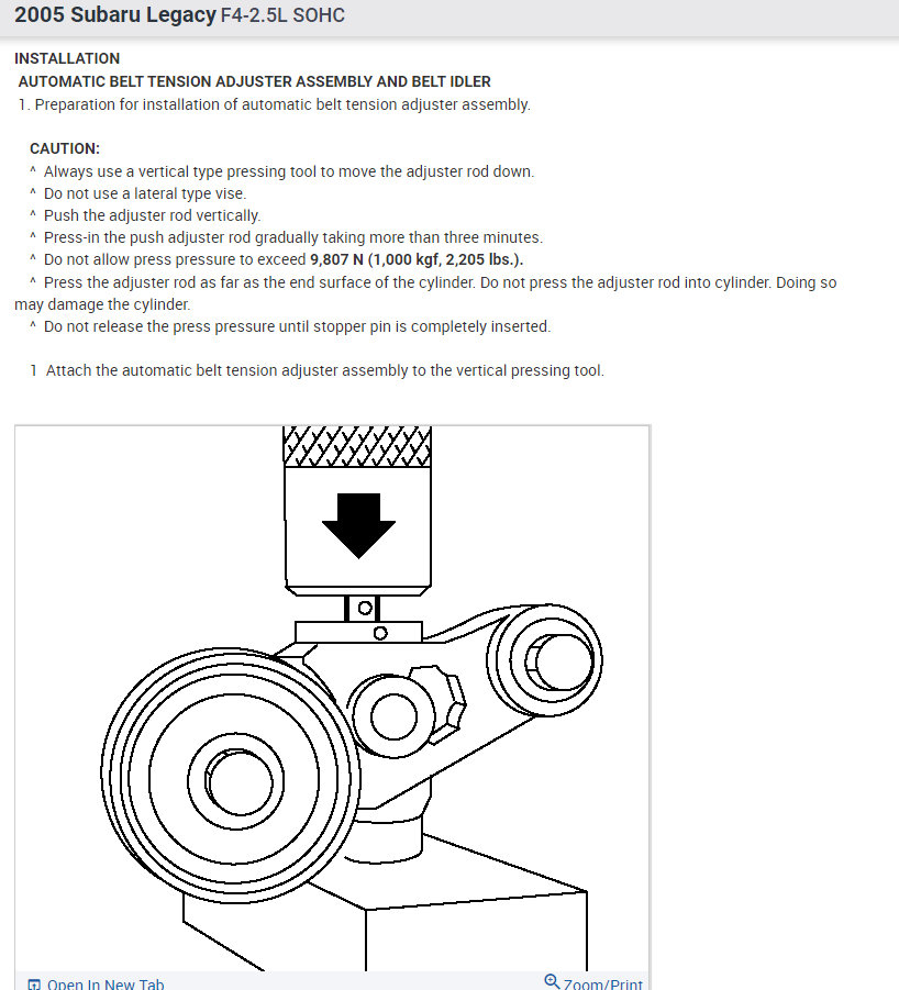

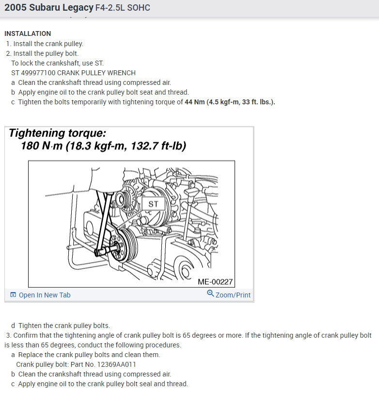

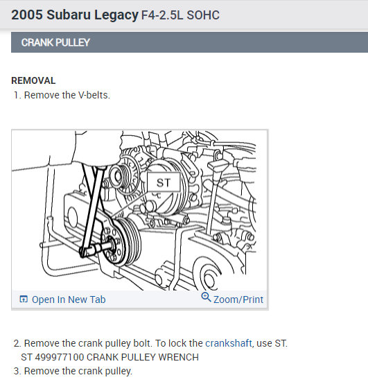

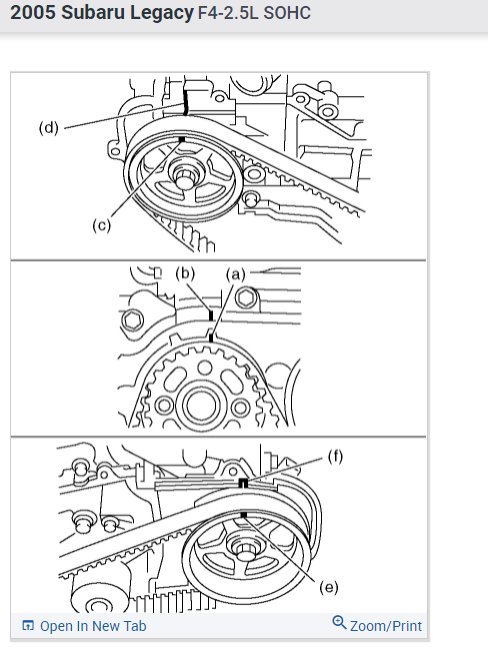

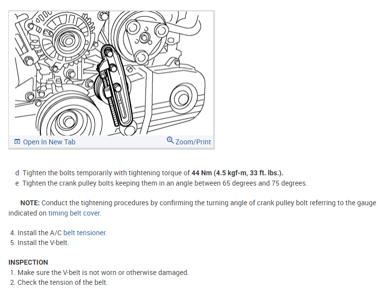

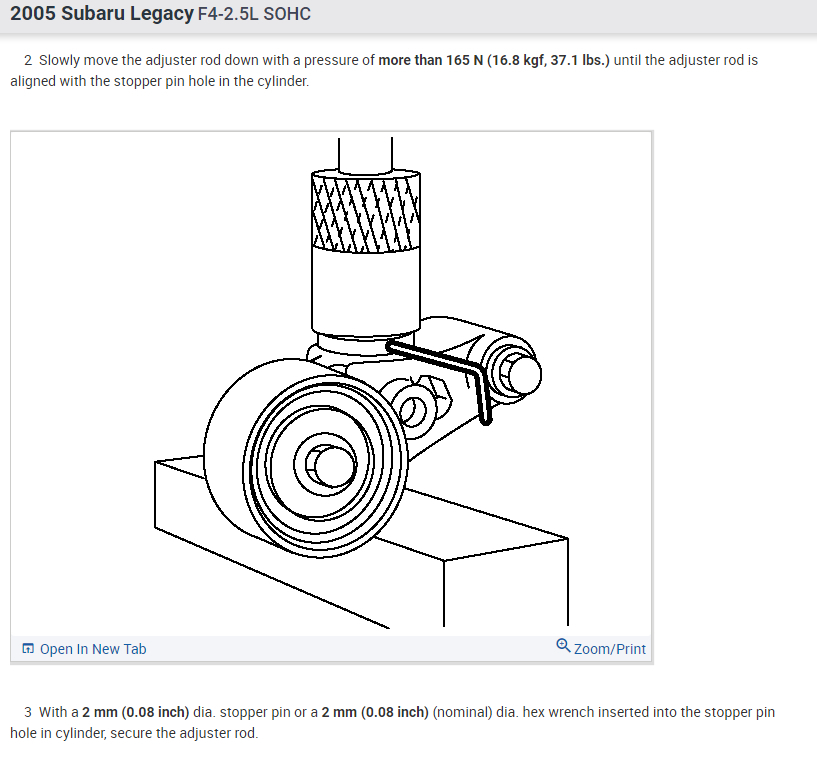

I am starting to replace the timing belt and all idlers and tensioner.
Wednesday, April 14th, 2010 AT 3:53 PM
SQM
MECHANIC
6,383 POSTS
I have attached the crankshaft pulley removal and installation procedure as well as timing belt replacement instructions below.
