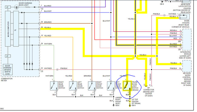

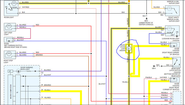

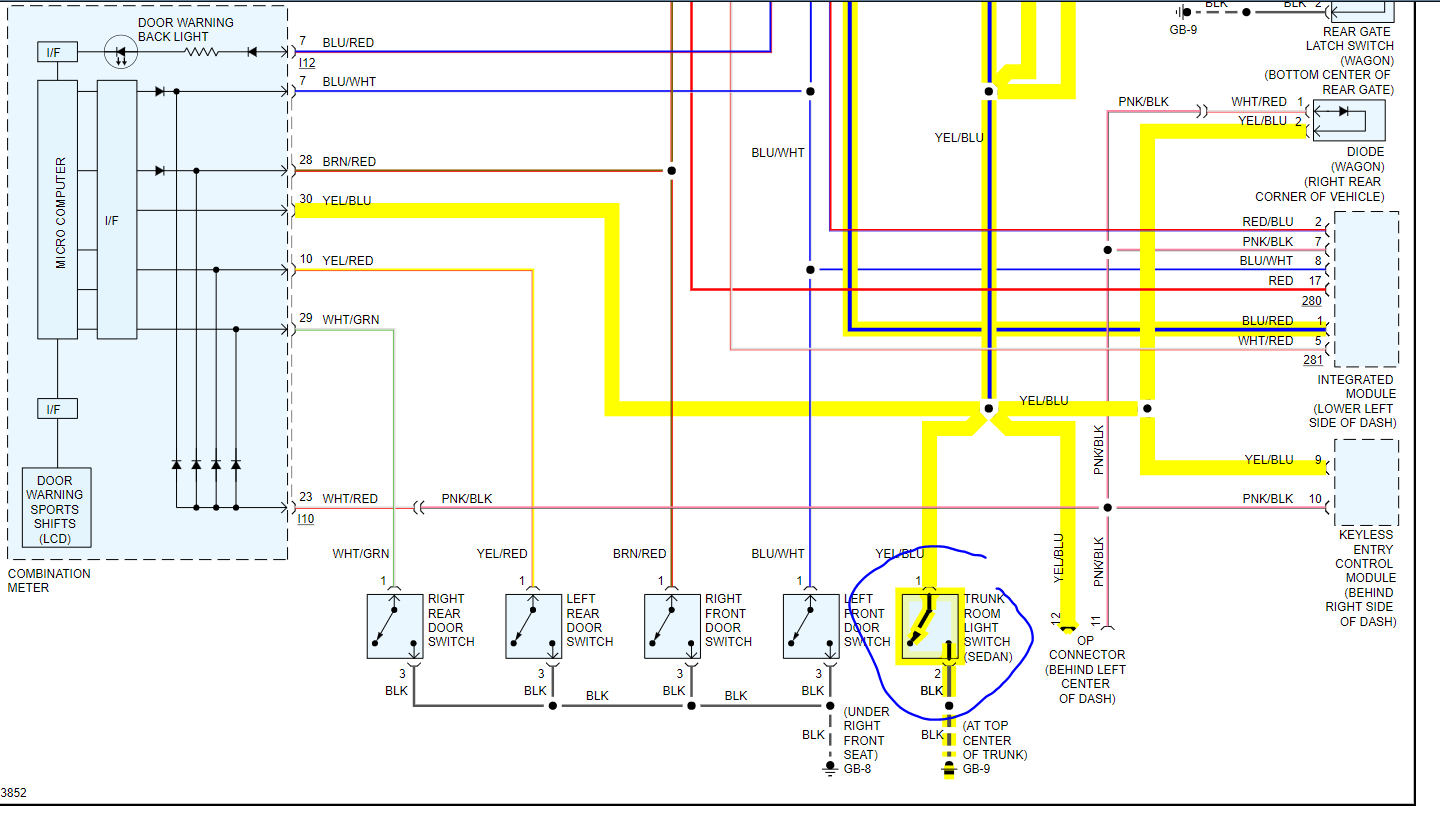

I have a trunk light that will not light. I have now voltage at the light socket. I can not find the switch that operates to turn on the light. I have checked all fuses. I am struck as to what to do?
Nov 2, 2008 at 11:23 AM
Good morning,

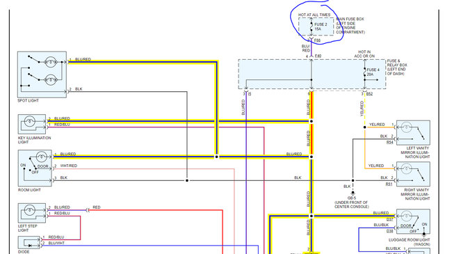

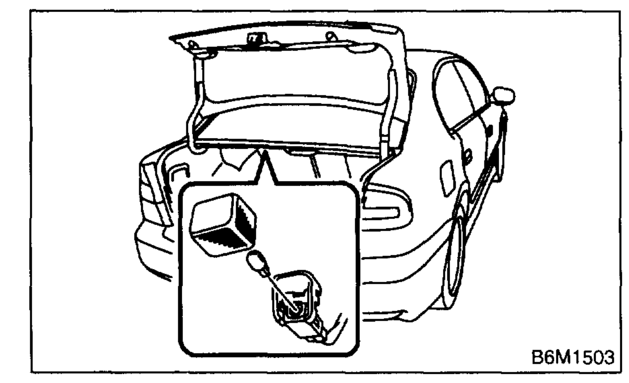

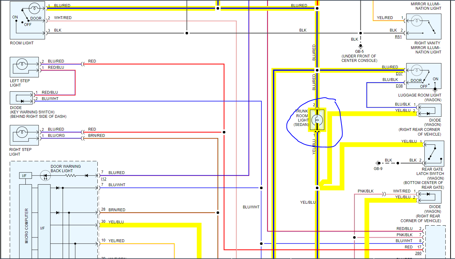

I attached a wiring diagram as well as the location for you in the trunk.
Check for power to the bulb. If it does not have power, it comes from the fuse I circled.
Trunk Room Light
REMOVAL
1. Disconnect ground cable from battery.
2. Disconnect harness connectors and remove trunk room light.
INSTALLATION
Install in the reverse order of removal.
