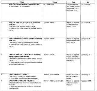

I am got a check engine light and when I had the code read it gave me P0732 which is gear 2 ratio however the person said he had never seen it before. If you could help me figure out what is wrong or who might know how I could fix it that would be great.

https://images.2carpros.com/forum/automotive_pictures/295662_105889612_1.jpg
hope this flow chart helps you out
